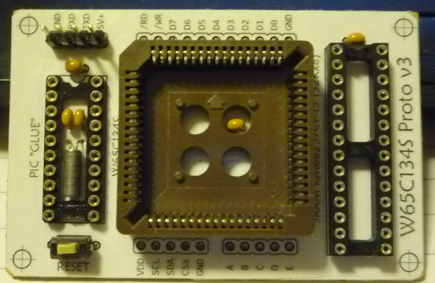

Andrew (BitWise),
Thank you for posting the schematic. Mine is similar but I tied NMIB (pin 54), IRQ1B (pin 55), and IRQ2B (pin 56) together and pulled them up to 5v with a single 10K resistor.
How did you get away with not using handshaking which is listed as a requirement in the W65C134S Monitor ROM Reference Manual;
This monitor expects a terminal (or computer emulator) to be connected to the serial port. The terminal must be configured as follows:
• Hardware handshaking.
• 8 bit data.
• No parity.
• 9600 Baud (Unless otherwise noted).
I'm working through the variables. My little CP2102 usb-to-serial adapter and the 12F1822 are working fine and I've verified my wiring. At this point I'm wondering if the W65C134S I have is faulty or is one of the "initial versions" mentioned in the manual which "do not support clock rates higher than the 2.4576 MHz crystal." I received the W65C134S8PL-8 as a sample in April, 1997. Anyway, I think I'll try to come up with a 2.4576 MHz clock and then perhaps wire up the 32K RAM socket.
Thanks again... Regards, Mike

Looks like my DSR pin P47 is floating at the moment, but it works for me. A wire link between your DTR and DSR pins might be needed.
My replacement monitor isn't going to have DTR/DSR handshaking as the PL2303 doesn't support it and its all software generated in the WDC code.
Found the bug in my UART driver so the random output data has gone - After much mental code simulation I realised that my zero terminated test data string was not zero terminated - and serial input is working (I can read and echo characters from a terminal program).
Now I can crack on with the serious coding.
