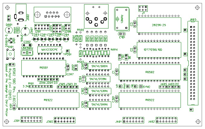

Guys --
I'm in the process of validating an updated version of Daryl's SBC2 that I re-drew in DipTrace. I've done a 4-board prototype run because I've made a bunch of random changes to the design to enhance it a bit. Functionally, it's the same, but I did the following: added a power jack, RS232 DE9 for the console, bypass capacitors, a reset switch, a power LED and I added a Commodore-compatible IEC interface (which takes up a lot of board real estate). The board size changed to Eurocard+ (6.325" x 4") from the current size. As a trade-off, I removed the 7805 regulator and made it a 5v only board. The picture I attached is of the prototype...in the final version I shifted the power jack and compressed the board a bit.
I have some changes to EhBASIC 2.22 in order to support the IEC interface...that's what I'm working on now. Hopefully in a few weeks I can finalize the design and code and make it available. There are a few good board shops that we use in the N8VEM project that I'm going to try. For the prototypes, I used AP Circuits' $33 each service. In low production volumes, the boards are kind of expensive. I expect that the other board service will be much cheaper.
There is a description of the board on my Web site: http://www.classiccmp.org/cini/6502proj.htm
File comment: Silkscreen of SBC

Interesting project. I like your modifications to the board. Please keep us posted because I would be interested in buying a pcb or kit if you ever make one available.

I'm in the process of validating an updated version of Daryl's SBC2 that I re-drew in DipTrace...
Interesting.
You could further shrink the board by using PLCC44 packages with the 65C02 and 65C22. On average, such packages use about 60 percent of the boar real estate consumed by the PDIP equivalents.
True. The N8VEM group I belong to uses the ECB format for all of their cards (100mm x 160mm), so that's what I'm familiar with and I was able to get it close with PDIP chips (I'm off by about 0.32" on the length). I did not change the ordering of the expansion buss pinout from Daryl's design.
I can tell you that I carry mostly PDIP devices in my parts bins in my shop rather than PLCC. I'm sure it would be easy, other than creating custom library parts, to make a version of the board using PLCC devices for all four 65xx chips. I wanted to keep it simple by using PDIP parts that people would more likely have in their parts bins.
Let me make the library parts for DipTrace and see what a PLCC board would look like. Thanks for the suggestion.

All --
Latest board plot is attached. I added a 2x3 header for an SD2IEC device and removed the barrel-style power connector in favor of a USB Mini-B. I moved some things around but have kept it to 6.375" x 4". I'm still working on a PLCC version but DipTrace doesn't have a 44-pin PGA socket footprint -- only SMD.
The Serial IEC works fine and now I'm working on building Commodore BASIC 4.0 disk commands into BASIC itself. I've got STAT and CATALOG done. The others will be more difficult since they have string parameters.
More to come!
