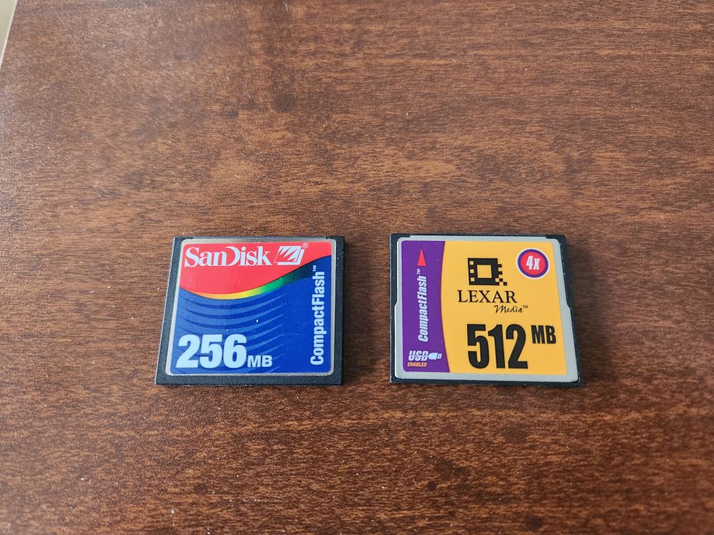

Could you tell me which brand of CF you are using for 29.5MHz? I'm looking for a second source to the 256MB SanDisk which I'm running out. If 29.5MHz is too close to edge, you can try slightly slower clock like 28.8MHz or 28.6363MHz; the serial port can tolerate 3-4% of frequency deviation.

PostPosted: Fri Nov 04, 2022 6:38 pm
Posts: 104
Location: Kelowna Canada
Hi Bill
I am using a Sandisk as shown in the picture. I would like to use the Lexar 512MB but it is too fast for the CRC. It seems to be ready before I can do a serial boot and even if I flash DOS/65 to it, I get nothing in the terminal window.
The strange thing about the Sandisk 256 is that it has worked at 29.5Mhz for other CRC things but it seems to mostly work for DOS/65 except when doing an extended copy or read but that might just indicate it is close to the edge.
I will try the newer version that you attached and check out that.
Larry

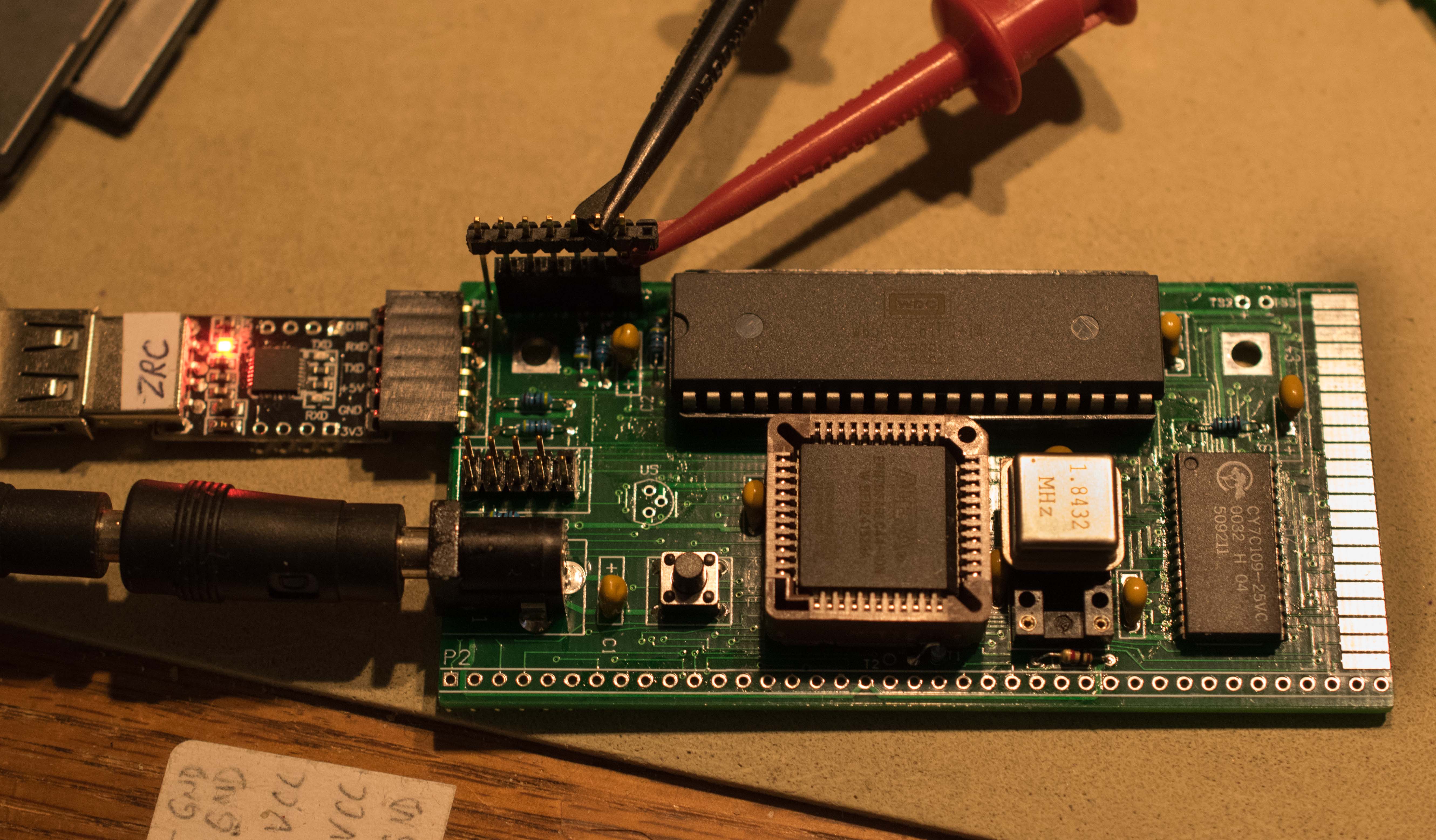

PostPosted: Sun Nov 27, 2022 2:45 pm
Posts: 1119
I was rather shocked by how low voltage-wise can W65C02 operate on this test, so I want to repeat the test with CRC65 which can operates with bare minimum of 6502, RAM, CPLD, and oscillator. Without the compact flash bootstrap, the programs must be serially loaded after every reset which involves a serial loader, monitor, and the memory diagnostic programs so is a pretty good suit of tests. The test is to find voltage limit for different W65C02 operating frequencies. Parts are:
W65C02S6TPG-14
CY7C109-25VC
EPM7064SLC44
Can oscillator
Attached is photo of CRC65 under test.
CPU frequency   serial bps   voltage just above memory failure      current consumption
29.4912MHz            230400      5.0V                             160mA
22MHz                  115200     3.3V                             70mA
14.7456MHz            115200      2.7V                              39mA
7.3728MHz           57600      2.15V                                20mA
1.8432MHz           14400      2.1V                                16mA
The operating voltage for each frequency is just above the point when memory diagnostic failed (displaying a memory failure message), except the last entry (1.84MHz @2.1V) where the program just quit without a failure message. Since multiple programs were successfully loaded and ran and memory test failure was the point of failure, 6502 is operating until memory access became too slow to support proper operation. This could be a combination of slowing RAM, CPLD, or 6502. The last case at 2.1V is disorderly systematic failure of unknown cause.
11/28/22 edit, added another entry that 22MHz is the maximum CPU frequency with supply voltage of 3.3V. CPLD design was altered slightly to divide the clock by 12 in order to generate 115200 serial clock with 22MHz.

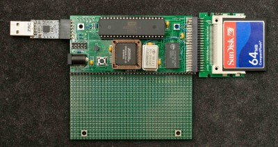

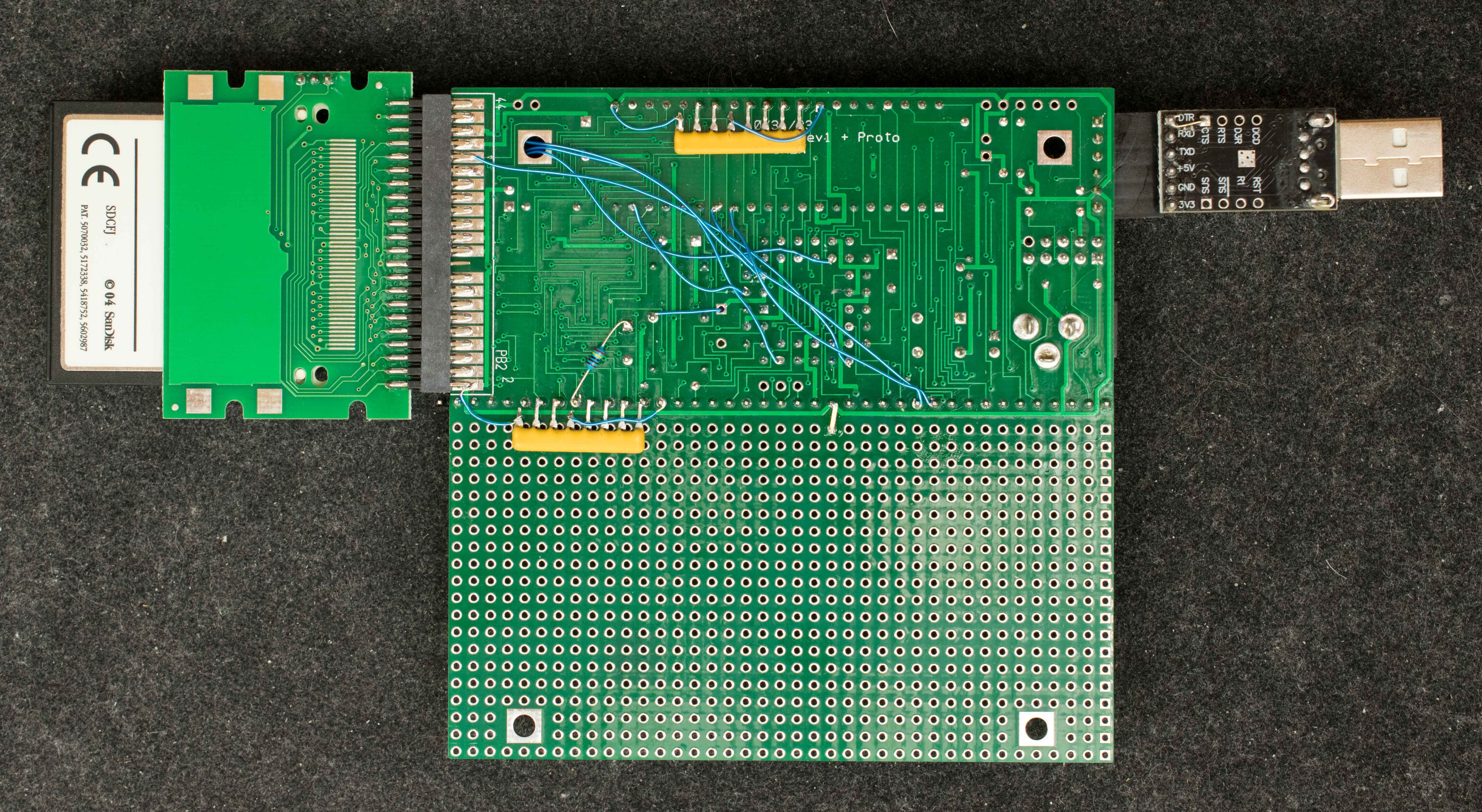

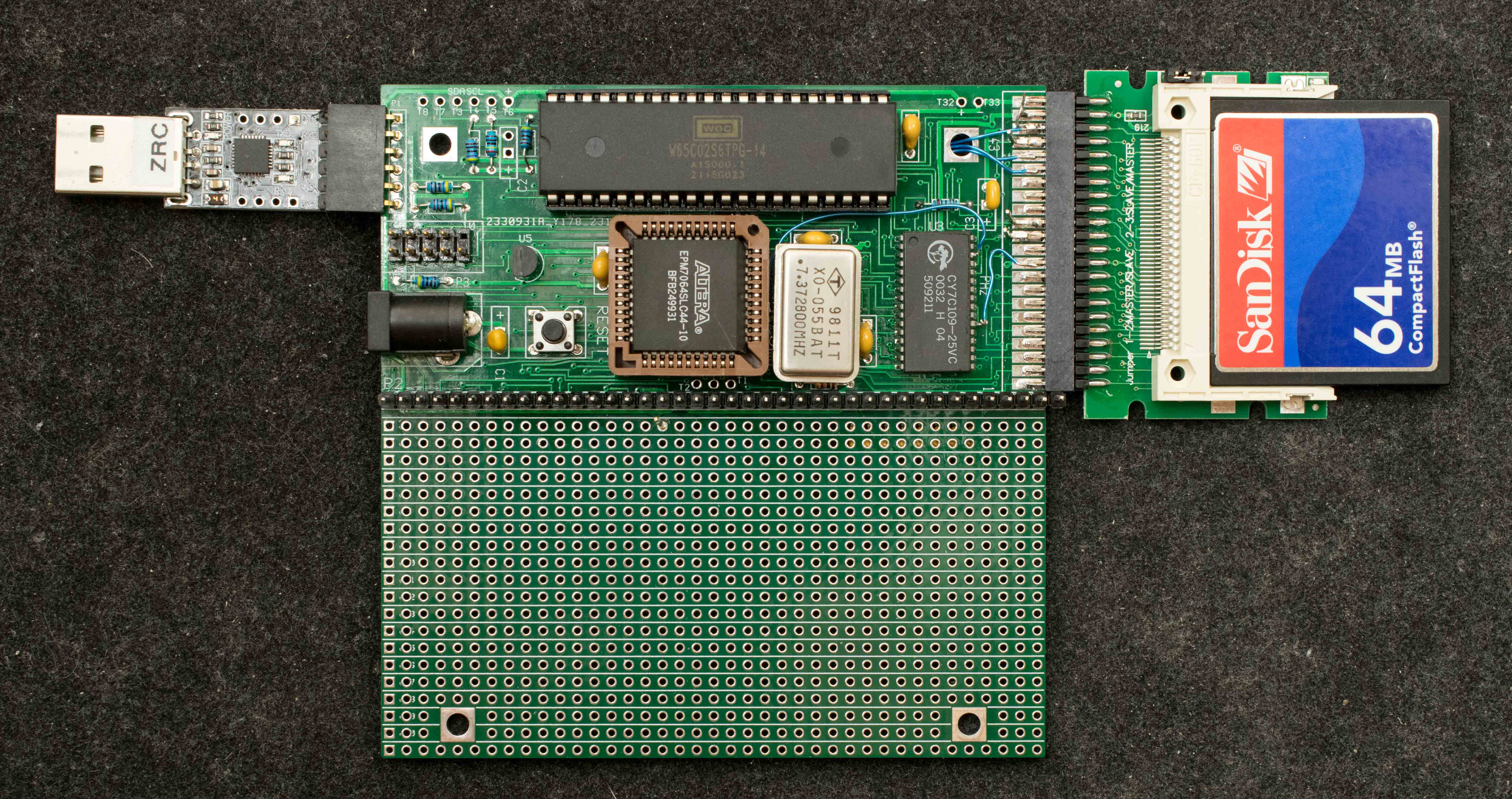

PostPosted: Sun Nov 12, 2023 4:33 am
Posts: 1119
I decided to add a prototype area to the original CRC65 to make it a 4"x4" pc board. The pc board costs the same, but now I'll have an area for experiments. The first experiment is blind booting via compact flash. First I'll prototype with CPLD because it is easy to change the circuitry. Once it worked in CPLD, I'll build another board that replaces the CPLD with discrete logic on the prototype area.
Here is CF blind boot implemented in CPLD. The CPLD contains two blocks, serial port, and CF blind boot state machine. A 74138 decoder places serial port at $8000-$83FF, CF interface at $8400-$87FF and RAM everywhere else (0-$7FFF, $8800-$FFFF).
I'll skip over the serial port. The CF blind boot state machine is in control immediately after reset. It reads the CF status register ($8407) continuously checking for data[7]=0 & data[6]=1 (Not Busy condition). Once "Not Busy" flip flop is set, it writes the command byte 0x20 to CF command register ($8407) which reads Master Boot Record into 256x16 data FIFO. I should mention that data bus is pulled up/down to value of 0x20 with 2.2K resistors so the write operations will write the data bus value of 0x20 to CF command register. After writing the command, the blind boot state machine continuously reads the CF status register looking for Data_Ready at data[3]. Once the Data_Ready flip flop is set, it is show time!
In the CF data register ($8400) is a FIFO with 256 words (the contents of Master Boot Record) queued up. Every CF read strobe will clock out a word. Previously 6502 was held in wait state with RDY negated until Data_Ready flip flop is set. At that point, RDY is asserted (high) and every 6502 reads in address space $8000-$FFFF will strobe the CF read line. So 6502 is executing the 256 opcode streaming out of the FIFO queue when it is reading in memory space $8000-$FFFF. When accessing $0-$7FFF, 6502 is accessing RAM. Given 6502 is executing instructions from FIFO in high memory and accessing RAM in low memory, FIFO contents are series of "load instruction from CF and store in RAM" and the last 3 bytes of FIFO queue are jump to RAM. At the end of FIFO reads, 6502 starts executing the program loaded in RAM.
When CF's FIFO is empty, the DASP signal negates; the blind boot state machine monitors DASP signal and relinquishes the CF interface back to 6502 at the negation of DASP signal.
Next post I'll describe the bootstrap program in Master Boot Record and how I created it.
