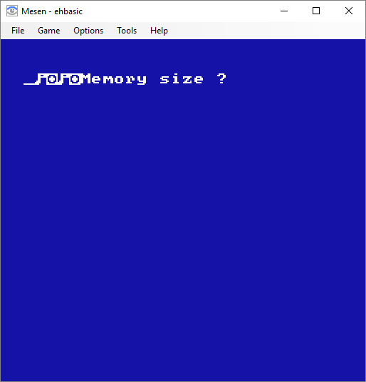

So I'm porting EhBasic to the NES and was contemplating getting a commercial license. Sadly, since Lee has died, I was wondering how would you handle the copyright status as this is now officially an orphaned work?
If anything here's at least a screenshot of progress...
I still have to write handlers for Tab, LF, and CR... Oh and the input system too.
I was thinking of making a "Basic compiler" for the NES where you could program in EhBasic and then a NES ROM image is created with the Basic acting as a kernal and your program saved in ROM. (Leaving all 8k of ram for variables) There is a stipulation for commercial licensing for EhBasic, but well, it's difficult to ask now :/
Ideas?
