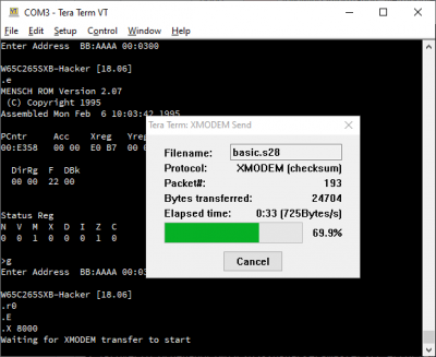

I'm having a problem that is, that the XMODEM transfer is VERY slow.
UPDATE:
I was using the original "dual UART" '256SXB hacker option, and then went back to the "single UART" as provided in the download.
Now the XMODEM transfer does work, but stops just before reaching 70%.

You have to load a binary file into the ROM with XMODEM not an S28.
Ouch! It's true!! The second test I made it by uploading the .s28 instead of the .bin.
I wonder why the XMODEM didn't work in the second UART but does it (and nothing to do with my wrong upload) with the first.
Now it works!! Thanks!! I have a question for you about the "hacker", but won't go off-topic and will open a different thread.
