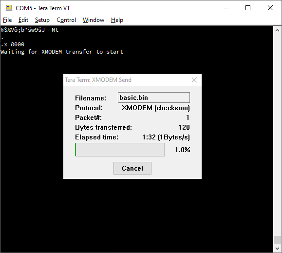

Hi. I'd like to know what exactly should I do to compile this 65816 compliant EhBASIC version, to run it in my W65C265SXB clone.
I've read that there are several changes made, and at one point it was available for download, but now it's only the source code linked above, and I don't know if the changes are already applied, or if I should apply the changes listeed in changelog.log.
Thanks.

Thanks. I'm trying several TASS versions and my results are that I could only compile the source "as is" with 64tass1.46-r38, and leaving out basldsv.asm, because of errors:
WITH .include basldsv.asm
S:\Proyecto Ordenador\EhBASIC>..\64tass-1.46-r38\64tass_1.46_r38.exe -x -W basic222.asm -o ehbasic.out
6502/65C02 Turbo Assembler Version 1.3  Copyright (c) 1997 Taboo Productions
6502/65C02 Turbo Assembler Version 1.35 ANSI C port by [BiGFooT/BReeZe^2000]
6502/65C02/65816/CPU64/DTV TASM Version 1.46 r38 Fixing by Soci/Singular 2001-2010
64TASS comes with ABSOLUTELY NO WARRANTY; This is free software, and you
are welcome to redistribute it under certain conditions; See LICENSE!
Assembling file:   basic222.asm
basldsv.asm:13: (basic222.asm:22) Not defined print2byte "jsr print2byte"
basldsv.asm:17592186044430: (basic222.asm:17592186044438) Not defined print_cr "jsr print_cr"
basldsv.asm:17592186044437: (basic222.asm:17592186044438) Not defined print2byte "jsr print2byte"
basldsv.asm:17592186044438: (basic222.asm:17592186044438) Not defined print_cr "jsr print_cr"
Error messages:    4
Warning messages:  None
Passes:            2
Range:             $000000-$00001c
WITHOUT .include basldsv.asm
Error messages:    None
Passes:            2
Range:             $009000-$00b840
As this version of TASS only output one format (that I can't figure which is), I used utils from s-record.com, to convert the output binary file to a "s-record" that I will be able to push through internal Mensch monitor:
S:\Proyecto Ordenador\EhBASIC>..\bin2srec.exe ehbasic.out > ehbasic.s28
BIN2SREC 1.51 - Convert binary to Motorola S-Record file.
Copyright (c) 2000-2019 Ant Goffart - http://www.s-record.com/
Input binary file: ehbasic.out
Begin address   = 0h
End address     = 2842h
Address offset  = 0h
Maximum address = 2842h
Address bytes   = 2
Processing complete
I'm not actually sure if the ehbasic.out that I got earlier is the right one to be converted to "s-record" type. Also, the addresses mentioned in both TASS output and the previous output don't seem right to me. Should I add -b 0300 like this?? :
S:\Proyecto Ordenador\EhBASIC>..\bin2srec.exe -b 0300 ehbasic.out > ehbasic.s28
Begin address   = 300h
End address     = 2842h
Address offset  = 300h
Address bytes   = 2
Processing complete
Thanks for your help.

I had some free time this afternoon:
https://github.com/andrew-jacobs/w65c265sxb-ehbasic
Andrew Jacobs

I'm having a problem that is, that the XMODEM transfer is VERY slow.
The garbage you see in the first line is that this COM port was using 9600 and then changed it to 19200.
Tinkering with the '265 hacker does actually works, but the XMODEM transfer stays like the picture for a while and then gets interrupted...
I'm using another FTDI chip for the second UART. Maybe changing to a prolific 2303...
