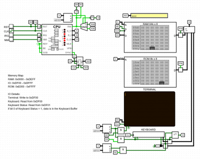

yes i'm sorry, lets just get this straight.
this right here is the whole circuit.
it also has the Memory Map and IO Devices explained in the bottom left.
some more detail about the 2 IO Devices, the Terminal and Keyboard.
The Terminal is located at 0xDF00 and when writing to it it simply takes the byte (hopefully ASCII) and puts it on the screen from left to right.
it accepts special characters like Backspace, LF (Line Feed) and CR (Carriage Return), though sending both will make it go down 2 rows. so it's recommended go with just either and not both. sincet he Keyboard uses LF it's best to also just use a single LF character. it's in line with most Terminal software as well (if you use this on an actual 65C02 and use a Serial connection i mean)
also it's Amber colored because if you got a Monochrome display you might as well make it the best possible color!
The Keyboard is also rather simple, it's located at 0xDF00 as well and reading from it will just put the an ASCII character from the Buffer into the CPU and remove it from the Buffer, it also handles special characters like Backspace, or Return (which always turns into a single LF character like most Linux and UNIX systems).
0xDF01 is just connected to the "available" pin on the keyboard, which just indicates that anything was typed into it.
the actual Memory map and locations of the IO Devices depend on the 16 bit constants you can see on the screenshot. so it's completely arbitrary and i can change it to whatever is needed.
the current setup you see is identical in function to my 65C02 SBC.

again sorry for being vague with everything. i hope the explaination above shows a bit more how the system works.
now, i need to know how to exactly assemble this. the ROM will end at 0xFFFF and start at whatever is needed to fit all of BASIC and the IO Functions.
so what should go into the .BAT file for this?
or is there another step i'm missing here?

Regarding WDC Tools running in a Win7 VM... not sure what you mean by slow... the Enhanced Basic code assembles and links in under 2 seconds on my Win7 VM. I would question anything that takes over 4-5 seconds, but I don't know any details on your VM environment.
The 65C02 environment you're running this on: Okay, that tends to make some sense now. You basically have a single address acting as an I/O port for read and write. To use this for anything useful, you'll need to write a couple simple routines. One routine will simply take the contents of the A reg (accumulator) and write it to the I/O port, then return. The other routine would need to load the keyboard status port, check for bit 0 and then either set or clear the carry flag and optionally load the A reg with the character from the I/O port, then return.
For the B_CHROUT routine it might look like:
        STA    $DF00    ;Send the character to the terminal
        RTS             ;Return
For the B_CHRIN_NW routine it might look like:
         LDA    $DF01    ;Get keyboard status
         LSR    A        ;Shift into the Carry flag
         BCC    EXIT     ;If clear, just exit
         LDA    $DF00    ;Else, get the character from the keyboard
EXIT     RTS             ;Return
The assembled/linked code is about 9KB, so your memory map should probably change to accommodate the required space. It's possible to run the code from RAM, but if something goes wrong, the code could get overwritten. You also need to define the processor startup vector to a routine that initializes the system before jumping to the start of the Basic code. The init would include setting the stack, possibly clearing decimal mode, zeroing out some variables perhaps, etc.
As for what to put in a batch file... you should reference the assembler and linker documentation. I still use TIDE to kick all of that off. Granted, it's on the buggy side, but I have a .WDC file that contains the parameters for TIDE to assemble and link the code and outputs a listing file, object file and a S-record (S19) file for the code I either load into my EEPROM burner or can download to my SBC using Xmodem-CRC.
i meant that my Windows 7 VM is slow, not WDCTools.
        RTS             ;Return
EXIT     RTS             ;Return
thank you but i did already write some functions, on page 2 in this thread near the middle.
though i used a BIT instruction instead of just shifting bit 0 into the Carry. that's clever.
yea i'll just expand the ROM to 16kB from 0xC000 to 0xFFFF.
for the startup code my idea was that i could just have a second ASM file that gets assembled together with the BASIC code into a single 16k large .BIN file.
would that work?
I never worked with this before and i'm having quite a hard time getting this working.
i tried looking into the command line parameters via the manual from WDC but didn't get really far.
also how should BASIC + startup code fit into 16k (ie 0xC000 to 0xFFFF) when BASIC is said to start at 0xB000?
i changed that .ORG to be 0xC000 and at the start also changed the end of User RAM to be at 0xC000 as well.
but that gives me some errors.

so yea i current cannot really fiquire out this assembler... i need to look at some demo/example code or something (or rather example BAT files)...
plus i still need to somehow put the startup code into that and then somehow get it into a 16k file.

yea i screwed up and changed PGZERO_ST to 0xFF because i thought it would mean more ZP for BASIC...
that wasn't the smartest move.
Also note that your emulator needs to support the extended CMOS instructions that were originally from Rockwell, which are the SMBx, RMBx, BBRx, BBSx, otherwise the code won't execute correctly. You can likely remove some of this, as most of it was added when I added LOAD and SAVE to the basic code, which uses the Xmodem-CRC support in my C02 Monitor.
As far as i tested, it's completely compatible with the WDC65C02. since that is the most common type of 65C02 (i think so atleast, since it's still being made)
You can easily relocate the Basic code by changing the .ORG at the front. Note that starting it at $C000 will have it ending at $E78E. This means it will over-run your I/O ports at $DF00-$DF01. I think it's best to keep things as they are. If you just change your emulator to have 32KB of ROM and 32KB of RAM, you should be better off for now. Once you get things working, you can then start moving things around and make additional changes for what you want.
yea i'll try that 32k ROM thing for now.
and once i got that done and i can start to shrink the ROM and the IO space will also move back into RAM (maybe at like 0x0200 and 0x0201 since that seems unused by BASIC)
You can make a single source and BIN file of course.... just add your existing code to the end of the basic.asm file and use another .ORG statement to declare the start address of your code for starting up the CPU and have the routines that read the keyboard and write to the terminal.
For examples on some of this stuff, grab my BIOS and Monitor source from the C02 Pocket SBC on my github page. I make multiple .ORG statements in the BIOS source code.
well you already gave example routines, and clearing the registers, setting the SP, and clearning Memory shouldn't be that hard to do.
I'll still look at your BIOS Code though. thank you.
ok so i changed the ORG to be 0x8000, same with the RAM_TOP constant. and while the assembler/linker says the code is ~10k in size (0x278E bytes large) the generated BIN file is still around 42k large...
why is that? it's literally just empty from 0x0000 to 0x7FFF. i must be missing a commandline parameter that makes it move the whole thing to 0x0000 while still assembling it like it's at 0x8000. i tried the -C parameter to relocate the CODE section (which is the only one present) to 0x0000 like the manual says, but i'm just getting an error saying: "Attempt to locate section CODE more than once!".
