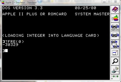

One last issue I've got, FRE(0) reports a negative number (-24xxx something) when I give EhBasic more RAM than configured now.
The problem is in LAB_AYFC. The resulting unsigned 16 bit integer is converted as a 16 bit signed integer to a 32 bit float. I will fix that later. I have to go now!

ArnoldLayne wrote:
... One last issue I've got, FRE(0) reports a negative number (-24xxx something) when I give EhBasic more RAM than configured now.
No worries, mate! Like Klaus said, it's just a signed 16-bit integer thing.

The first version of this patch did not work, as it made logical operations with compare result = true (-1) impossible. To print the proper value for free bytes you should use
? FRE(0)-(FRE(0)<0)*$10000
When FRE(0) returns a negative value $10000 is added.
If you really want to deviate from the beaten path, you can add a routine to convert unsigned integers and jump to it from the functions that you want to respond with an unsigned number. Possible candidates are FRE(), SADD(), VARPTR() and DEEK().

Ok, since it's only a signedness thing, I'm ok with as it is. I was initially concerned that FRE(0) returning a negative value might be because something in my memory configuration is still broken. However, I am happy that this is not the case and the weird behaviour I got from EhBasic were due to some strange hardware issues which are fixed (well, sort of) now.
So, thank you very much for helping me out.
I'll be moving on and implementing LOAD and SAVE. There will be questions. :-)
