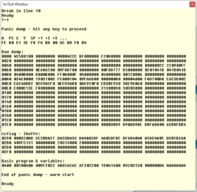

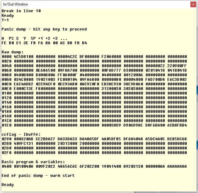

I have written a little tool to dump important memory locations in EhBasic.
dump.asm [6.89 KiB]
Downloaded 196 times
In order to use the tool, you need to include it in min_mon.asm after the basic.asm include. This will keep EhBasic in the same place.
For the new checksum utility some more changes are required to min_mon.asm. The checksum must be initialized by inserting JMP chksum_init into the reset vector and the labels Code_base (in basic.asm) and Code_top must be defined:
      .include "basic.asm"
      .include "dump.asm"     ; *** panic dump utility
RES_vec
      CLD                     ; clear decimal mode
      LDX   #$FF              ; empty stack
      TXS                     ; set the stack
      JSR   chksum_init       ; *** needed for dump.asm ***
LAB_mess
      .byte $0D,$0A,"6502 EhBASIC [C]old/[W]arm ?",$00
                              ; sign on string
Code_top                      ; *** label needed for dump.asm checksum
In basic.asm you need to call the dump on syntax error:
; syntax error then warm start
LAB_SNER
      JMP   dump              ; *** dump trap ***
      LDX   #$02              ; error code $02 ("Syntax" error)
;      JMP   LAB_XERR          ; do error #X, then warm start
Although it is not necessary, JMP LAB_XERR is commented out to keep the program size the same.
When a syntax error occurs, you will see
The dump waits for a key to allow you to get ready to capture the screen output.
UPDATE: dump.asm now dumps strings & protects code with a checksum, dumps code if checksum fails.
