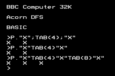

Hi Ed,
Actually, I am using an 80 column wide screen... just not sure what the output should be (meaning I could have an issue with EhBasic). Here's what the output looks like:
I think I have a hint what it's trying to do.... but, not quite correct... hmmmmm...
 Post subject: Re: A test program?
PostPosted: Tue Jun 19, 2018 6:44 pm
It should look like some overlapping peaks... try TAB(Z/4) or TAB(Z/10) and you'll get the idea, then perhaps you can figure out what's happening. PRINT "X";TAB(4);"X" should print 4 spaces between the Xs, I think.
PostPosted: Tue Jun 19, 2018 8:03 pm
Here's a snapshot of the Beeb's output for
PRINT "X"TAB(4)"X"TAB(8)"X"
- you'll see the Xs are evenly spaced (and there are only three spaces printed between each pair)

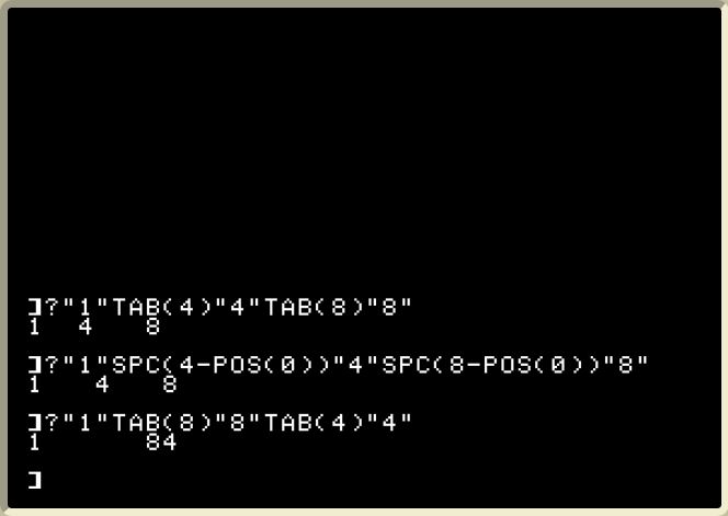

PostPosted: Tue Jun 19, 2018 8:26 pm
Posts: 1949
AppleSoft:
Hmm ... it looks like TAB() treats the leftmost column as column 1, and POS() treats it as column 0.
Mike B.
PostPosted: Tue Jun 19, 2018 8:42 pm
So SPC(Z-POS(0)) instead of TAB(Z) should do the trick?
PostPosted: Tue Jun 19, 2018 8:47 pm
Posts: 1949
That or SPC(Z-POS(0)-1) with a risk of crashing if the argument winds up negative.
