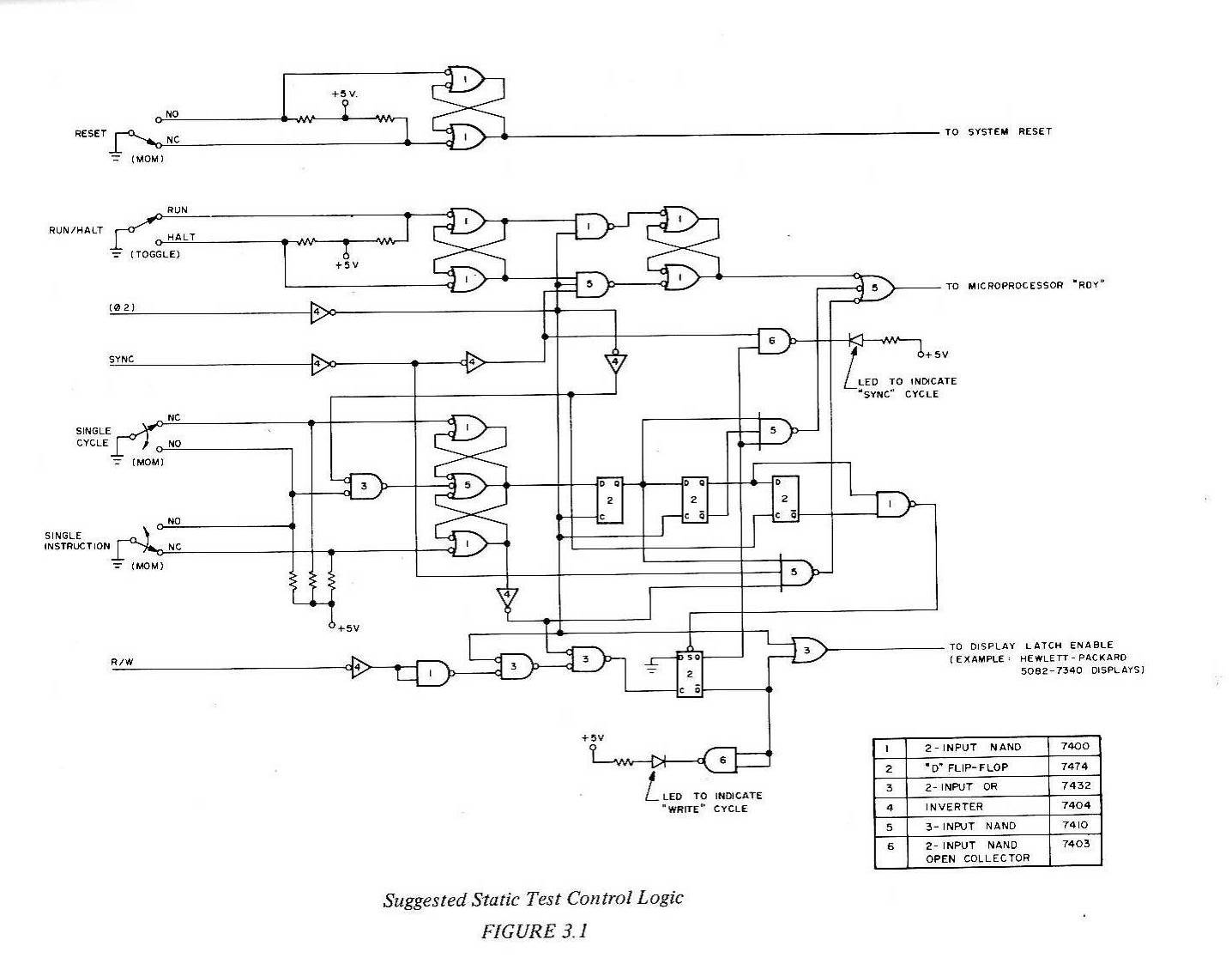

The MOS hardware manual for the 6502 contains the following circuit for static debugging.
Andrew Jacobs

PostPosted: Fri Jun 23, 2006 2:36 pm
Posts: 996
Location: Berkshire, UK
Have you tried stepping memory write intensive code with the Woz circuit?
The MOS manual advices not stopping a write cycle and thier circuit will skip to the next non-write cycle when stepping. Were they being overly cautious?
Andrew Jacobs
