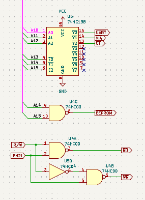

I've obviously done something stupid in the hardware, but I'm going blind looking for it. The situation is that what I expected to be an almost copy and paste from a previous design simply doesn't work: it appears to access the eeprom and reboot and run rom-only code. I am unable to test the ram as yet, as I can't get the UART to run. The reason that the UART doesn't run is that it's never selected, along with a (not fitted) VIA and a (not fitted yet) CF interface. The reason for that is... well, I'll explain later.
First, some code shown to work on the similar board:

and a couple of pics (apologies for the colour: screen grabs), first the decoding:

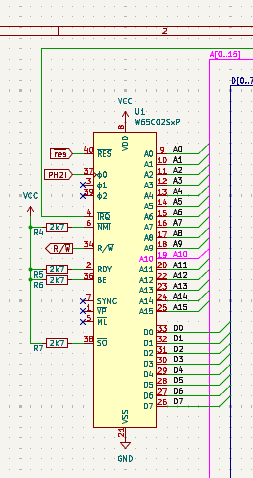

and the processor:
The processor, in the absence of the VIA, also has a pull-up on ~IRQ (pin 4). Not shown are the EEPROM which has its ~OE driven by the ~RD signal and ~CS by ~EEPROM. The clock is from an oscillator module at 1.8432MHz; the reset is handled by an APX823 with its watchdog input line left floating (per the datasheet) to avoid timeout resets.
So on the processor, ~IRQ, ~NMI, ~SO, BE, and RDY are all pulled high; ~RST is held high by the APX chip.
So far, so good. The UART, RAM, VIA, and CF parts are not shown; they're currently not fitted. So the code is (should be) running entirely in the rom and trying to read each 1k boundary between $8000 and $C000. Which should drive the select pins in sequence on that '138, but those pins remain steadfastly high. No select.
The select should occur on addresses %1000 00xx xxxx xxxx to %1001 11xx xxxx xxxx; the remaining reads don't talk to anything and were left in for testing. However, they don't, and as far as I can see the reason is that of the address lines, A9-10-11-12-13-14-15 (yes, seven of them) are all identical and are all an inversion of the ~EEPROM signal.
One curious point: running on the not-working board, R~/W from the processor goes low synchronously with ~EEPROM but not the same signal. On a read-only program. (Yellow is ~EEPROM; blue is R/~W and had no earth attached). It doesn't do that on the working system; as expected, it remains high.
Obviously with that, there is never an occasion when E2 on the '138 is high and ~E1 and ~E0 are low, hence no output. I have changed (and proved in the working board) EEPROM, processor, '138, '00, and even the damn circuit board to no effect.
I am very very confused at this point. It looks as if there is something at issue with the board, but it's nothing I can see. No errors from the schematic tester; no errors from the pcb test except relating to the prototype area I added.

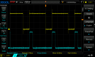

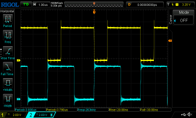

barnacle
Posts: 1831
Joined: 19 Jan 2004
Re: Riddle me this...
Post by barnacle »

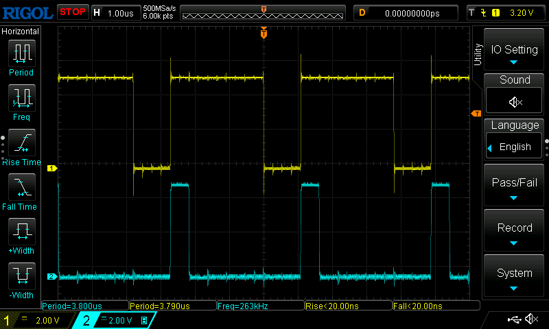

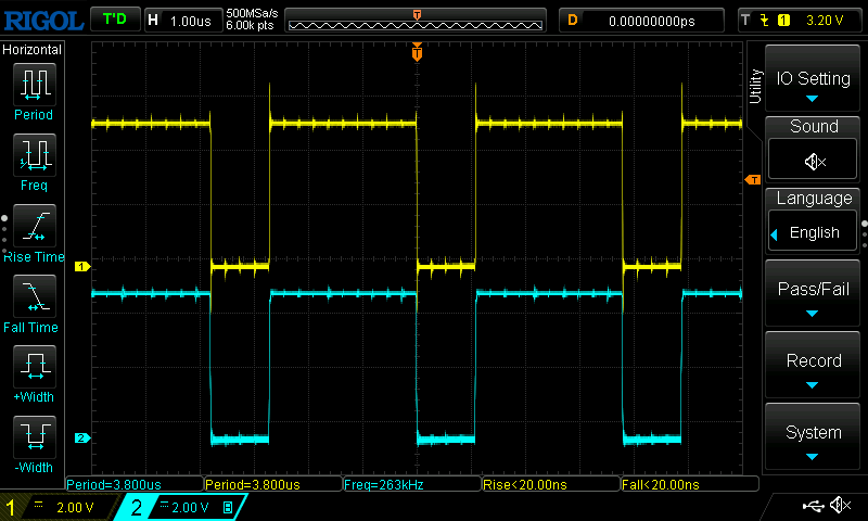

Again, ~EEPROM in blue.
Vector pull, which is definitely surprising:
And Sync:
Sync looks right, I think. Seven clock cycles between instructions, which doesn't look right; should be four for an absolute address, no?
Ah I see, I misread the horizontal scale on the scope. In that case it is consistent with your previous capture with ~EEPROM and R~W and looks correct for a continual sequence of interrupts being taken, probably BRK instructions but potentially continual NMIs could also cause this I suppose. Either way you'd expect two cycles fetching an instruction (apparently, from RAM), then three writing to the stack, then two fetching the vector. You'd also get a SYNC pulse on the instruction fetch.
You really need to see what's on the address and data buses, especially what instruction is being presented to it, which vector is it loading from, and what address is it actually then requesting on the next cycle - as it looks like that is in fact coming from RAM. If you don't have a proper logic analyser, then since at least the error is occuring quickly after reset (hopefully straight away!) it could at least be worth rigging up a manually-stepped clock so that you can step single cycles and then probe the pin levels by hand. I think it will reveal a lot and be worth the effort of any desoldering that's necessary to set this up.

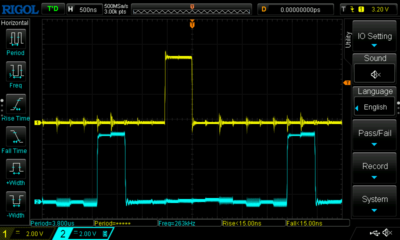

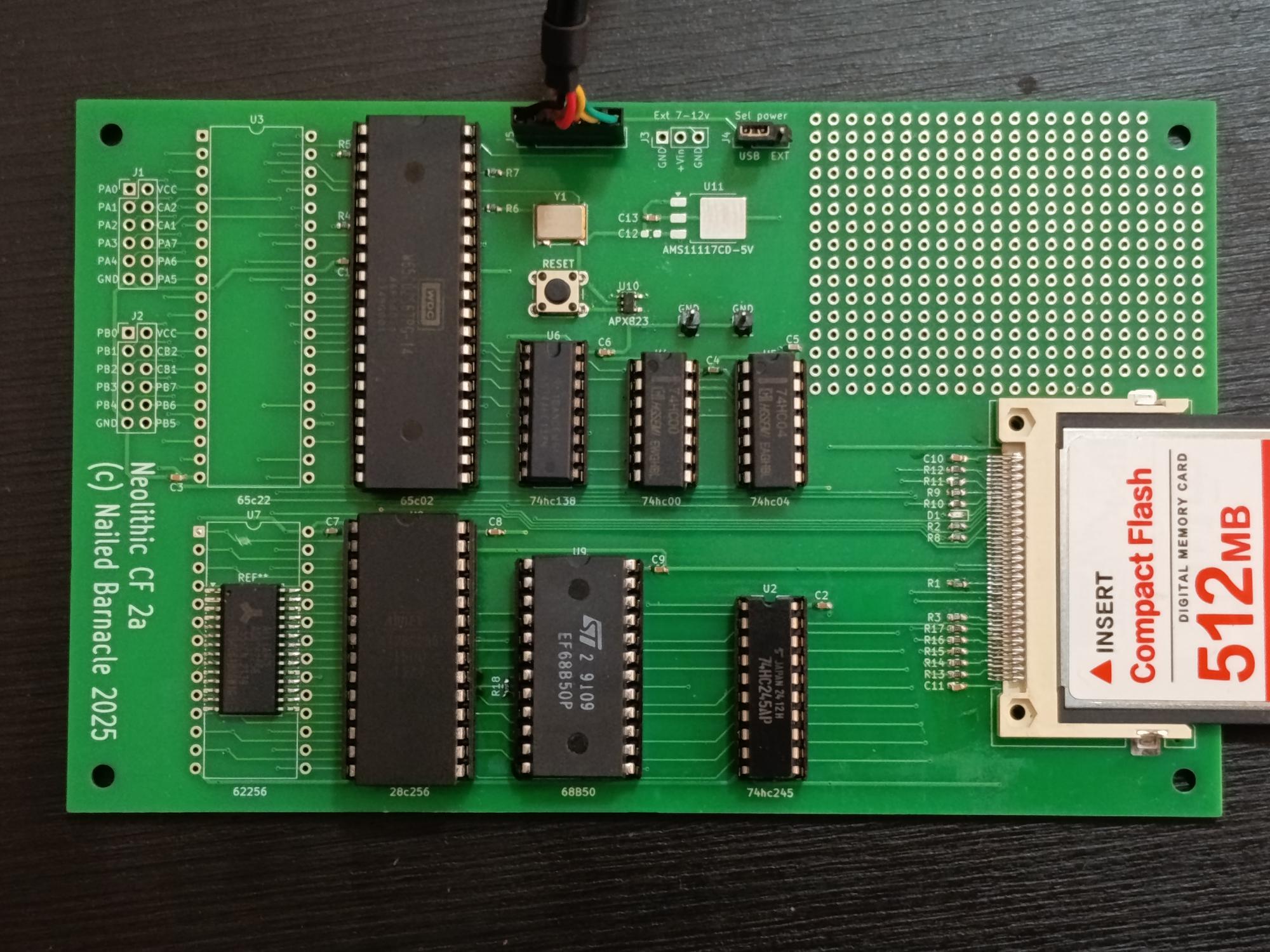

Post by barnacle »

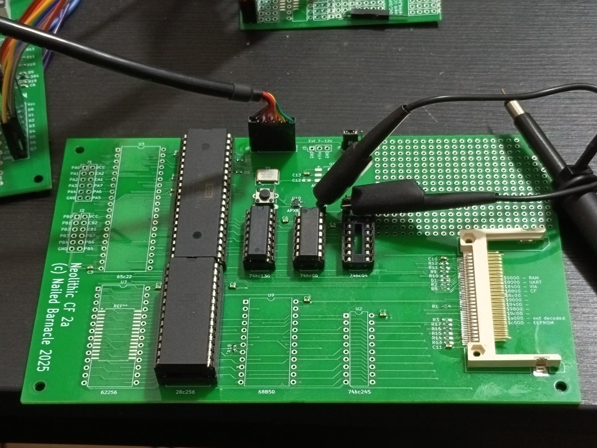

Interesting: this is sync (yellow) against D3; the other signals are vaguely similar but all show zero during the sync. Which is likely where it's getting a BRK from.
And here's the board; can't get much emptier than that...
But I may have just had a brainwave... wait one.

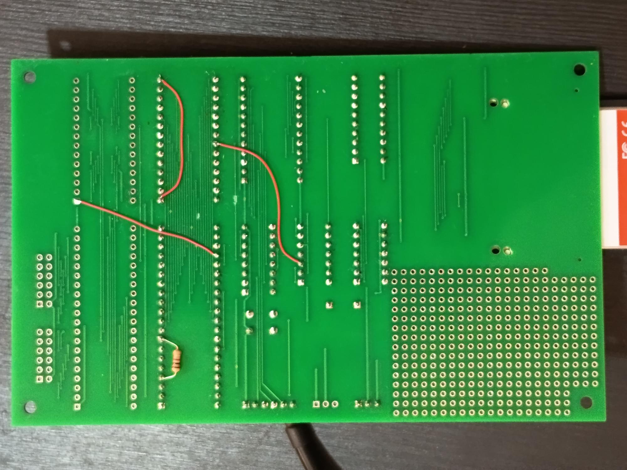

D'oh.
Carefully generated a ~RD signal for the 8080-style CF interface. Fed it to R/~W on the ram and eeprom.
cut cut edit edit solder solder... now at least it's executing, though with not quite the result I expected. Still investigating.
Thanks all.
barnacle
Posts: 1831
Joined: 19 Jan 2004
Post by barnacle »
OK, I misspoke on the last post :mrgreen:
Here's what appears to work (at least as far as (a) the walking pins on the '138 and (b) reading a CF card as far as getting the cf_info data block):
~RD is generated by R/~W NAND PH2I; and fed to the RAM and EEPROM ~OE inputs, and the ~IORD for the CF.
~WR is generated by ~(R/~W) NAND PH2I; it feeds ~WE on the RAM and ~IOWR on the CF
Which I think is where I started... but what I missed was remembering that I only wanted the bottom half of the EEPROM to be active. I attached A14 to its address bus, instead of tying that to ground as I should have done... (it's still a d'oh moment, of course.) A bit of a pain to ground it, since the A14 trace to the ram went through it.
Here's the final (well, current!) circuit diagram, incorporating corrections.
6502_cf_2_a.pdf
(586.3 KiB) Downloaded 36 times
Front view:
My beautiful bodge wires :(
