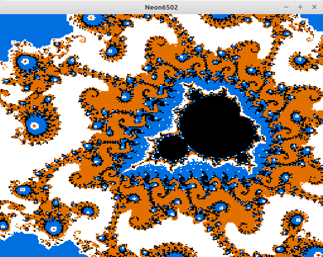

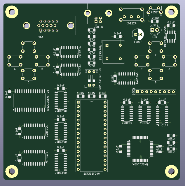

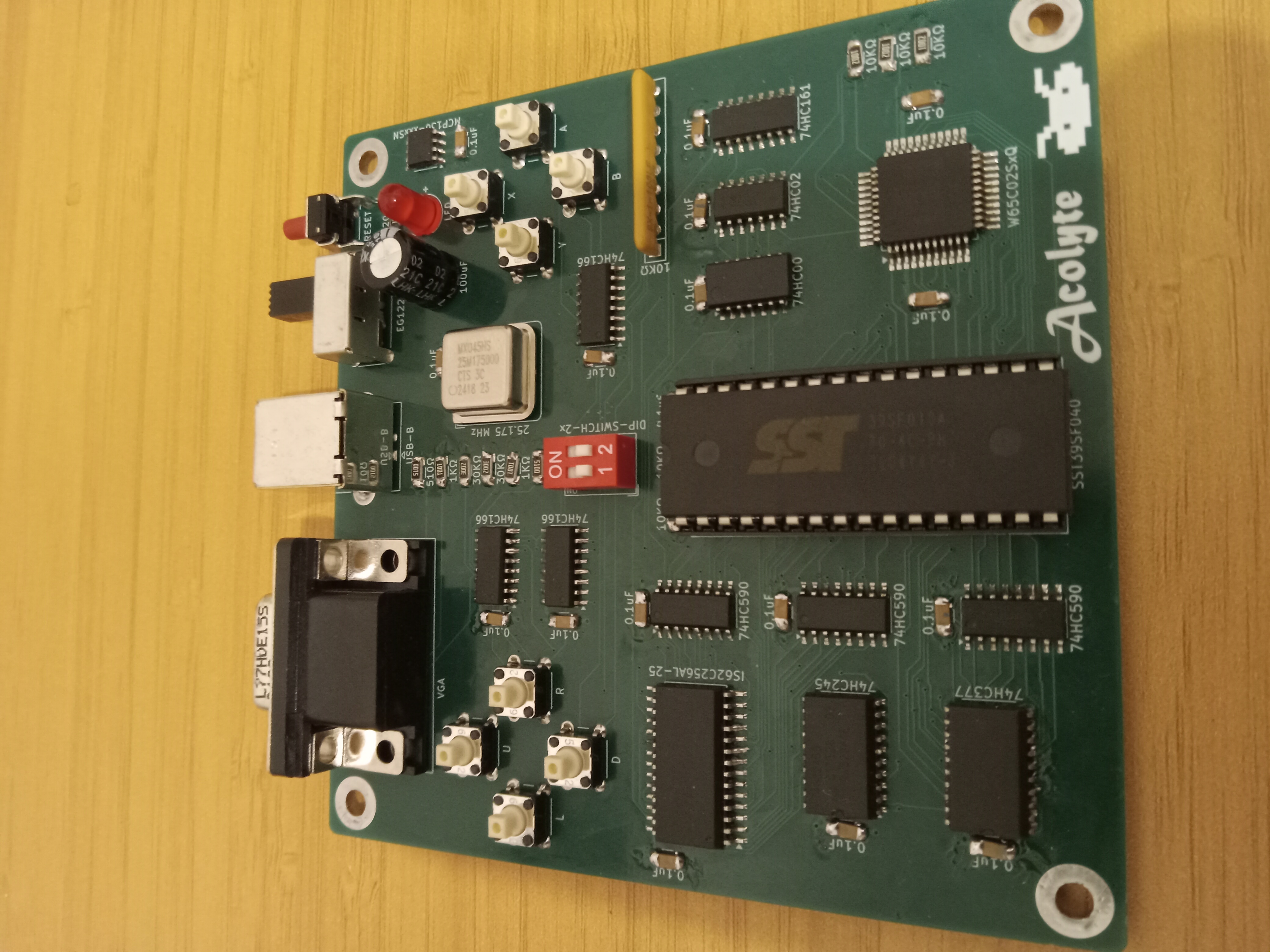

The 6502 runs at 3.14 MHz, capable of 320x240 VGA with 4-colors, and 8x built-in buttons. No VIA, no UART, no audio, no keyboard, no external memory, nothing fancy at all. Going for a very minimalist design using only 74' logic chips and the Flash ROM to produce VGA (as usual for me). It is similar to my previous 6502 projects, such as this one: viewtopic.php?f=4&t=7096, or even this one: https://github.com/stevenchadburrow/AcolyteCompute. Apparently I was making new revisions to these so fast back in the day that I get confused about which came first or second now.
I plan on programming Tetris and Space Invaders for it, just standard games that I've already done before back in the day. As of now I already wrote a simulator for it, so I can start coding right away. I was getting back into 6502 assembly a bit this afternoon, and that is also very fun! It feels like home. I'll soon hit 'print' on the PCB once auto-router is done and I check everything a million times. Hoping for a bodge-less board, especially since I'm using SMT chips. I'll be giving full results in the next few weeks.
