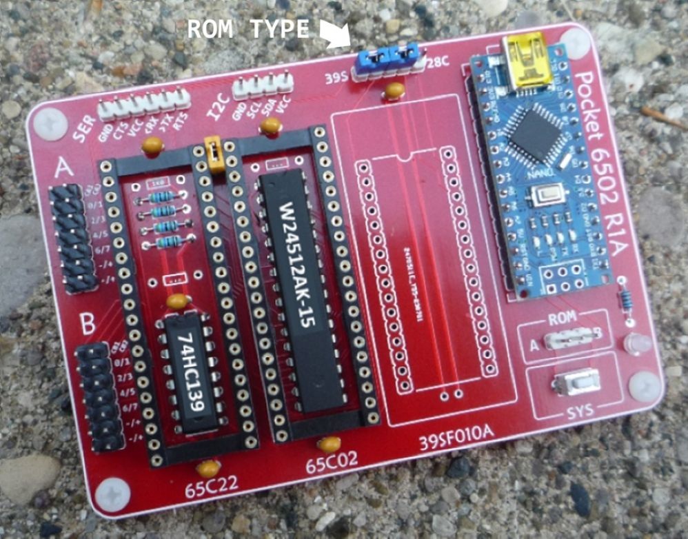

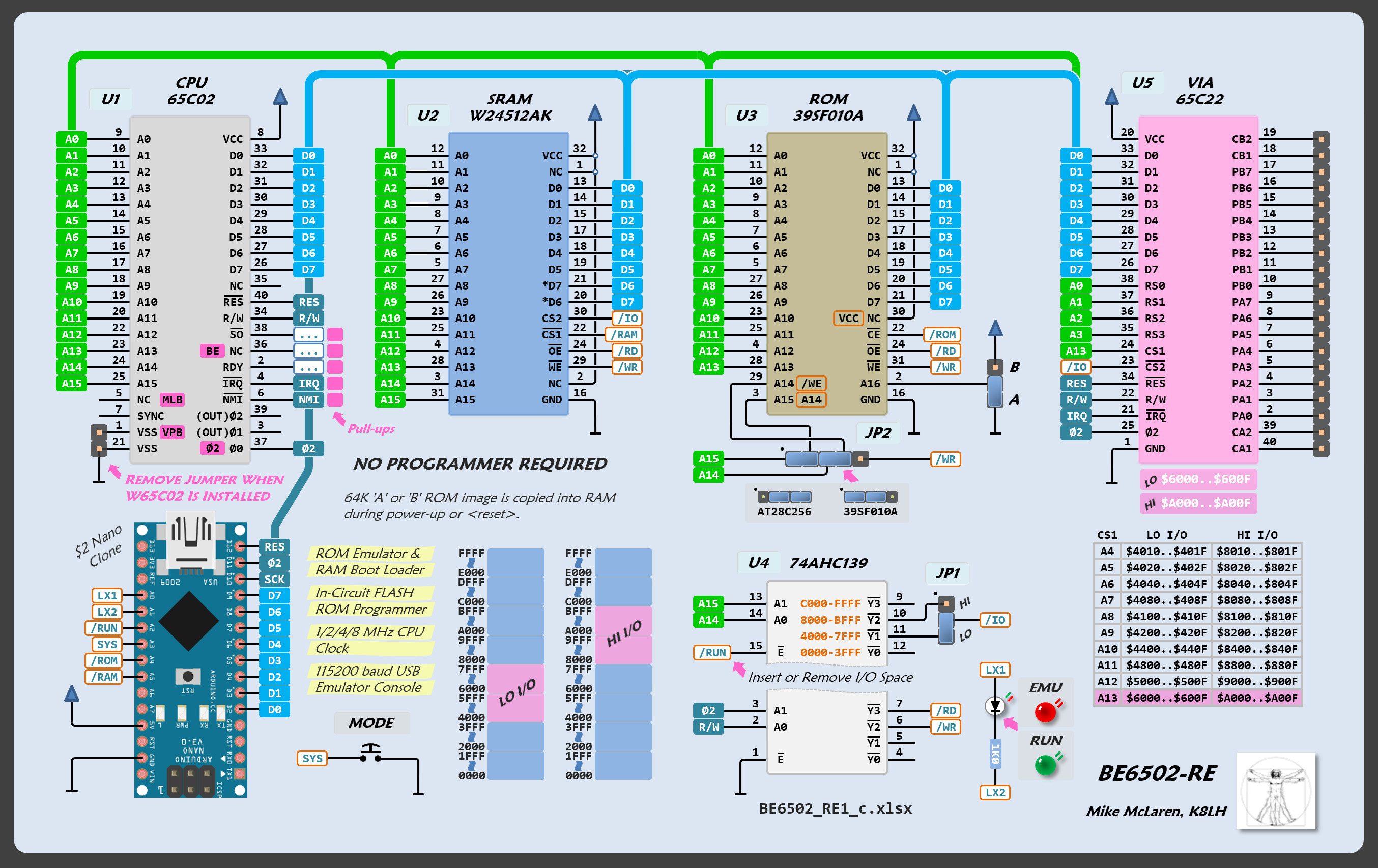

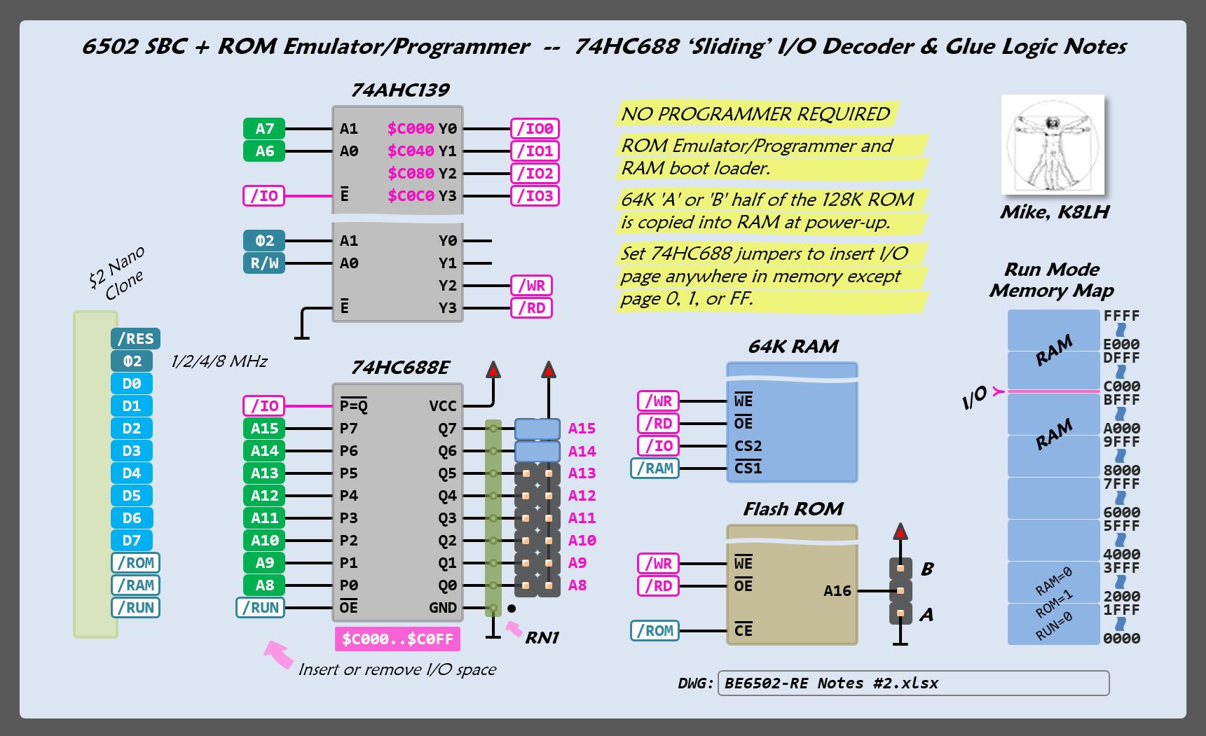

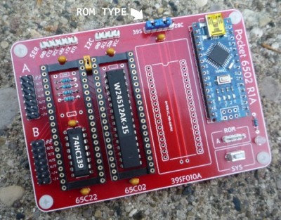

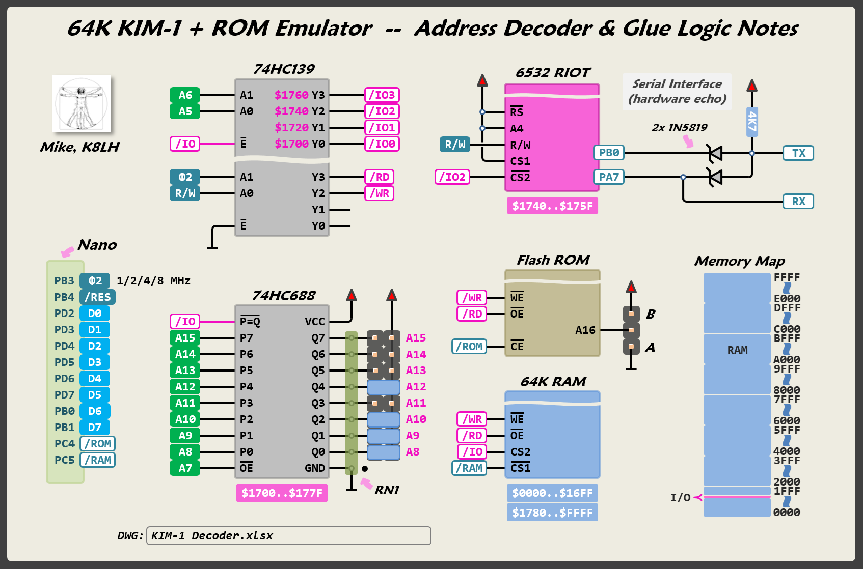

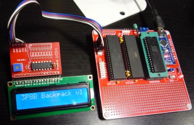

Food for thought... NO PROGRAMMER REQUIRED.
I designed an SBC with a 64K RAM IC and a $2 Arduino Nano clone to form the essence of a custom ROM Emulator & Programmer on the SBC. A 128K Flash ROM is used as an "image store". I thought this design might be an economical alternative to the Ben Eater 6502 design since it doesn't require purchasing an EPROM Programmer.
The SBC has two modes of operation; ROM Emulator mode and Run mode.
Programming a Flash ROM (via Nano USB serial @115200 bps and Terminal software on Host PC);
(1) press 'mode' switch to enter 'ROM Emulator' mode (LED = red)
(2) Load one or more hex files via Nano USB serial into 64K RAM
(3) Program 64K 'A' or 'B' portion of Flash ROM from the 64K image in RAM (about 10 seconds)
Running, and testing iterative code changes;
(3) press 'mode' switch to enter 'RUN' mode (LED = green)
The ROM Emulator presents to the 6502 as a phantom ROM of sorts. During power-up or reset the Emulator provides the 6502 with instructions to copy the 64K 'A' or 'B' ROM image into 64K RAM at a nice leisurely 1-MHz rate then it resets the 65C02, starts the 1, 2, 4, or 8 MHz 'run mode' clock, enables the 64K RAM, and disconnects itself from the 6502 bus.
I've had a working prototype for several years and it runs fine at 8 MHz. I've just never finished up the Arduino ROM Emulator code into a sharable form.

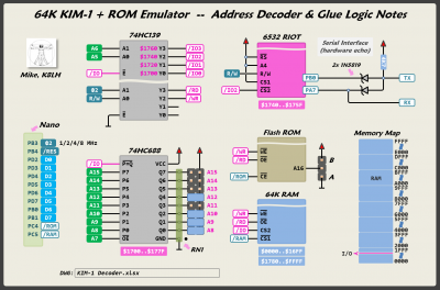

I can use the prototype area on the SBC to test other address decoder schemes by removing the jumper on the JP1 "HI/LO IO" jumper block and driving the /IO line directly from the new decoder circuitry.

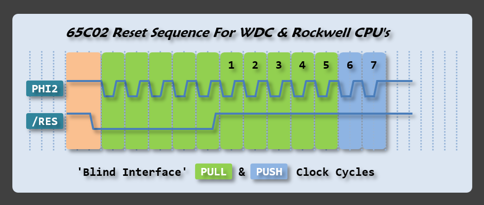

The ROM Emulator just uses its own internal count to decide, if it should suppose the 6502 wants to read instruction, disables RAM+ROM and provide data, or if the 6502 wants read and then connect ROM or if 6502 wants to write and the connects RAM? Without having other indicator then its internal "count"?
Michael
Posts: 633
Joined: 13 Feb 2013
Re: Flash ROM idea - sanity check
Post by Michael »
gilhad wrote:
Yeah, that's basically correct. The emulator keeps track of each clock cycle within each instruction going to the 65C02. The Emulator code builds off the lowest level single-clock uPush() and uPull() functions which specify which memory is active. A brief Emulator code excerpt;
   *  low level 'blind interface' single-clock uPush() and uPull() functions    *
   *  allow the Nano to 'push' or 'pull' data to/from the CPU data bus.  The    *
   *  uPush() function is used to 'push' data from the Nano to the 6502 over    *
   *  data bus during a 6502 read clock cycle (with RAM and ROM disabled).      *
   *  The uPull() function reads data on the bus during a 6502 read or write    *
   *  clock cycle, usually with either RAM or ROM enabled.                      *
   void uPush(byte data)              // ****************************************
   { clk(0); busOut();                // clock lo, Nano bus to 'output'  {1}{4} *
     PORTB = (PORTB&0xFC)|(data>>6);  // set D7..D6 pins (PB1 & PB0)            *
     PORTD = (PORTD & 3)|(data << 2); // set D5..D0 pins                        *
     clk(1); nop(); nop(); nop();     // clock hi                               *
   byte uPull(byte mem)               // ****************************************
   { byte data = 0;                   //                                        *
     clk(0); busInp();                // clock lo, Nano bus 'input' (hi-z)      *
     PORTC &= mem; nop(); nop();      // RAM (PC5) or ROM (PC4) enabled (lo)    *
     clk(1); nop(); nop(); nop();     // clock hi (plus 187.5-nSecs)            *
     data  = (PIND >> 2);             // read/collect D5..D0 bits               *
     data |= (PINB << 6);             // read/collect D7..D6 bits               *
     PORTC |= 0b00110000;             // RAM (PC5) & ROM (PC4) /CE 'off' (hi)   *
     return data;                     //                                        *
Some basic 'core' functions use those low-level functions to read and write RAM or ROM by "pushing" LDA <imm>, LDA <abs>, and STA <abs> instructions and data to the 6502;
   *  core 'blind interface' functions                                          *
   void uReset()                      // ****************************************
   { clk(1);                          // clock = 1                              *
     res(0);                          // reset = 0  ~~~~~~~~~~~~~~~~~~~~~~~~~~  *
     uPull(nul);                      //                                   (1)  *
     uPull(nul);                      //                                   (2)  *
     res(1);                          // reset = 1  ~~~~~~~~~~~~~~~~~~~~~~~~~~  *
     uPull(nul);                      //                                   (3)  *
     uPull(nul);                      //                                   (4)  *
     uPull(nul);                      //                                   (5)  *
     uPush(lo(0x1000));               // address $FFFC (reset vector lo)   (6)  *
     uPush(hi(0x1000));               // address $FFFD (reset vector hi)   (7)  *
   void wrROM(u16 addr,byte data)     // ****************************************
   { uPush(0xA9);                     //  lda <imm>                             *
     uPush(data);                     //   "                                    *
     uPush(0x8D);                     //  sta <abs>                             *
     uPush(lo(addr));                 //   "         address lo                 *
     uPush(hi(addr));                 //   "         address hi                 *
     uPull(rom);                      //   "         6502 write op'             *
   byte rdMEM(byte mem)               // ****************************************
   { uPush(0x4C);                     //  jmp $1000  reset PC (avoid I/O area)  *
     uPush(lo(0x1000));               //   "         abs address lo             *
     uPush(hi(0x1000));               //   "         abs address hi             *
     uPush(0xAD);                     //  lda <abs>                             *
     uPush(lo(addr));                 //   "         abs address lo             *
     uPush(hi(addr));                 //   "         abs address hi             *
     return uPull(mem);               //   "         6502 read op'              *
   void wrRAM(byte data)              // ****************************************
     uPush(data);                     //   "                                    *
     uPush(0x8D);                     //  sta <abs> (uses global 'addr' var)    *
     uPull(ram);                      //   "         6502 write op'             *
   void wrRAM(u16 addr,byte data)     // **********{ overload function }*********
     uPush(data);                     //   "                                    *
Building off of the 'core' functions;
   *  load 64K RAM from 64K 'A' or 'B' half of ROM at 'power-up' or 'reset' at  *
   *  a nice leisurely 1-MHz rate.                                              *
   void bootload()                    // ~~~~~~~~~~~~~~~~~~~~~~~~~~~~~~~~~~~~~~~~
   { putSer(' ');                     //                                        ~
     run(1);                          // remove I/O from address space          ~
     uReset();                        // reset 6502 (synchronize uC to cpu)     ~
     addr = 0x0000;                   // global 'addr' = $0000                  ~
     do                               // copy 64K 'A' or 'B' ROM to RAM         ~
     { if((addr & 0x0FFF) == 0)       // if 4K sector boundary                  ~
       { putSer('.');                 // indicate progress                      ~
       wrRAM(rdMEM(rom));             // ROM -> RAM ($0000..$FFFF)              ~
     } while(++addr);                 // until roll-over to $0000 (full 64K)    ~
   *  program 64K RAM image onto 64K 'A' or 'B' half of the 128K Flash ROM.     *
   void flash()                       // ~~~~~~~~~~~~~~~~~~~~~~~~~~~~~~~~~~~~~~~~
   { putSer(' ');                     //                                        ~
     addr = 0x0000;                   // start address $0000                    ~
     do                               //                                        ~
       { wrROM(0x5555,0xAA);          // erase sector sequence                  ~
         wrROM(0x2AAA,0x55);          //  "                                     ~
         wrROM(0x5555,0x80);          //  "                                     ~
         wrROM(0x5555,0xAA);          //  "                                     ~
         wrROM(addr,0x30);            //  "                                     ~
         _delay_ms(25);               // required delay                         ~
       wrROM(0x5555,0xAA);            // write byte 'unlock' sequence           ~
       wrROM(0x5555,0xA0);            //  "                                     ~
       wrROM(addr,rdMEM(ram));        // write byte                             ~
       _delay_us(20);                 // required write delay                   ~
     } while(++addr);                 // until roll-over to 0 (full 64K)        ~
   *  hex file download to RAM (ROM emulator mode, 115200 baud)                 *
   byte loadHex()                     // ****************************************
   { byte bytecnt;                    // hex record length                      *
     byte type;                       // hex record type                        *
     byte data;                       //                                        *
     byte cksum;                      // hex record checksum                    *
     byte error = 0;                  //                                        *
     uReset();                        // reset 6502 (synchronize uP to CPU)     *
     run(1);                          // remove I/O from address space          *
     do                               // process hex file                       *
     { do                             // process hex record                     *
       { putSer(data = getSer());     // echo & flush <cr> and <lf> chars       *
       } while(data != ':');          // until we see a ':' record header       *
       cksum = (bytecnt = getByte()); // get 'byte' (not character) count       *
       cksum += (data = getByte());   // get address hi                         *
       addr = (data << 8);            //  "                                     *
       cksum += (data = getByte());   // get address lo                         *
       addr += data;                  //  "                                     *
       cksum += (type = getByte());   // get record type (0, 1, or 4)           *
       if(type == 4)                  // if <extended address> record           *
       { cksum += getByte();          //                                        *
       if(type == 0)                  // if <data> record                       *
       { while(bytecnt--)             //                                        *
         { data = getByte();          //                                        *
           cksum += data;             //                                        *
           wrRAM(data); addr++;       // write byte to RAM, bump address        *
       data = getByte();              // get record checksum byte               *
       if(-data != cksum) error = 1;  // test for error                         *
     } while(type != 1);              // loop until <end-of-file> record        *
     return error;                    //                                        *
Several additional functions provide serial routines and a menu for the Terminal (Load, Prog, Run), the CPU clock, code to support the switch between Emulator mode and Run mode, etc.
Hope that helps. Cheerful regards...
I did consider using an MCU as a ROM emulator, and it's something I might still explore just for fun. Your work provides many useful points of departure - thanks.
It either works or catches fire. Either way is fun.
Zolatron 64 project (on Medium)
Michael
Posts: 633
Joined: 13 Feb 2013
Post by Michael »
You're welcome. Should also mention you could go ROM-less and simply use the emulator to load programs via serial and run. Or you can load RAM with a small 6502 boot-loader code from an array placed in the Emulator program. Here's an example where I load an array of Nick Gammon's gPascal image into RAM;

The Emulator can also access the 65C02 peripherals like the VIA (or the SDcard connected to the VIA?). Silly example;
   *  simple VIA Test ~ toggle a Red/Green LED on VIA pins PA7 & PA6 (doesn't   *
   *  require RAM or ROM, just the CPU, the VIA, the 74HC139, and the Nano).    *
