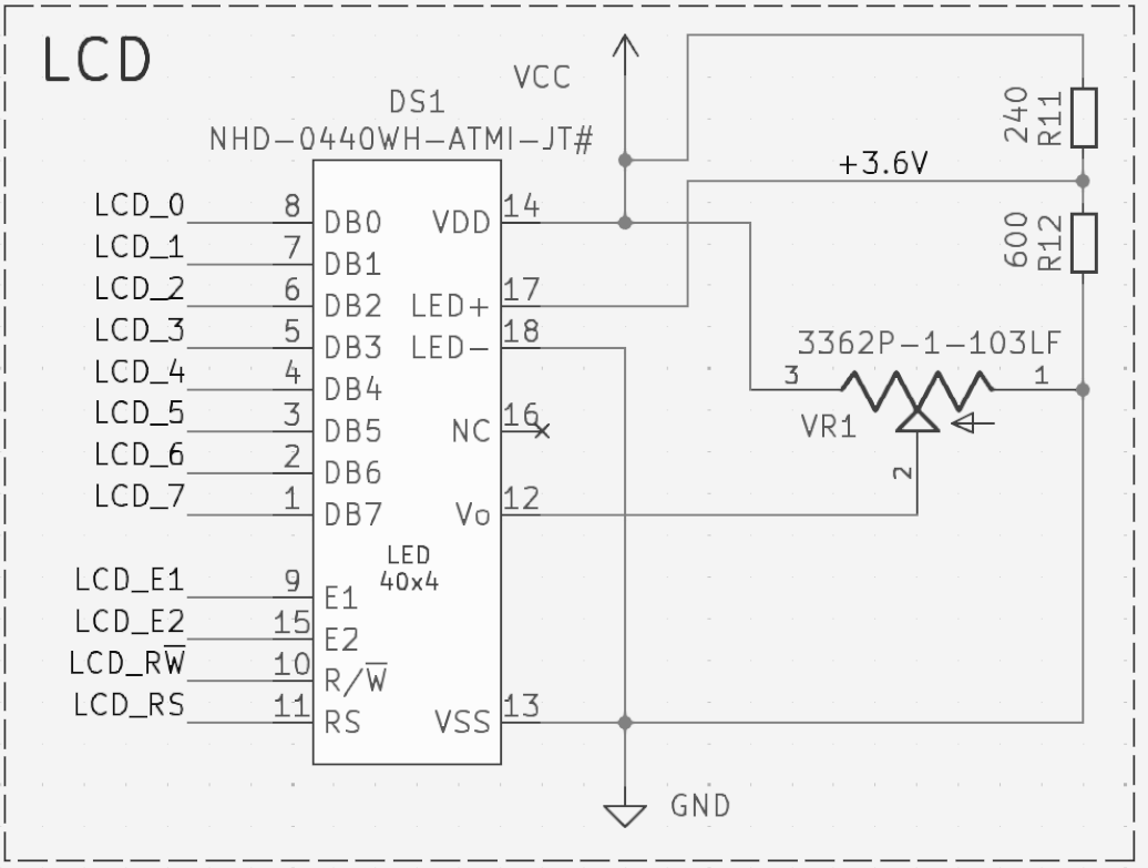

My design is using 5V logic. I have an LCD (40x4) that has 5V input. However, the data sheet specifies the LED backlight anode is +3.5V.
Since this is only to power the LED, and I didn't want to do level converters, I thought I could simply use a two resistor voltage divider.
R1 = 240 Ohm
R2 = 600 Ohm
Gives +3.571 according to https://ohmslawcalculator.com/voltage-d ... calculator.
Will this work or is there a better way?

That's probably not going to work - the backlight is an LED (or more than one) which wants, according to the data sheet you linked, between 20 and 80mA. For precision voltage, you'll need either a transistor used as a voltage follower, or a single-chip adjustable voltage regulator - remember in either case your pass transistor/regulator is dissipating potentially 80mA at 1.5 or so volts, so 120mW, and make accommodation on the PCB accordingly. Or a switch mode part will dissipate a lot less heat internally.
(Or the easy approach: assume that the display will eat, say, 50mA. Arrange a resistor (of sufficient power rating, see above) to drop 1.5v at 50mA; 1.5v/50mA = 30 ohms. Connect that between your 5v and the LED input and with nothing from their to ground. Power will be around 75mW. A higher resistor will reduce the current and give a dimmer backlight; a lower value for brighter.)
PostPosted: Wed Oct 30, 2024 7:56 pm
Posts: 8545
cbmeeks, your resistor voltage divider will only give that voltage output when there's no load on it.  It will be like a 3.57V supply in series with 1/(1/240+1/600)=171Ω.  Even if you short it to ground, the max current will be less than 21mA.  The LEDs probably need more current than you're thinking too.  I made a couple of in-house programmers for work recently with 4x20 intelligent character LCDs with backlights, and they needed a couple hundred mA to get decent brightness.  If you just do a series resistor, that would be approximately (5V-3.5V)/200mA=7.5Ω, and it would dissipate (5V-3.5V)*200mA=300mW.  That's what I would recommend, a 7.5Ω (give or take) resistor, rated for at least a half watt.  LEDs' voltage/current curve makes it far less than ideal to just feed the backlight with a straight voltage regulator—although if you're feeding it from batteries and need maximum battery life, a switching regulator operating in a constant-current mode would be good, not throwing away some of the energy by just warming up a resistor.

Garth, the datasheet says Imax for the backlight is 80mA, hence my calculation or 30 ohms for 50mA. 200mA will likely severely reduce the life of the LEDs, or toast them immediately.
cbm, a resistor is the simplest and cheapest way to drive your LEDs. Get a handful and see which give you the brightness you prefer: 47R, 39R, 33R, 27R, 22R, 18R in order of increasing brightness (and current). As Garth points out, driving an LED from a voltage regulator isn't an ideal way to do it (I'm afraid I wrote that original paragraph before I read the datasheet!).

Again, I would not recommend giving the LED backlight a regulated voltage.  LEDs are not linear devices like a resistor is.  A small increase in voltage will produce a huge increase in current.  The desired current through it will probably produce around 3.6V across it, but that will vary with temperature, and also the current may make a huge jump between 3.6V and 3.9V.  The knee of the voltage/current curve is not as sharp as that of a zener diode, but you still need to control the current, not the voltage.

This is a good example of how some background electronics knowledge is essential for reading a datasheet, and how some datasheets are not written all that well.
It says in a few places that the backlight is an LED, and it is white. If you have some experience with LEDs, you'll recognise 3.5V as a reasonable value for the voltage drop of a white LED, so it is reasonable to guess that it's just an LED connected between the two pins (also, it looks just like the thousand other small character LCDs out there, with the same sort of interface and same set of commands, and every single one of those that I've ever used has an LED connected between those two pins as their backlight).
So you want to power it like any other LED. LEDs convert current into light. If you want a stable brightness, then you have to provide a stable current. Fortunately, the voltage drop across an LED is constant enough over the range of current that you'd reasonably use. You can just subtract that from the supply voltage, and use Ohm's law to work out what resistor you need to get the right current - as barnacle has done for you.
So even though the datasheet appears to say "supply 3.5V to this pin", and a voltage regulator sounds like a reasonable way to do that, it's completely wrong. The only way you'd know it's wrong is from experience and a bit of reading between the lines. You actually want a roughly stable current of roughly the right amount, and a simple resistor is perfectly adequate for that.

OHHH!!!
DUH. That makes a lot more sense. It's literally an LED like any other LED I've connected to breadboards a million times. Obviously, I need to do a little math but more than likely, I will just try some common R values and see what brightness I like. In fact, I have some smaller, cheaper LCD's that I can experiment with. Those 40x4's are expensive!!

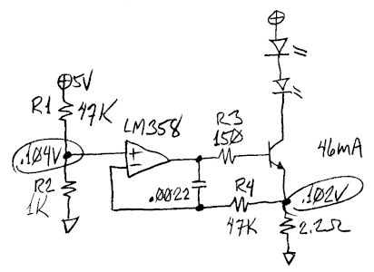

I think the best for driving a LED would be a constant current source.

I like figure 2 the most there, except that I would turn it around if the only power supply available is 5V, because the 741's (and similar, like the LM358's) inputs don't operate within 1.5V of Vcc, and the output won't operate within 1.2V of Vcc, whereas they do operate all the way down to ground.  (The output's pulling-down current falls way off when you get below 0.6V; but if you don't need much current, like a few µA, it'll go down to a few mV.)  So here's my revision (drawn on the back of a literal envelope I pulled out of the trash in front of me):
The IC is one section the common LM358 dual op amp.  It's similar to the '741.  The transistor's hfe hardly matters.  The values shown will give you about 46mA, with the exact amount depending mostly on parts' tolerances and the op amp's input offset voltage error.  R3, R4, and the capacitor are there to prevent putting another pole in the transfer function and losing the phase margin and getting an oscillator.  It may not be necessary, kind of a belt-plus-suspenders thing, but experience causes me to automatically just put them in for applications of this kind.  I still prefer just the simple resistor recommended further upthread though.

These displays are just the common controller + LCD with an LED backlight. There is nothing special about the backlight - it's a panel made up from multiple LEDs wired in parallel (or sometimes 2 rows of 2 LEDs in series).
So it's just an LED and like all LEDs all you need is a single series resistor. You use Ohms law to calculate it, or like me, you get lazy and go online to e.g.
https://ledcalculator.net/#p=5&v=3.5&c=64&n=1&o=w
and pick a 24Ω resistor (based on the typical current of the panel from the data sheet; 64mA in the range from 20 to 80mA).
