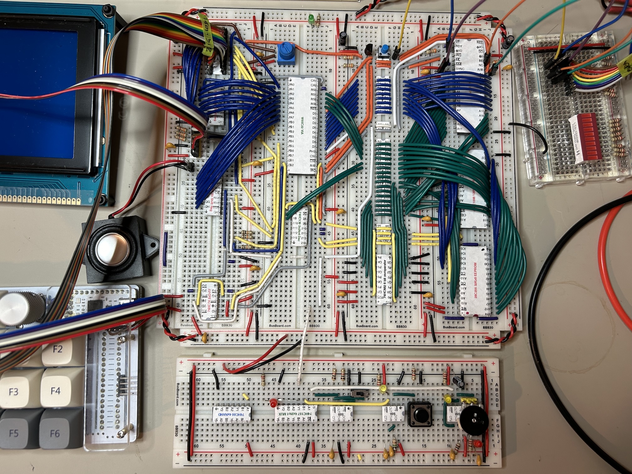

Here's a current picture. I pulled out the arduino address and databus monitor cables for clarity, but left some of the individual pin jumpers.
I'm currently using 65c02-Tool for monitoring.
iirc I did buy an fx2 board for hoglet but haven't tried to use it yet - good excuse for the weekend!
I'm working on a simple schematic to add here later. One thing I noticed while sketching was (a) Michael's drawing says "untested" :-) and (b) it's using the phi1 output for qualified read/write. I know the W65c02 datasheet says this is no longer spec'd/tested, so maybe it is lagging phi2 enough that it causes some problem when i'm accessing one of the IO chips immediately before/after RAM? I can try looking with the scope later on, and i guess an easy test would be to run phi2 thru a nand gate instead (isn't that what they'd do inside the chip h/w anyway tho??).
I've been running super slow for monitoring - you can see my beneater clock hooked up in the picture. So only a few Hz or even single step, but seems to behave similarly if I drive with a 1Mhz clock, so more likely edge-related thing I guess?

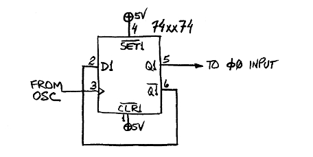

That being said, there's a better way to get a symmetrical two-phase clock, which is use a double-speed oscillator and run it into a flip flop (such as half of a 74AHC 74). Use the Q output as Ø2 and the ~Q output as Ø1. Like this picture from the Primer:

Your wiring is beautifully tidy! I'm going to give you some suggestions. Unfortunately my "shop" is a wreck (thanks to being in the process of building an actual shop) so my electronics stuff isn't really available for photo demonstrations. I'll just have to try and describe verbally.
In the top, main part, of your system, you have power and ground rails running vertically. All the rails are connected together by horizontal rails at the top and the bottom, so your layout looks like a sideways ladder. That's good! However, there aren't enough horizontal connections between those vertical "rungs." Look at, for example, your `139. There's a short black jumper that connects its GND pin to the GND rail on its left side. You should add a longer black jumper that connects that same pin to the GND rail on its right side (where the two yellow wires are running). You should do that for every IC so that instead of it being like your chips are hanging off of a ladder, it's like they're living in a grid with a resolution of one "GND square" per IC.
The other thing is that your bus wiring generally runs horizontally, while your power wiring generally runs vertically. Ideally, wherever you have those horizontal arches of signal wires, there would also be arches of GND wires - one every other signal wire. That might not be practical, but you could try adding one or two GND arches per bus "bundle," especially to the ones that sort of "submerge" in the breadboard to go under some other signals and come out the other side. When I'm doing breadboard wiring I try as much as possible to have the signal wires running directly above the power rails. If they have to cross a breadboard I put a power rail there using jumpers.
Here's a picture of one of my projects: download/file.php?id=20708&mode=view If you look at all the little green jumper wires you can see how every IC has a row of them right next to its GND pin connecting the adjacent GND rails. If you look at the white signal bus wires right in the middle of the board you can see that right under them is a vertical row of green staples so that there is a GND path that directly tracks them.
Edit: One really important thing I meant to mention and forgot to include: your clock signal is REALLY long. Give it its own dedicated ground wire that runs right next to it over the breadboard surface, and where it's airborn make it into a twisted pair of CLK/GND. Your clock module only has ONE connection each of GND and VCC. Do the same thing to it as to the main part of your system (give every IC a connection to both GND rails) and then connect its top rail to the main system's bottom rail 4 or 5 times along its length (basically, wherever one of the ladder "rungs" connects to the bottom rail of the main system).

Some comments about clocking:
  1. WDC specifies a maximum rise/fall time for the Ø0 input of 5 nanoseconds.  That is not achievable with 74HC logic and is marginally achievable with 74AHC.  This is an area in which I recommend the use of 74AC logic.  Only thing is to watch out for ringing, which if sufficiently severe, may trigger double-clocking.
    A small amount of series resistance, with the resistor placed as physically close as possible to the flip-flop’s Q output, can help to suppress excessive ringing.  Additional suppression may be gotten with a pair of fast Schottky diodes attached to the output side of the series resistance, with the junction of the diodes as physically close as possible to the resistor.  A suitable discrete diode is a BAT85, which has a tRR of 4ns.
  2. The Ø1O and Ø2O outputs should not be used at elevated Ø2 rates.  Yes, the circuitry is still there and still functions.  The problem is that if your system timing is slaved to Ø1O or Ø2O, everything will lag what the 65C02 is doing by an unknown amount—the MPU’s activity is slaved to Ø0.  While this lag is not going to cause any grief at 1 MHz, it definitely may once the clock rate is elevated.  In particular, 65xx peripherals that are slaved to the clock will be out of sync with the MPU and may fail to respond due to timing skew.
  3. As Ed noted, a delayed rise of the /WD signal at the end of write cycle can result in data corruption.  Such a malady can be very difficult to troubleshoot.  /WD must rise as soon as possible after the fall of the clock.  Otherwise, the addressed device may see a sudden change in the state of A0-A15 while /WD is still low, which will likely cause a wild write.  The only way to assure that /WD closely tracks the clock is to exclusively use the clock generator’s output to drive all devices that are clock-dependent.
Succinctly, Ø1O and Ø2O should not be used in any new design.  As WDC says in the C02’s data sheet, those outputs are only intended for applications in which the 65C02 is used in an application that originally had an NMOS 6502.

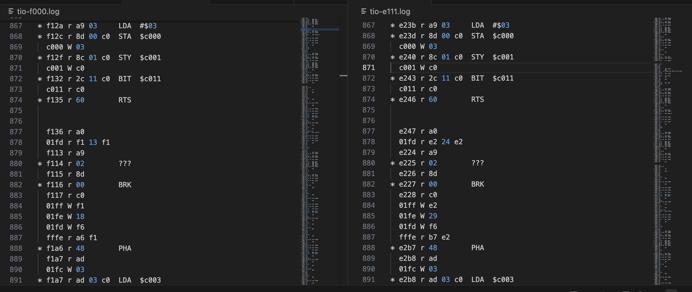

Here are a few more data points.
- Replacing the LS139 with an HC version made no difference. Fails the same way.
- I changed the .org of my ROM code from $f000 to $e111 to flip the parity of all the jsr addresses, with no other changes. The IO addresses remained in the same place in the $c0xx page. The failure mode is identical - it returns $100 beyond where it should, at the same call location. In the original case it read $f113 instead of $f013. With the modified org it read $e224 instead of $e124. See side-by-side traces attached
- trying to understand how it could be a software issue I sprinkled in some `lda $1ff` instructions so I'd see where the value changed. Here's a fragment of a trace where you can see the value morph. This is after successfully doing several jsr/rts involving the top-of-stack at $1ff, and passing my memory tests which heavily exercise the stack in a number ways.
It's as if somehow interactions with the VIA are affecting that memory location, but I'm having trouble imagining a scenario where the byte at $1ff magically increments when $ff doesn't appear on the LSB of the address bus at any intervening point.
Any other debugging ideas? I'll try to organize a PC with hoglet on the weekend. I'll probably also try some clock alternatives - all these tests are still clocked super slow, <1KHz. I'll also try to dig out a different memory chip - I think it's only 32Kb so will leave a hole from $8000-$bfff but I guess that doesn't matter for this purpose.
I've also attached the org .f000 listing if anyone wants to stare at it - it's a bit of mess as chop and change...

Dinosaur's suggestion of using symmetric Q, /Q outputs from a '74 flipflop halving the input clock (replacing the w65c02's phi1 output) seems to fix the problem, at least at for the sub-1khz speeds i'm experimenting with.
I also narrowed down where the phantom write happens (below). Surprisingly to me, read/write to IO page ($c0xx) doesn't seem to be implicated, but I guess phi1-qualified /mr and /mw signals are enough out of phase with the /phi2, /hi and /io signals that we still have the write enabled as the address bits change?
I find it odd that so much seems to work correctly before we get to this repeatable failure point but the hardware details are still very mysterious to me.
Is there a good tutorial that would help me understand the two write-cycle timing diagrams in the RAM datasheet https://www.alliancememory.com/wp-conte ... eb2007.pdf ? I haven't had enough practice to grok them on their own.
* f114 r ad ff 01  LDA  $01ff
  01ff r f0        <= TOS is still $f0 here
* f117 r a2 00     LDX  #$00
* f119 r 20 6e
  01fc r c0
  01fc W f1       <= ?? perhaps this $f1 also gets written to 01ff ??
  01fb W 1b
  f11b r f1        JSR  $f16e
* f16e r ad ff 01  LDA  $01ff
  01ff r f1         <= now TOS is $f1

I still suspect a noise issue of some kind. The W65C02's clock outputs don't lag the clock generator by enough to cause logic problems at your very slow speeds. But the W65C02 is fussy about edges (especially clock edges) at all speeds! Sometimes noise glitches like crosstalk happen at only very specific emergent combinations of conditions and can be really tough to pin down. Can you look at your clock and address lines on a scope? Now that you have a potentially working configuration you could do a before/after comparison.
