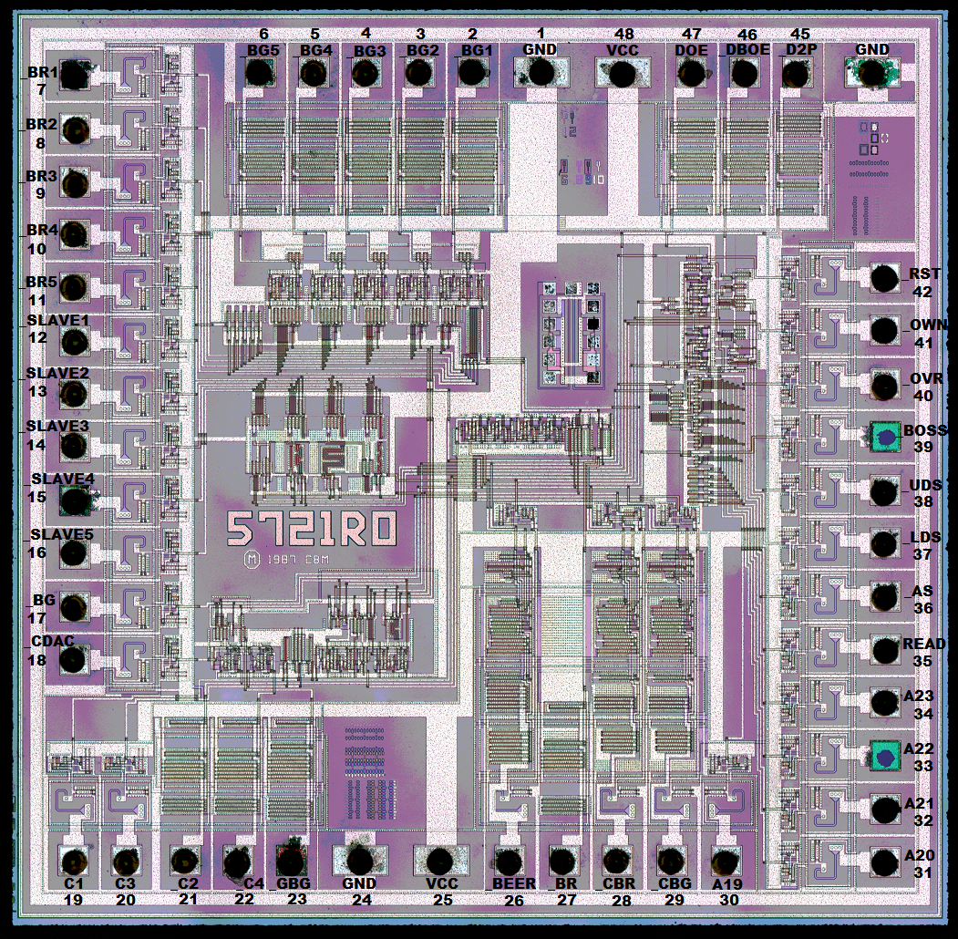

MOS\CSG 5721R0, BUSTER: Amiga 2000 Expansion Bus arbiter, CMOS chip.
Frank told me, that the 5721R0 actually is version 2 of the chip.
And that the 5721R0 was manufactured at MOS\CSG,
while the previous versions were manufactured somewhere else.
Version 2 is the last version of the chip,
so DMA with PAL timing is supposed to work.
A 5721R0 chip was donated to Zeptobars by Frank.
Zeptobars made a nice microscopic picture of the chip.
The resolution of the microscopic picture was good enough for me to do a chip dissection.

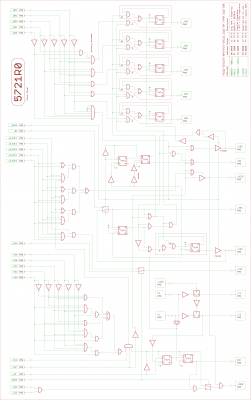

5721R0 Cheat Sheet:
Schematics in *.png and Eagle 6.4 file format:
Low resolution picture of the chip with the pads labelled:
//For the full resolution picture, go to Zeptobars.

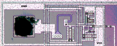

PTEST (pin 44 for the DIP-48 version of the chip).
In the Amiga 2000 schematics, nothing on the PCB connects to this pin.
An interesting question is, if that pin is bonded to a GND pad on the silicon
to allow detection whether the chip is present or not on the PCB.
//Remember the SENSE# pin on the 68881 ?

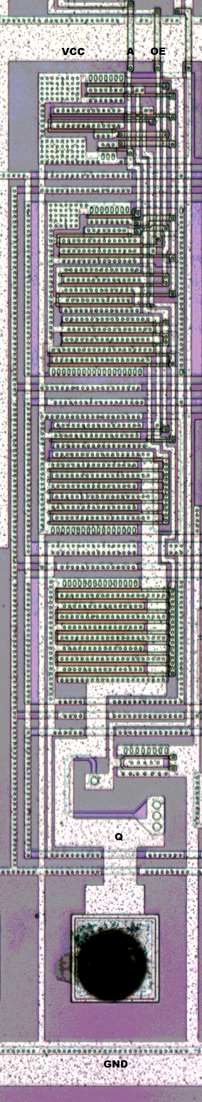

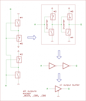

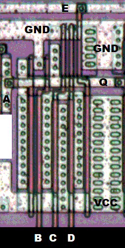

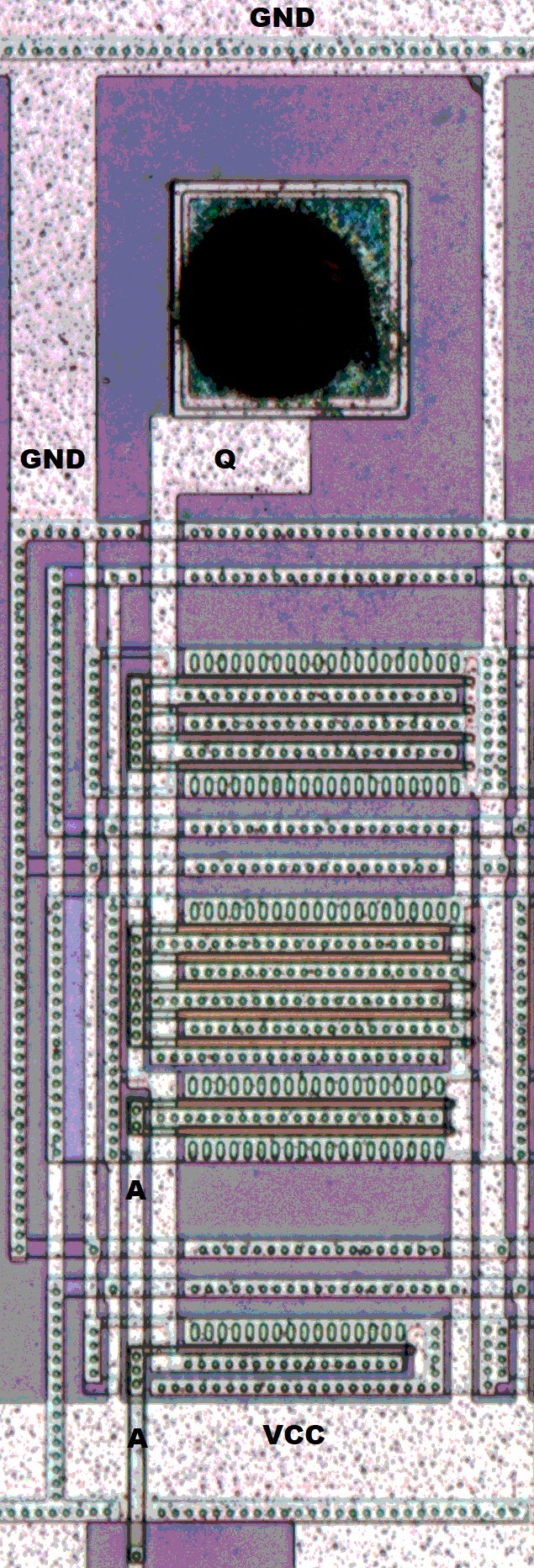

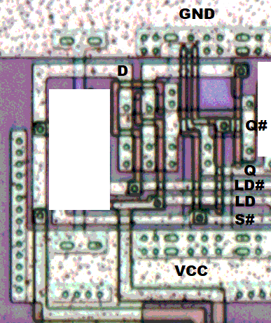

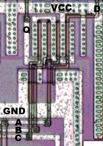

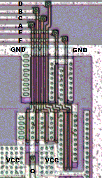

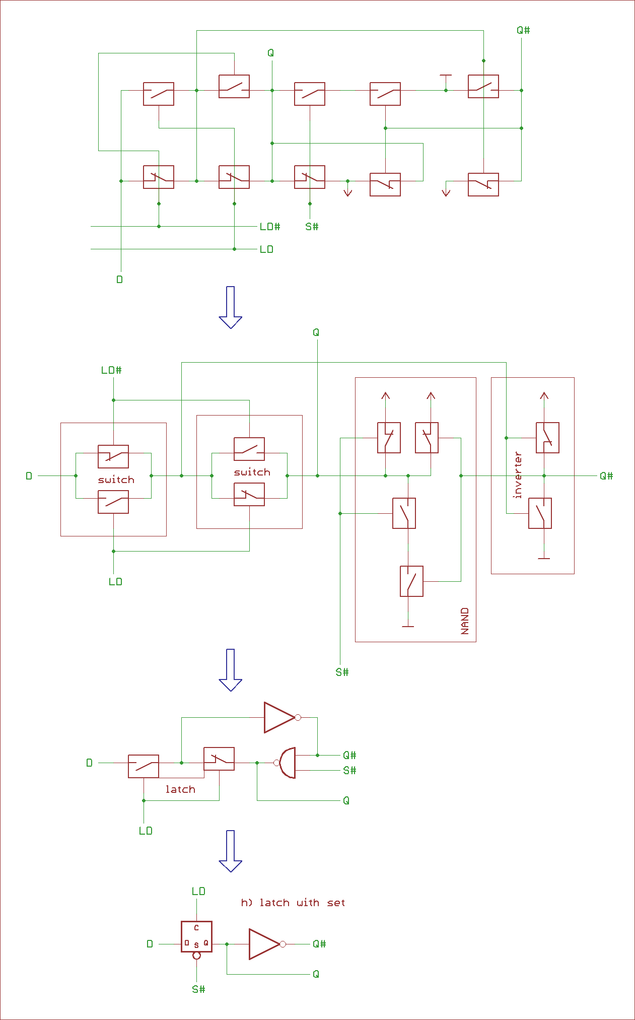

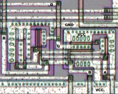

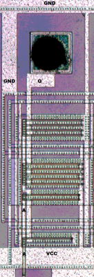

The basics for dissecting CMOS chips already were covered
in the 5719R4 dissection.

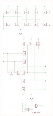

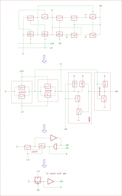

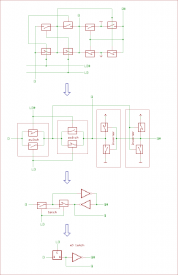

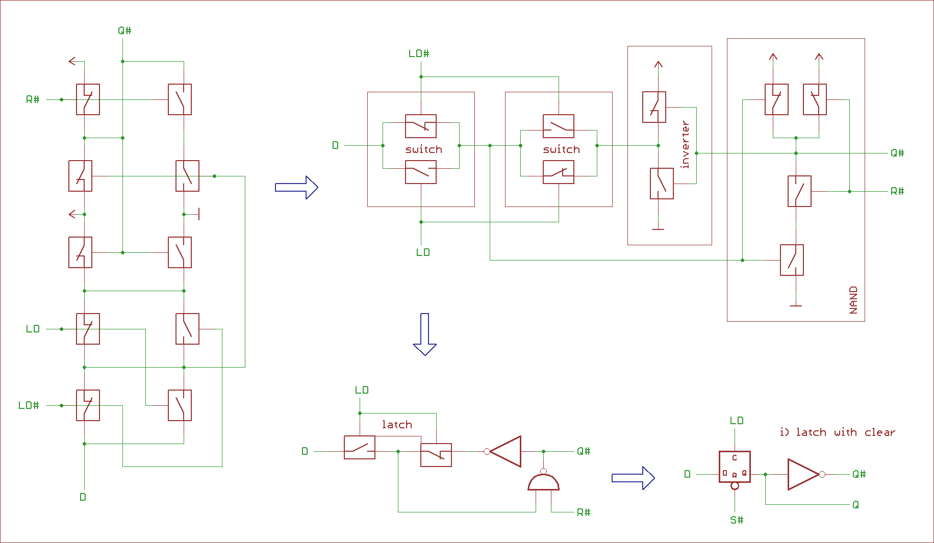

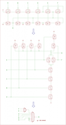

CAD at MOS\CSG noticably had improved since the 5719R4.

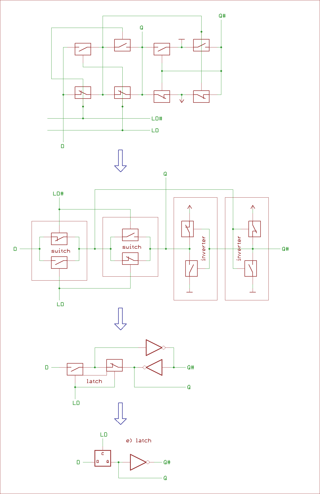

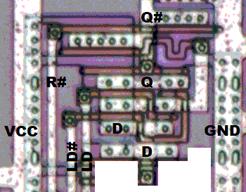

In the 5721R0:
Standard cells are rotated in 90° steps.
Layout for the latches now is incredibly compact.

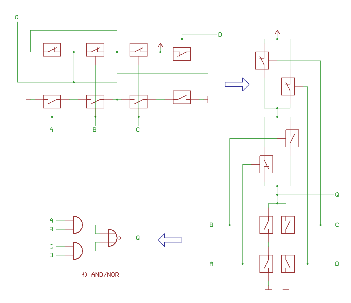

Also, we now have CMOS combination gates, like AND\NOR and OR\NAND.

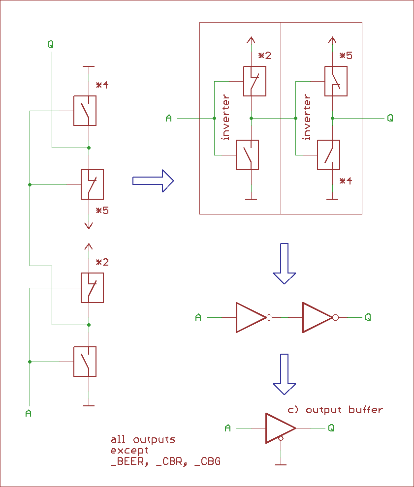

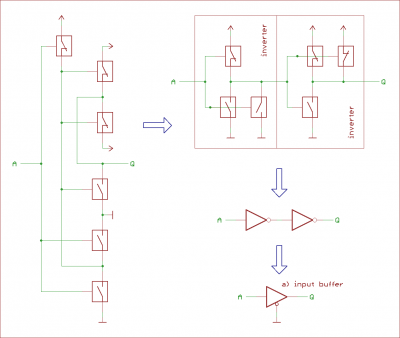

As a reference for further CMOS chip dissections,
I'm putting a catalog of the standard cells I had found in the 5721R0 here:

Another great eye-opener! I do like a die that's dominated by pads and drivers - although in this case, they squeezed out pretty much all the white space. It's kind of interesting that such a low-complexity chip is worthwhile to design: it does of course reduce part count, and board space, and might be faster than an unintegrated implementation. Oh, and might use less power.
