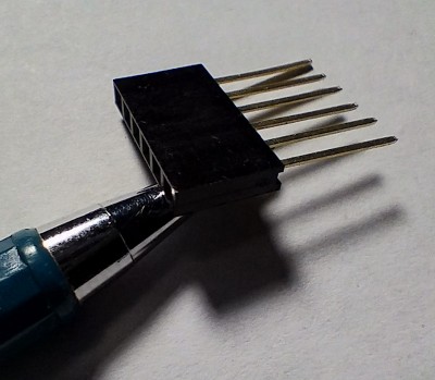

Hello all,
I'm working on a couple of ideas for "piggy-back" PCBs that can be plugged into the 40-pin DIL socket in place of a 65C02 processor.
[One of them is my CPLD board that creates a user-stack space and a user "page zero" using some "undocumented" NOPs]
While I'm waiting for my proto PCBs to arrive, I've been trying to find some 0.1" pin headers but with THIN pins that can be plugged into standard DIL sockets (not tulip ones) without unduly forcing them - so I can revert back to putting the uP back in it's place if needed.
So, my question : what do I look for on Mouser or Farnell ?
Some of my Arduinos came with some neat socket headers with long pins
which would be perfect, but I don't have enough of them... What are they called ? (No, I'm only half forgetful - remember I've lived and worked in France for ~40 years and some jargon I never actually learned in English...)
Any hints (or links) would be welcome :)

https://www.jameco.com/webapp/wcs/store ... 2144631_-1
These may be what you're looking for? The key words are 'long tail' - though Digikey has very little showing.

Those will not safely plug into a DIP socket.  Something like the attached might work.

I've found a few possibilities at Mouser, mainly from Samtec, similar to the ones proposed by BDD. My worry though is that the pins are 0.6mm dia. (Edit - just saw that they're 0.4mm also) :)
The ones in my photo, and proposed by Barnacle, do work with the DIP sockets that have wide, flat, connection surfaces. At only 0.4mm thick, the pins don't damage the sockets. Unfortunately Mouser don't have those. So I'll order a few samples and see how it all works.

for my piggy-back boards I'm using the following combinations.
The shown socket header (I prefer the gold-plated versions) comes with 0,36mm thickness (typical) and fits perfectly into the mentioned sockets. Also, the socket contacts do not get stressed and afterwards, the IC will go back in nicely.
A standard pin header goes into the PCB. When the socket headers are pre-inserted into the socket, it is quite easy to plug/unplug the PCB on top.

The disadvantage of machined socket pins are their dimensions
The pin can be 0.45 up to 0.55mm in diameter (see https://www.greenconn.com/en/ckfa103-a002.htm)
Compared to the PDIP terminal thickness of 0.25mm
https://www.ti.com/lit/ml/mpdi001b/mpdi001b.pdf?ts=1723814880587&ref_url=https%253A%252F%252Fwww.ti.com%252Fpackaging%252Fdocs%252Fsearchtipackages.tsp%253FpackageName%253DDIP
Machined socket pins have the tendency to widen the sockets too much, so later, IC's will not make good contact again.

Machined pins that are ~0.018 inches diameter are compatible with a regular socket.  Take a look at what Samtec offers for some examples.

We fairly often see damaged sockets in the land of Acorn, particularly because there are several projects which work by in-socket replacement of the CPU. One way to deal with a damaged socket is to put a turned-pin socket into it and then use that.
Yes, I've seen even projects using standard square pin headers of 0.64mm. Damaged sockets are 100% guaranteed.
I go with the thinnest socket header available, just for safety. And it also lifts up the piggy-back board a bit above any surrounding components like capacitors or other socketed IC’s
