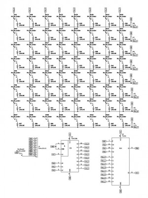

Proxy wrote:
why not just use one of the VIAs directly?
assuming you don't use the VIA's handshaking feature you can use the CA/CB pins as free I/O.
so a 74HC163 with it's clock and reset inputs hooked up the VIA's CA2 and CB2 pins (with some pull ups or pull downs). the output of the counter goes to a 74HC154 which then goes to the keyboard matrix. the other side of the matrix is then simply hooked into the VIA's regular IO pins (however many are required, though even just 8 inputs give you 128 keys).
so to scan the keyboard (assuming 74HC163 clk = CA2, reset = CB2, matrix input on Port A) once you:
1. reset the counter by pulsing CB2
2. read the value from Port A and store it into memory
3. pulse CA2
4. repeat 2 and 3 a total of 16 times
5. now either leave the raw keyboard data in memory for non-ISR code to handle or directly convert it to a bit/bytemap of which keys are being pressed at the moment.
sure it's a lot more software overhead and based on polling (i recommend some form of timer interrupt anyways), but it keeps the IC count low and makes hardware less complex.
which is good because fixing software mistakes is a lot easier and requires fewer cuts and botch wires than fixing hardware mistakes!
plus you still have one of the ports free which you could use for some software SPI for some cheap expansion (SD Card, RTC, various sensors, tiny displays, etc).

It's not just the scan/decode choice.
If you have a completely cpu driven keyboard scan (i.e. the main CPU, not an auxiliary part) then it has to spend a certain amount of it's time just scanning the keyboard, as well as managing the debounce and rollover in software. If you have a completely hardware approach, you need to know when a key is ready, so probably an interrupt, as well as handling (probably) debounce and rollover.
Similarly for something like PS/2, you either need to poll the clock line - rapidly - or have it trigger an interrupt (again, processor time) to decode the data, and you still need to sort out the keydown/keyup messages as well (you might want both edges of a key press, as Windows did (does? I'm out of touch) in an event loop).
My split the difference approach I think will be to use an external processor to mediate a PS/2 keyboard, read the individual packets, and spit them out as serial data - so I'll still need to sort out keydown/up messages at the processor, but the PS/2 sorts everything else out. (Or I can make it just send the keydowns as they happen and sort out control and shift there.) As it happens, I already have an SPI uart, so adding another is no great shakes.
I could do this with an eight-pin part, but I have a box full of STMs with 48 pin, so that's what it'll likely be.
(Or alternatively, use the same STM to handle an external UART channel and talk to it by SPI, let it sort out streams from serial port and keyboard. Time to play.)

viridi wrote:
I'm not sure if I need keydown/keyup messages. Windows did/does this but did those older computers have have keydown/keyup messages? Something like the C64 or the Acorn BBC Micro?
You may not need them but if you use a PS/2 keyboard then you'll get them because that's how they work... Although the 'driver' can hide it all from you. Making a PS/2 keyboard present a 7-bit + strobe interface is relatively easy with a micrcontroller.
(The other issue with PS/2 keyboard is language - some keys are in the wrong place)
If using your own matrix/polling scheme then it's entirely up to you - one thing that may influence that decision is games (or even some non-game tasks) if you want to detect e.g. how long a button is pressed - think of something like space invaders - simple left/right/fire controls, but if you can only get keypressed then you push a key to start moving then you need to push another key to stop moving/change direction rather than simply let the key go. Or even moving a cursor - auto-repeat has to be implemented... somehow...
Ok clear. Thanks drogon. In the design I found that the keyboard is scanning constantly by some clock circuitry (perhaps I can use the system clock for that). All columns are scanned by the 74154 4-Line to 16-Line Decoder/Demultiplexer (with a 4-bit binary counter as input). The rows are scanned by the 74150 (with second 4-bit binary counter as input). When a key is pressed the 74150 captures that and strobes when the row of that key is active. Then the keyboard should output 7-bits these come from both the 4-bit counters and shifting/control logic. I could also send a strobe bit to the 6522.
I guess the keyboard would send data many times to the 6522 if the user holds down a key and the 6502 wil get interrupts every time then left/right/up/down movement would be appear. Please correct me if I'm wrong.
