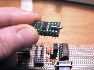

Well, the 16is750 a 16550 register-compatible UART that's still around (although seemingly only in a HVQFN-24 package). :| But the reason it doesn't have a zillion legs is, it's not bus-driven. Instead, the host interface is SPI (or I2C, depending on whether a certain pin is tied high or low).
So, not quite the same animal. But it's possible to make a little module that plugs into a DIP site (as I did with this now-obsolete 24-TSSOP version)...

Yabbut... there's something a bit weird about using a serial interface to, um, talk to a serial interface... kinda non-intuitive.
Though I suppose the big advantage is the self-clocking nature of SPI (I'm not a fan of I2C).
I'd love a parallel memory interface with perhaps a couple of addresses for internal registers, one chip select, one interrupt output, rx and tx, none of the control signals - kind of a cut-down 6850 I suppose. Should fit easily in a 20 pin chip.

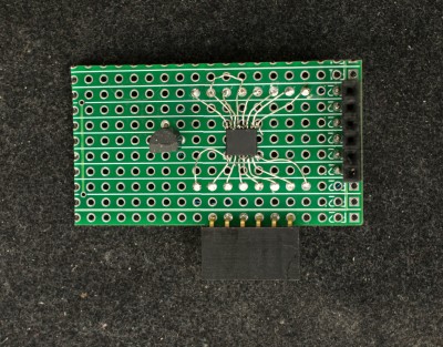

ZDU0110.
Admittedly I have not got it to work. Need to look into it again. viewtopic.php?f=4&t=7899&p=105584&hilit=Zdu0110#p105531

An interesting looking chip - though they do seem to have stuffed everything they can think of in there... but again, it's an I2C interface. At least it's claimed to have a 'works when turned on' function, but I found myself a little confused by their baud rate selection.
