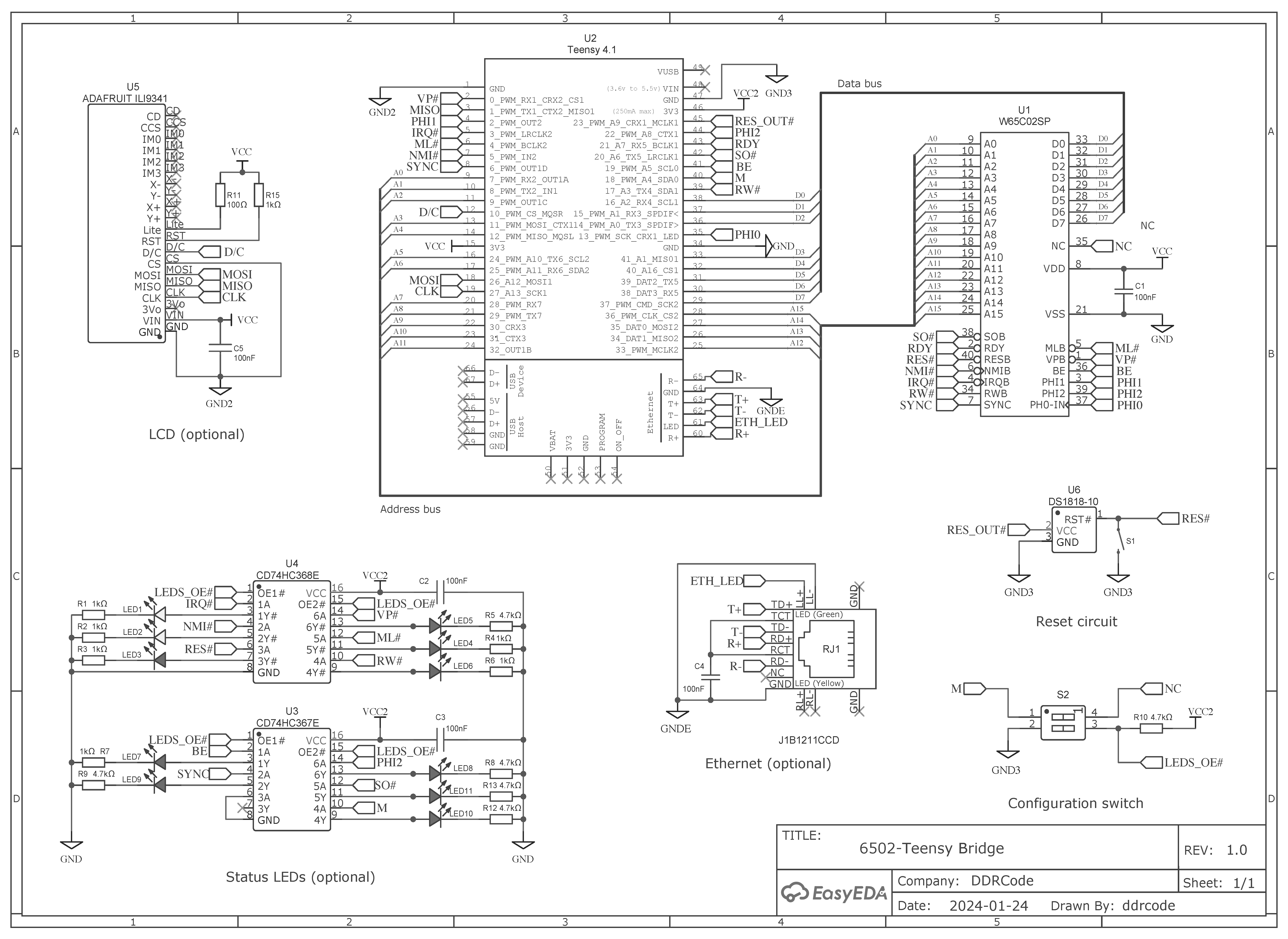

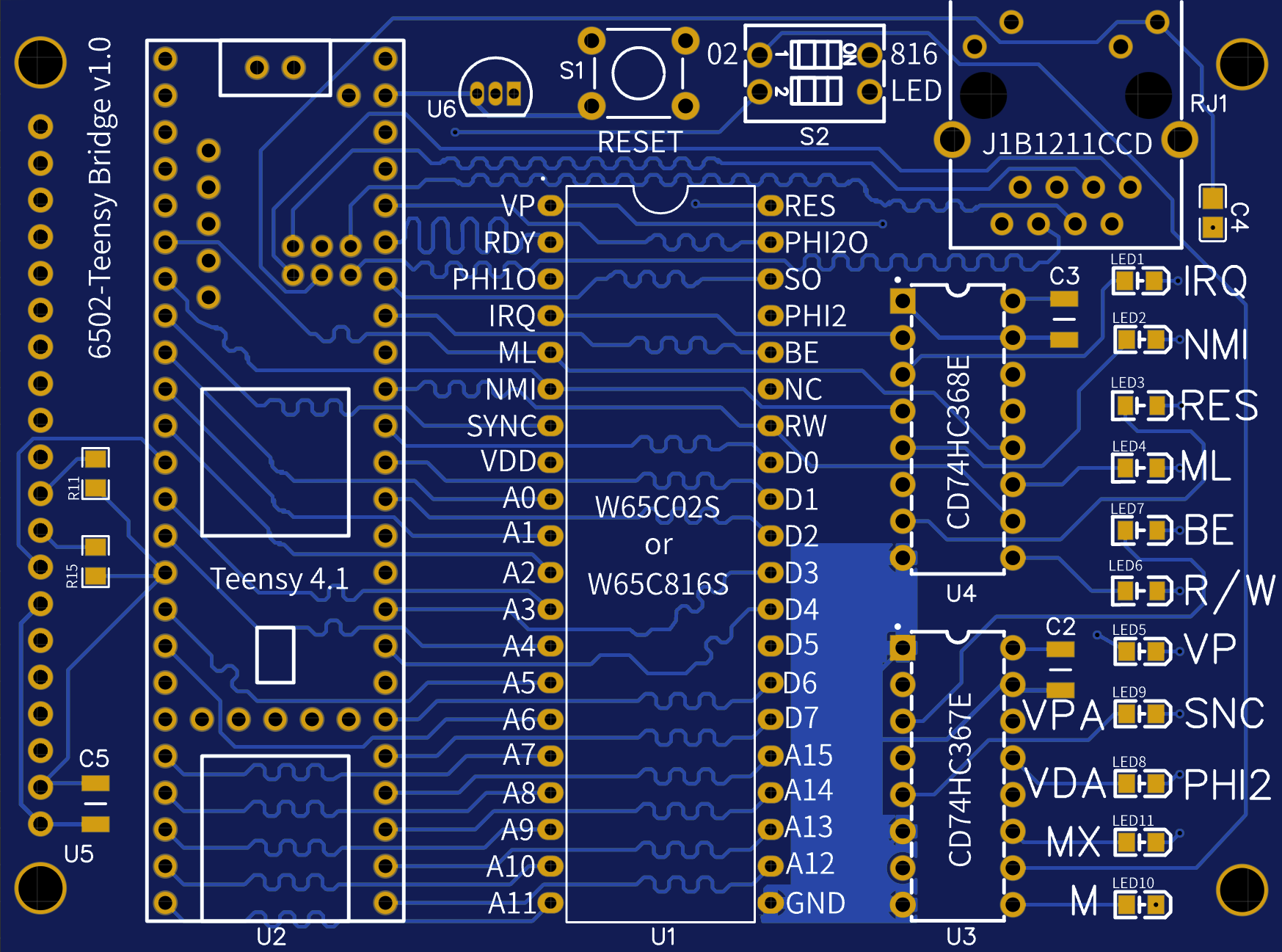

I would appreciate if you could find some time to review my (rather simple) schematic and PCB design. This is my very first PCB, so you are more than welcome to roast me badly :D I definitely have more experience with ASM (and programming in general) than with the electronics, but the retro passion wouldn't be "complete" without dealing directly with the hardware, would it?
Project purpose
Mostly - debugging, secondly - learning. I am using Teensy 4.1 dev board to control W65C02 or W65C816 via serial port (or Ethernet) from my main computer. I do it mostly to test my emulator (written in Rust) against the actual CPU to guarantee cycle-level accuracy. The project is simple enough that perhaps designing a dedicated PCB (over breadboard-based solution, that I'm currently using) is an overkill, but - on the other hand - it's perfectly simple for learning purposes. Apart the Serial/Ethernet bridge, the PCB has 11 LEDs for quick status control (and a switch to disable them), a switch between 6502 and 65816 (that simpy either keeps 02's NC pin floating vs being connected). After designing all of that I've realised that I have enough Teensy pins available for one SPI connection, and seeing that my board had a size almost identical (now really identical) with ILI9341 3.2" LCD I decided to expand the capabilities of the project and there an option to have a screen at the back of the board. That, on top of debugging, would allow to use the board for some fun retro projects, similar to Olimex Neo 6502 (https://www.olimex.com/Products/Retro-Computers/Neo6502/open-source-hardware) with the advantage of the screen and much nicer (in my opinion) development board (Teensy) than RP2040 used by Olimex.
Files
All schematics, Gerber files and screenshots can be found in a browseable form on my Github: https://github.com/ddrcode/teensy_6502_ ... ee/pcb/pcb, but I have attached the main files here as well.
Design decisions (and questions)
1. 3.3V (for compatibility with Teensy and ILI9341)
2. The U3 and U4 ICs are simple line drivers (U4 is inverting one) to drive LEDs and to avoid powering the LEDs directly from signal lines. Curious whether you'd suggest other components for that job? Ideally I would prefer something in PDIP-14 (rather than 16) with all inputs on one side and outputs on the other (that would massively simplify my tracks), but - to my surprise - I couldn't find any. The closest with that layout (but in PDIP-16) I could find was TI 4000B series, but that means stepping into TTL theritory.
3. The dip switch controls the LED's "subcircuit" by simply cutting the VCC on/off. I could, theoretically, drive U3/U4 bus-enable signal instead, but then I'd need to deal with floating input to all LEDs and pull them down.
4. I decided to have all LEDs, resistors and capacitors in SMB form (all in 0805). I don't have bigger issues soldering 0805's and that's always a good practice of patience :-)
5. I use DS1818 to control reset function. I'm tempted to stabilize the pushbutton in the reset circuit with capacitor, but even the datasheet for DS1818 shows a circuit without any cap. Is that ok?
6. In two places on the PCB there are vias directly on solder pads (C4 and LED10). I know there are different opinions about placing vias on pads and I'm curious what's your (pragmatic) approach is?
7. Those tiny 0805 LEDs are super bright (I've tested S85CS5), especially having 11 of them. According to the math, I should be using 60-100 Ohm resistors for them, but in my actual tests, I had to increase the resistance up to 2-4k Ohms to use these LEDs as indicators rather than the source of light in my room :-)
If you have any questions, comments, suggestions - I'd love to hear from you. And thank you!

File comment: Schematic

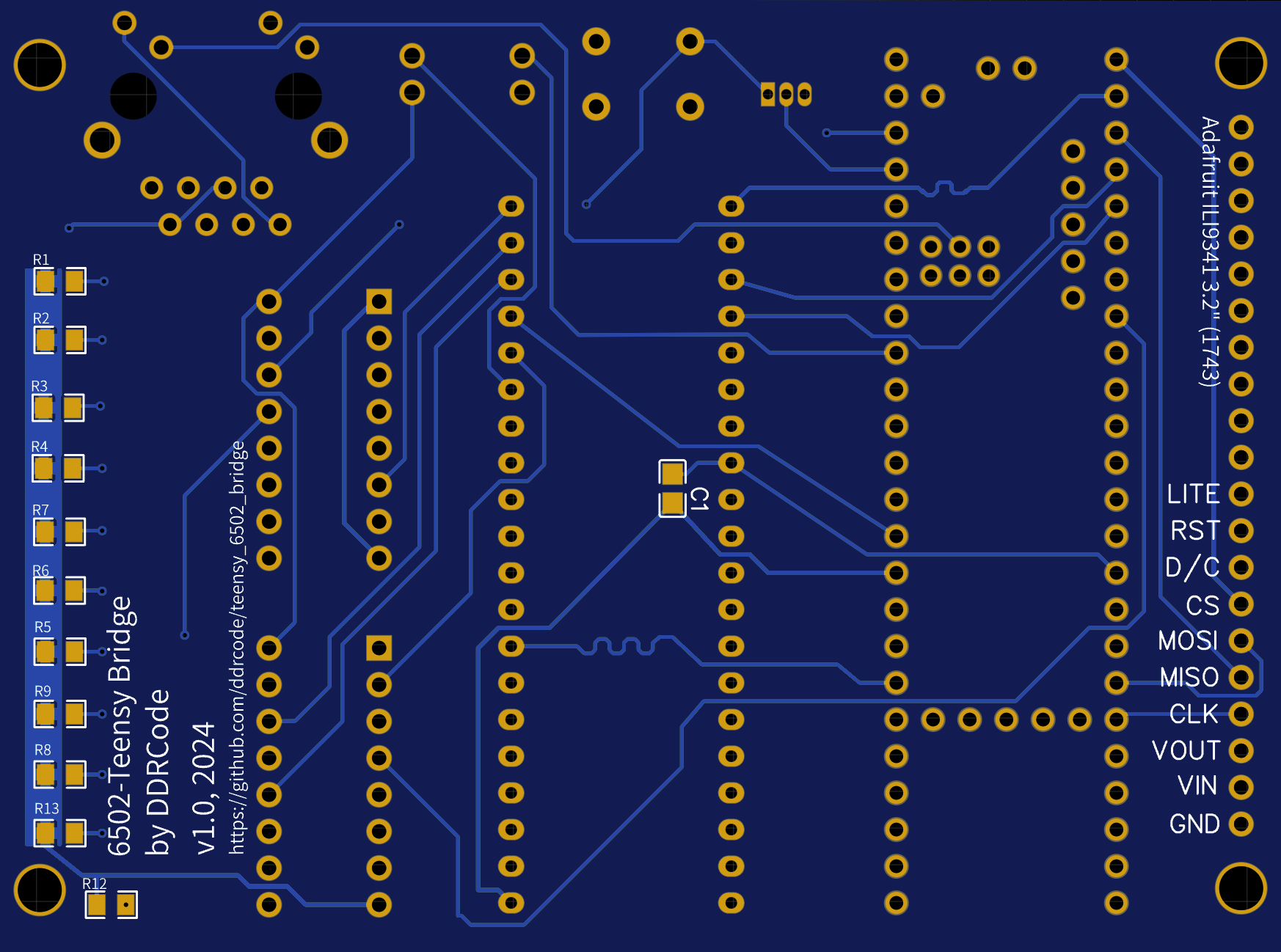

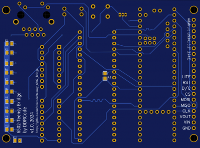

File comment: PCB - bottom view
File comment: PCB - top view

Something I see is the use of the PHI2/PHI1 output pins from the WDC65C02S, those aren't really guaranteed to be accurate any longer according to the datasheets. If you want/need an inverse clock the way I like to do is is to put a 74xx74 off of an oscillator and use the Q/Q' to derive PHI2 and PHI1. (Or you could have the Teensy do it internally seeing as it looks like that's what you're using to generate your clock signal.)
Something of note, though not really critical, I have successfully put the ILI9341 right on the 6502's bus using the 8-bit interface. The board is doing a constant output though, so you'll need an extra line driver (e.g. 74HC245) to give you a floating state when the device isn't being accessed. (I can post a schematic if anyone is interested)
Another thread that might be relevant to your interests is the one on Single stepping with RDY

I’m not able to read your schematic, but in examining the PCB layout I will mention that the 65C816 is not quite electrically interchangeable with the 65C02.  Best if you go over the pinouts on the respective data sheets and note the differences.  Some jumpers can be used to make the board work with either MPU.
Also, the bus cycle with the 65C816 is different than that of the 65C02 during Ø2 low.  Your chip select logic may need to reflect this.

I can’t read your schematic, so I’m not able to offer much advice on the electrical end of things
What's actually the issue with the schematic - it doesn't open for you, or is too small and not readable? Could you try this link instead?
In the DIP packages, pin 3 on the 65C02 is PHI1O—an output, but is ABORT on the 65C816—an input that must be driven high if unused.  Additionally, pin 7 on the C02 is SYNC, but is VPA on the 816.  Depending on how your glue logic is arranged, you may need VPA to qualify opcode and operand fetch cycles.
I think we have two different things in mind. Your comments would make, naturally, a lot of sense if my board was a computer. But it isn't - it doesn't have ROM, RAM or even a bus. It's just 40 CPU pins connected to 40 pins of Teensy. Think about a 100% emulated computer, and then a variation of it, where everything apart CPU is emulated - this is the case here. As mentioned in the first post in the thread, I've designed this board mainly for debugging purposes. I implemented an emulator, and to be sure that it's cycle-accurate with a real hardware, I want to run it in parallel with the actual CPU and compare, for every cycle, the state of all inputs and outputs. Means everything besides CPU is emulated - the memory, the bus, I/O. The emulation doesn't even run on Teensy, but on my host computer. This is why a call the project a "Bridge" as Teensy only acts the role of connecting my main machine with the processor via serial or Ethernet (you can find the implementation of that bridge on my Github if you're interested). In such approach I have full control over all processor inputs, and can - programmatically - respond to all outputs. So handling cases like VDA and VPA being low is not a problem. I don't think the board itself needs to have anything specific for that case, even a DIP switch for switching me between '02 and '816. It's just a matter of using a dedicated software/configuration for one processor or another. If I am wrong, I'd need to understand why...
As mentioned above, I made an exception (a DIP switch) for pin 35. The datasheet for W65C02 states it should be kept unconnected, while on W65C816 it's an emulation pin (M). So the switch actually either connects the pin with my Teensy or keeps the pin floating. There were some debates on this Forum that keeping that pin pulled low (or high) should be absolutely safe, but I decided to take this approach. For all other pins I decide on software level whether they are inputs or outputs and what's their meaning. Hope that makes sense.

The issue is probably the color. Just export it as a black&white PDF and it should be fine. Though BDD could've specified that himself :p

Some points that haven't been addressed:
I assume the wiggles in many of the tracks are to keep their lengths equal. That's not necessary. The difference in length will be an insignificant fraction of the clock period. The only place I'd keep the wiggles is on the differential pairs to the ethernet connector (it might not be necessary there either, but I don't have sufficient experience with ethernet to know for sure).
You're turning the LEDs off by disconnecting the 368's power. That will end up with it, and the LEDs being powered by any of the inputs that happen to be high, through the protection diodes. It won't reliably turn the LEDs off and might damage the chip. Output enable is the method to use here. The LEDs don't care if their anodes are floating - they're not like CMOS inputs.
Yes I wanted to equal the length of the tracks, et least the important ones. Thanks a lot for your remarks.
Thanks a lot for that comment - makes a lot of sense. Funny enough that was my original design (with output enable), so a little bit of work to redo now on PCB :-) I've attached an updated schematic - DIP switch driving OE# and a pullup resistor.
