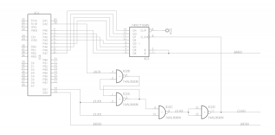

PostPosted: Sun Feb 18, 2024 12:12 pm
Posts: 1043
I tried to understand it and I think this is a really nice approach!
Let me know if I got it right in the attached picture.
It has to rely on that the last clock transition is ignored by the device, although one could - and probably has to - do the the /M0res for every byte anyway.
Combine that with an inbound shift register connected to port A, use CA2 as pulse mode handshake when reading PA and use it as /M0res, and this is a really minimal solution!
I really like it!

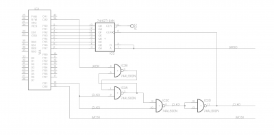

PostPosted: Sun Feb 18, 2024 12:33 pm
Posts: 1043
Summarizing the thoughts here...
What do you think?
PostPosted: Sun Feb 18, 2024 12:51 pm
Posts: 1043
Of course I got the bit order wrong... SPI Default is MSB first.
Edit: just for completeness, and to be able to link to this post and have a basically complete description, here is a short description how to set it up:
Setup:
1) set the VIA T2 to the right speed you want to use (or ignore this if you want to go with Phi2 clock source, which is the fastest)
2) set the SR enabled and input from either T2 or Phi2 clock
3) set Port A into handshake mode, so that it outputs a single low pulse on CA2 when PA is read or written
for each set of bytes (just in case):
1) send a pulse on /ACK by reading PA (e.g. with BIT, so no register is needed)
for each byte:
2) write output data to SR
3) wait until data is shifted out, either counting clock cycles, or looking at IFR for SR done
4) read the data from PA (which automatically sends an /ACK pulse)
5) if more data is to be transferred, go back to 2)
Using phi2 as clock source, each bit uses 4 phi2 clock cycles, totaling in 24 cycles per byte direct transfer. Add the processing overhead to that.
You can interleave processing and transferring: once a byte has been read from the PA, you can already store a value in the SR to trigger the next transfer, then process the byte received while the next transfer is ongoing.
PostPosted: Sun Feb 18, 2024 2:52 pm
Posts: 217
Yes,
_______...______    __    __    __    __    __    __    __    ___________ SPI_CLK3
       ...      \__/  \__/  \__/  \__/  \__/  \__/  \__/  \__/
__    _...________________________________________________________    ____ /Mode0_RST
  \__/ ...                                                        \__/
___    ...          __    __    __    __    __    __    __    _____        SPI_CLK3
   \___..._________/  \__/  \__/  \__/  \__/  \__/  \__/  \__/     \_____
                  _____ _____ _____ _____ _____ _____ _____ _____ SPI_MOSI
                 X  b7 X  b6 X  b5 X  b4 X  b3 X  b2 X  b1 X  b0 X
The /Mode0_RST needs to be applied prior to the first byte and then following each byte,.
The /SPI_CLK0 line should be idle low before the /SPI_SELECT line is asserted low, so select should include a dummy read before pulling the select line down, but a dummy read would be faster than cycling a PortB pin down then up.
The last (bit0) Mode0 serial clock cycle in this approach is asymmetric, but since SPI is a patient protocol and the asymmetry involves a clock stretch, that should be OK.
I'm thinking that using a Read handshake to trigger /Mode0_RST would work for your circuit, since your MOSI SSR is the VIA SSR, which is Mode3, and your MISO SSR is intrinsically Mode0/Mode3, so the trailing downward clock cycle is only needed for the servant device on the other side of the SPI bus, which is what is making it a Mode0-only servant.
