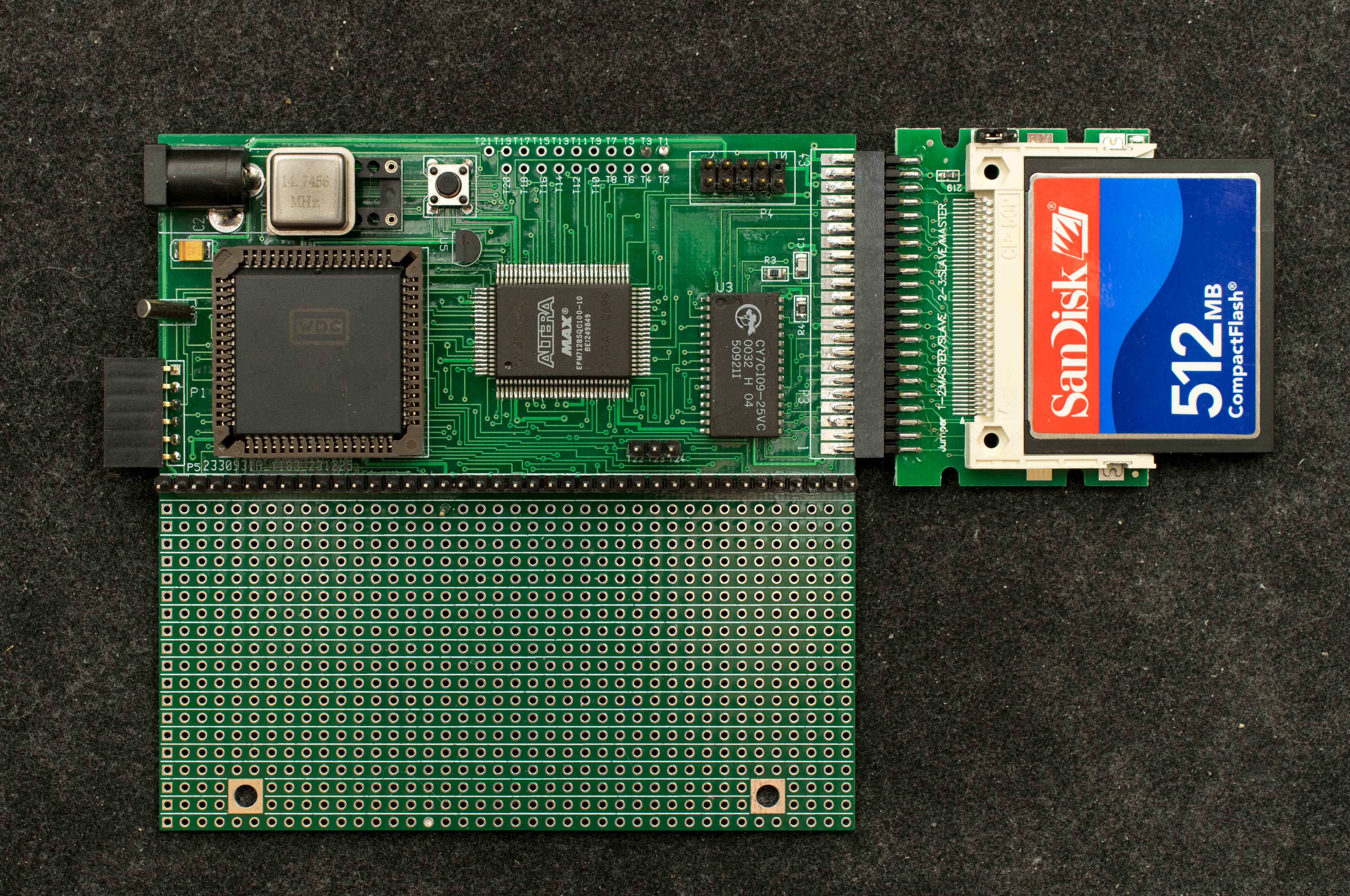

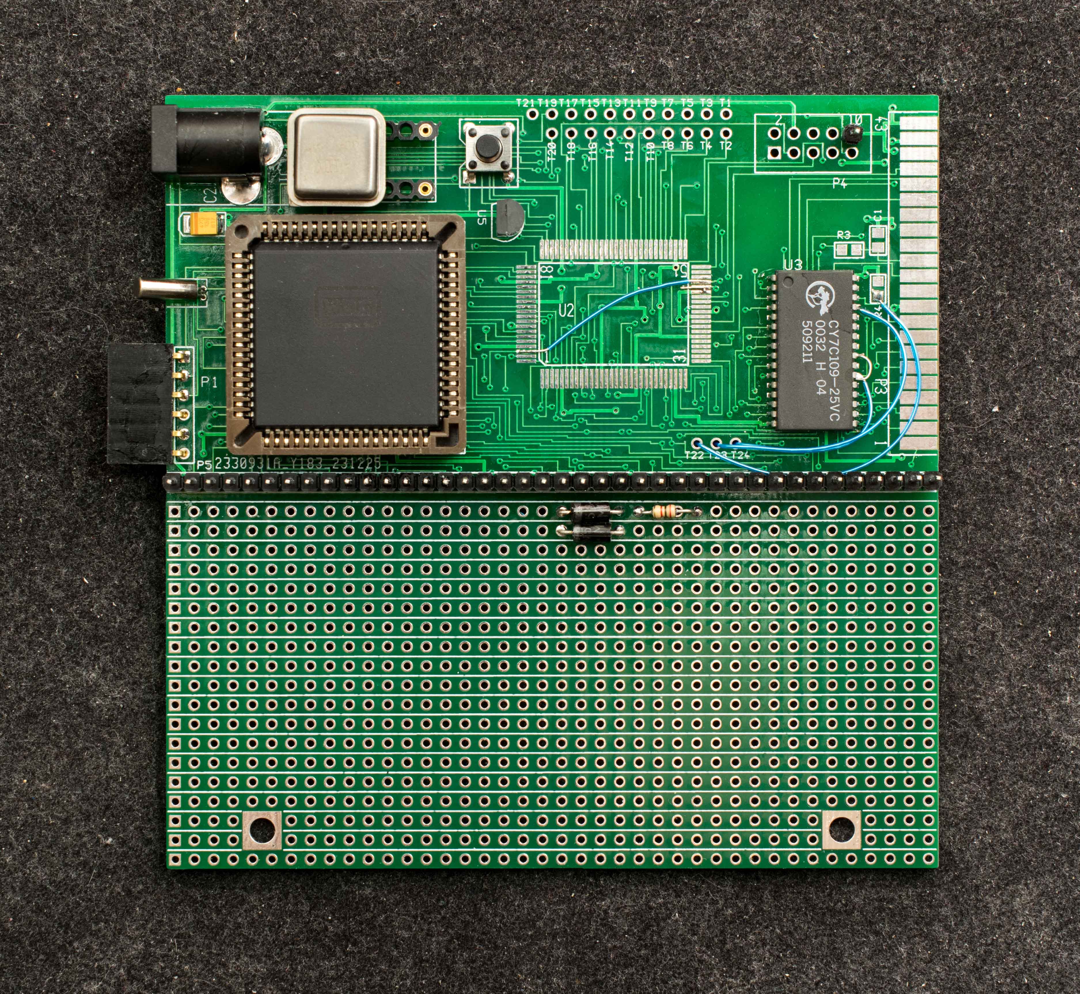

I purchased two W65C134S8PLG-14 to find out whether it can run 14MHz or more. This is a test board for it. It is W65C134 surrounded by a CPLD and an external RAM. I'll start off with configuration similar to W65C134SXB, the evaluation board from Western Design. I see whether it will boot by itself first then go from there.

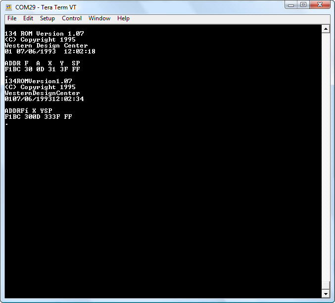

So I tried 3.68MHz and see the sign-on message at 14400 bps. Then I tried 14.7MHz and see the same sign-on at 57600 bps, then I tried 16MHz and see somewhat corrupted sign-on at 57600 (16MHz translate to 62700bps, about 8.8% error from 57600, so that's about right). It won't boot at 18.432MHz. So I guess the top frequency running with internal flash is about 16MHz.
Good to see one going, but ... Hm. Odd.
At boot-time the internal ROM tries to calculate the main clock speed then uses a look-up table to set the baud rate. It knows about these speeds:
558 00:0086 SPEED .ds 1      ;MAIN XTAL SPEED
559            ;0 = 2.000000MHZ
560            ;1 = 4.000000MHZ
561            ;2 = 2.457600MHZ
562            ;3 = 3.686400MHZ
563            ;4 = 1.843200MHZ
564            ;5 = 4.914 MHZ
Any xtal speed outside this will/should result in garbage... But it's most odd that you get 14400 with the 3.6864 Mhz oscillator.
The code sets a timer going on the 32K crystal then runs software loop and uses the count from the loop to index a table with a set of pre-computed values for the loop time it then uses this idex to get one of those values which is then uses to index into a set of tables to get the values to put into the timer that controls the ACIA.
If it doesn't find a match then it assumes it has a 2.4576 Mhz crystal.
That may explain why you get 14400 baud - that's 1.5 * 9600 and 2.4576 * 1.5 is 3.6864 so somehow it's not able to detect the frequency and defaulting to speed 2.

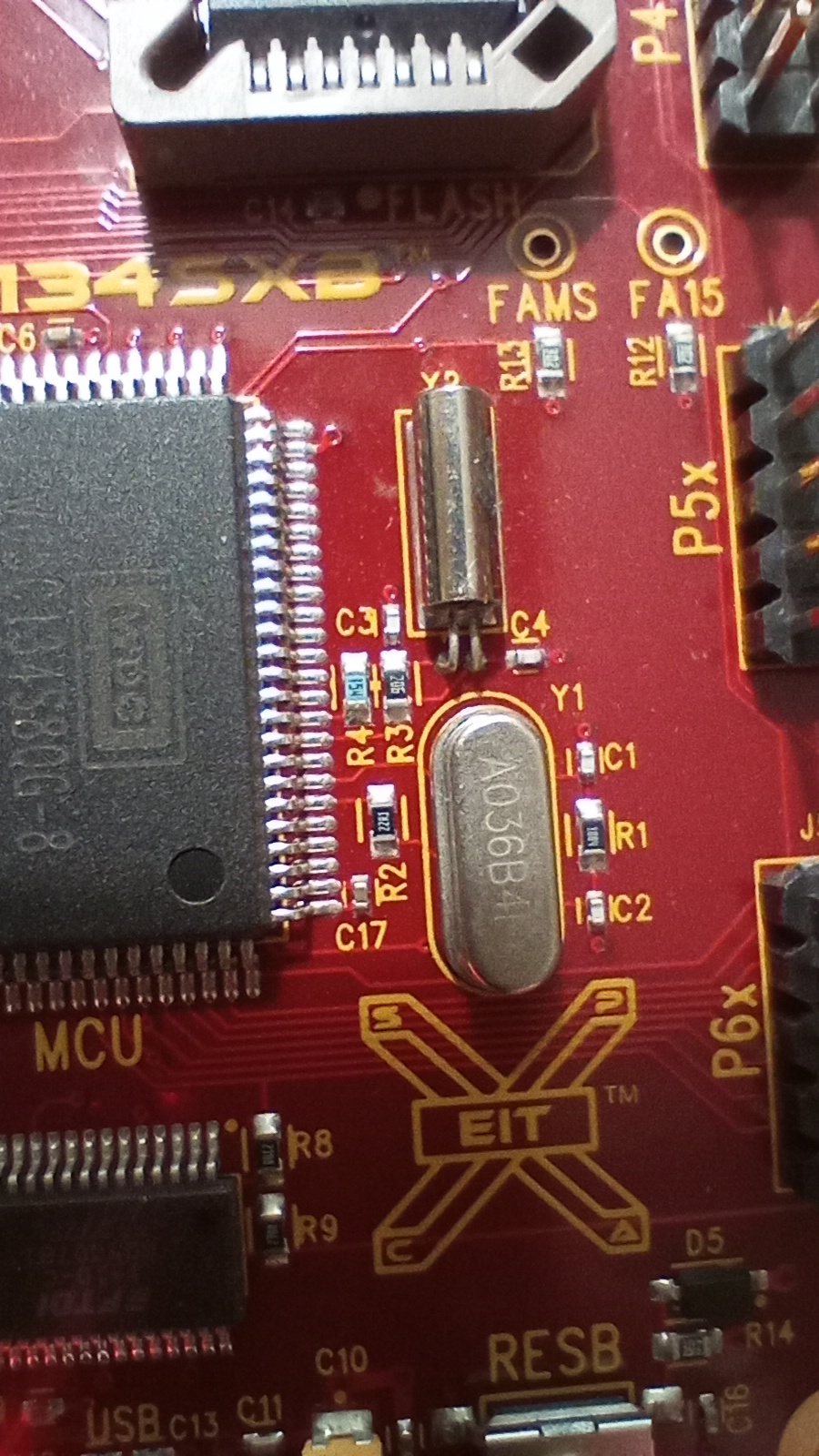

The 32K xtal you have - is it actually running? I don't see the load resistors or capacitors there... It must be doing something as it's required to boot the internal ROM, but at what frequency?

Posts: 1076
I can measure 32.8KHz at the CLKOB output with scope, but I've notice the crystal needs a few seconds to reach stable frequency. That probably screwed up the initial ACIA calculation. However, manual reset after the crystal has stabilized still resulted in the initial 14400 bps solution. I've designed the 32.768KHz circuit based on W65C134 databook, but now I noticed the SXB board design is different than the databook. There may be sufficient differences in the 32.768KHz designs to cause calibration problems. I'm settling down to 14.7MHz operation which has 57.6K serial communication that's sufficiently fast.
My original plan was to abandon the on-chip ROM and use compact flash to bootstrap to external 128K RAM with four 32K banks, so I've not studied the SXB design. Now it boots with internal ROM, I'll work with it to get familiar with the internals of 65134, but that's just a stepping stone to the external memory solution.
Edit: measured the time against a kitchen timer over a minute. It is too slow by about 7%, so that's the reason for failed ACIA calibration. The crystal circuit needs an exclusion zone all around.

Here is a close-up of the WDC65c134-sxb board - not sure it helps though:

It is my fault. crystal is high impedance and drive circuit is typically 100K or greater so it is susceptible to noise. The design normally calls for ground plane or exclusion zone around the circuitry. Well, I didn't do the shielding and that's why it is so badly off.
An update on the oscillator circuit. I know, through actual experiences, that it is important to shield the 32768 crystal circuit of DS1302 real-time clock or else the clock will drift significantly. However, the drift is in the order of 1%, so 7% for 65134's oscillator seems way off. There are two address lines running next to the oscillator so I cut off both lines and rerouted them. That made absolutely no difference in oscillator drift!
After good bits of cursing and hand wringing, I discovered I've made two mistakes in silk screen of the resistor/capacitor so they are swapped. It is a miracle the crystal even oscillate at any frequency! Fixed the mistakes and the clock is now accurate over a 4-minute interval. The serial port now boot to 9600 bps with 3.68MHz clock.

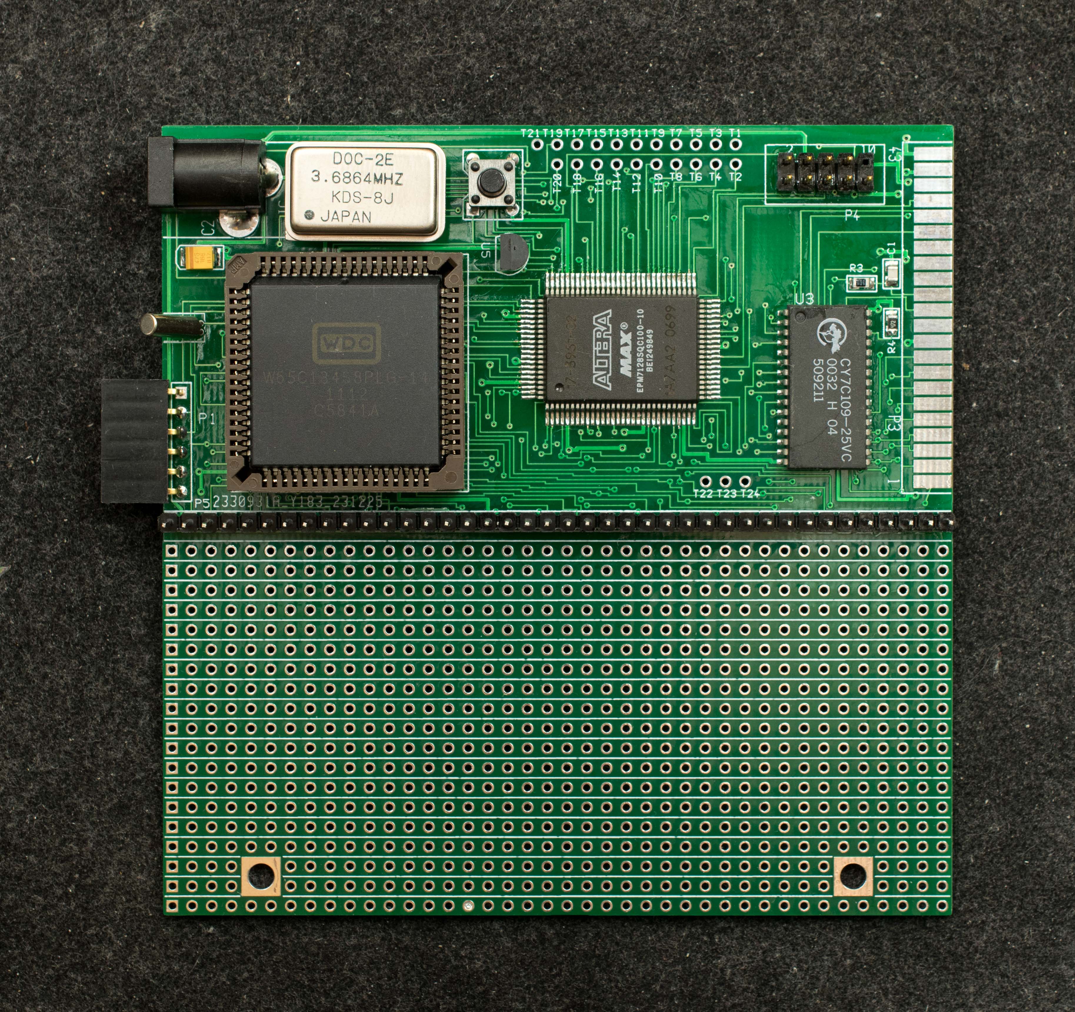

After playing with 65134 a bit, I like it. It is 65C02 capable of 14MHz operation (I clocked it at 14.7MHz); it has a serial port, 4 timers and large number of discrete I/O. It is like 65C02+6551+2x6522+4K_ROM. My prototype board surrounded the 65134 with a CPLD which is an overkill. I built another board without CPLD and wired in (without glue logic) 32K RAM from $100-$7FFF using 65134's chip_select_6 as RAM decode. Alternatively with a 64K RAM and a OR-gate combining chip_select 6 and 7, it can have RAM from $100-$FFFF. This is makes an I/O-rich, simple and fast 6502 computer for experimentation.

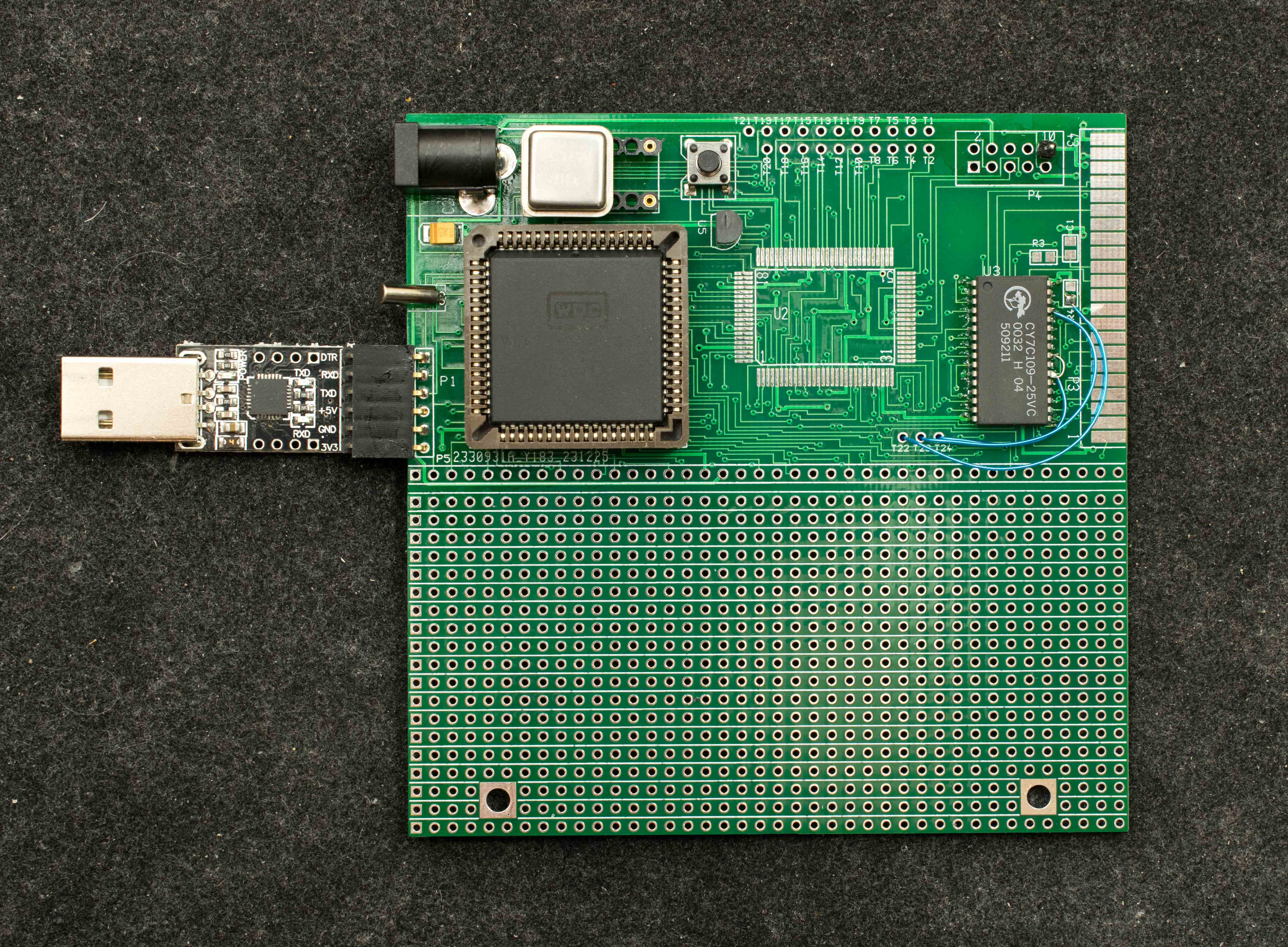

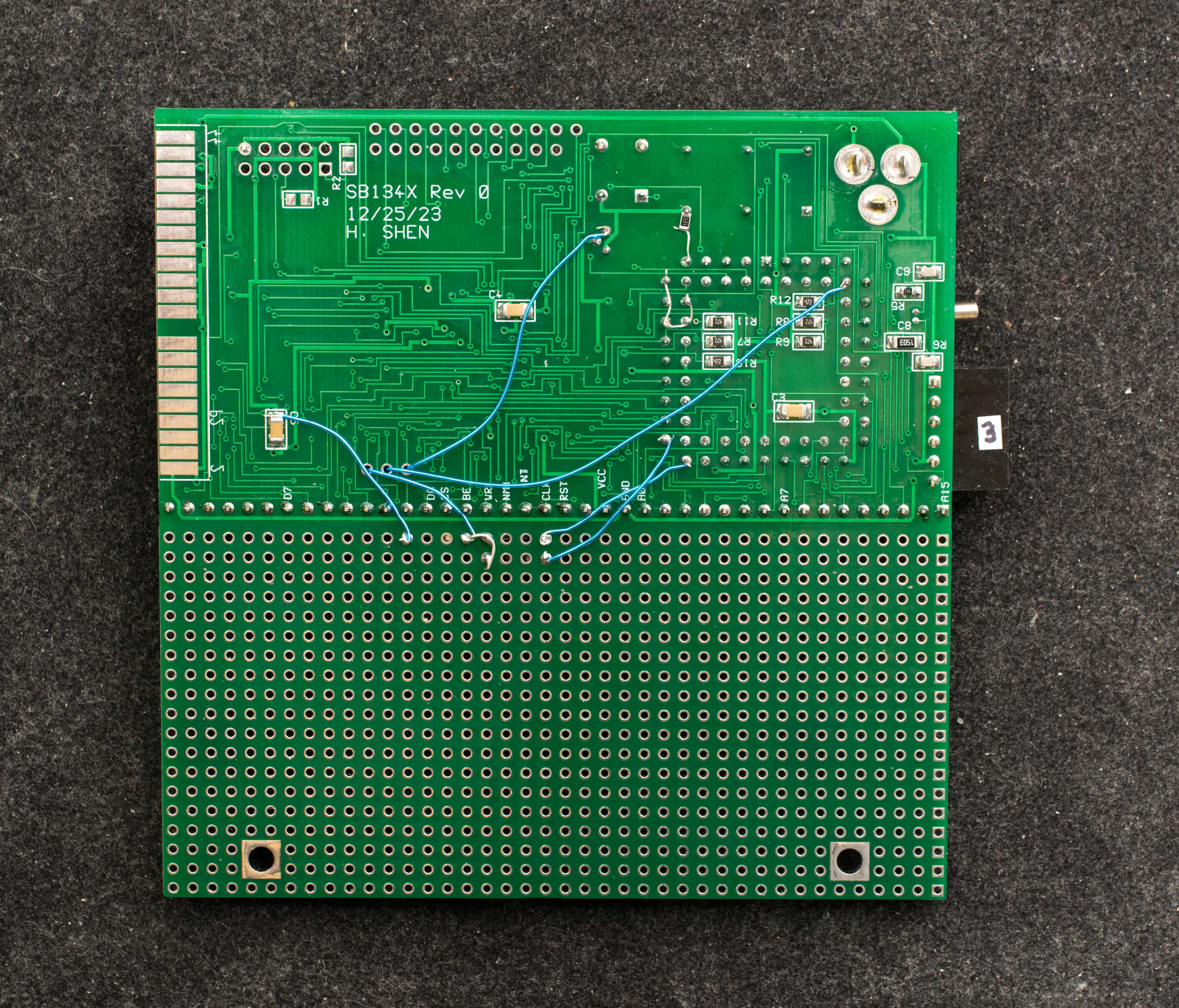

What I'm settling down is a simpler W65C134 design without CPLD and CF. It has an OR-gate implemented with 2 Schottky diodes and a resistor. One input of OR is 65134's chip_select_7 and other input is chip_select_6 so that maps memory $100-$FFFF to RAM. RAM's active high chip select is wired to voltage supervisor so RAM is write-protected when voltage dropped below 4.5V.
The approach is using the factory ROM to load the new monitor into RAM. Write "WDC " to $8000 to disable factory ROM. RAM contents should be protected from corruption during reset or brief power cycling, but there will be a checksum routine to verify. The new monitor is the active monitor but need to be reloaded after a complete power cycle or when the application program trashed the monitor.
The approach is not very different than the factory 65134SXB board, but this has more RAM and higher 14MHz operation.
