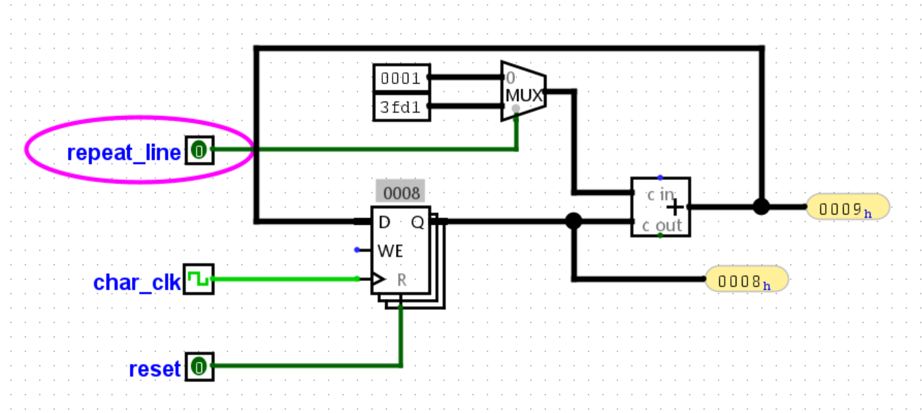

PostPosted: Wed Nov 15, 2023 11:36 am
Posts: 988
Here's a first thought on a line doubling system.
If repeat_line is high, the count subtracts 0x0030, otherwise it adds 0x0001. Still need to think about the logic of ensuring that repeat_line only holds for one clock every second line, but the concept is there.

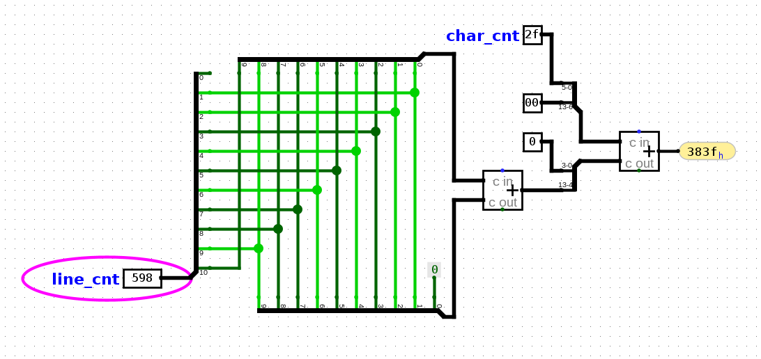

PostPosted: Wed Nov 15, 2023 8:39 pm
Posts: 988
Here's another thought: it takes six four-bit adders, though, and the line counter on top of that (both it at the one above still need character counters) but it's perhaps conceptually a bit simpler if less flexible: the left hand adder multiplies the line count divided by 2, by 3; effectively by 0x30 because the lower four bits are zeroed. The four lowest bits of the count can be supplied directly since they can't affect the higher bits, but sadly the next two bits can, hence the need for two 12-bit adders (aka six 4-bit).
The big advantage is that it doesn't need synchronous counters so I can fit eight bits in a chip.

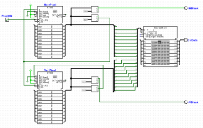

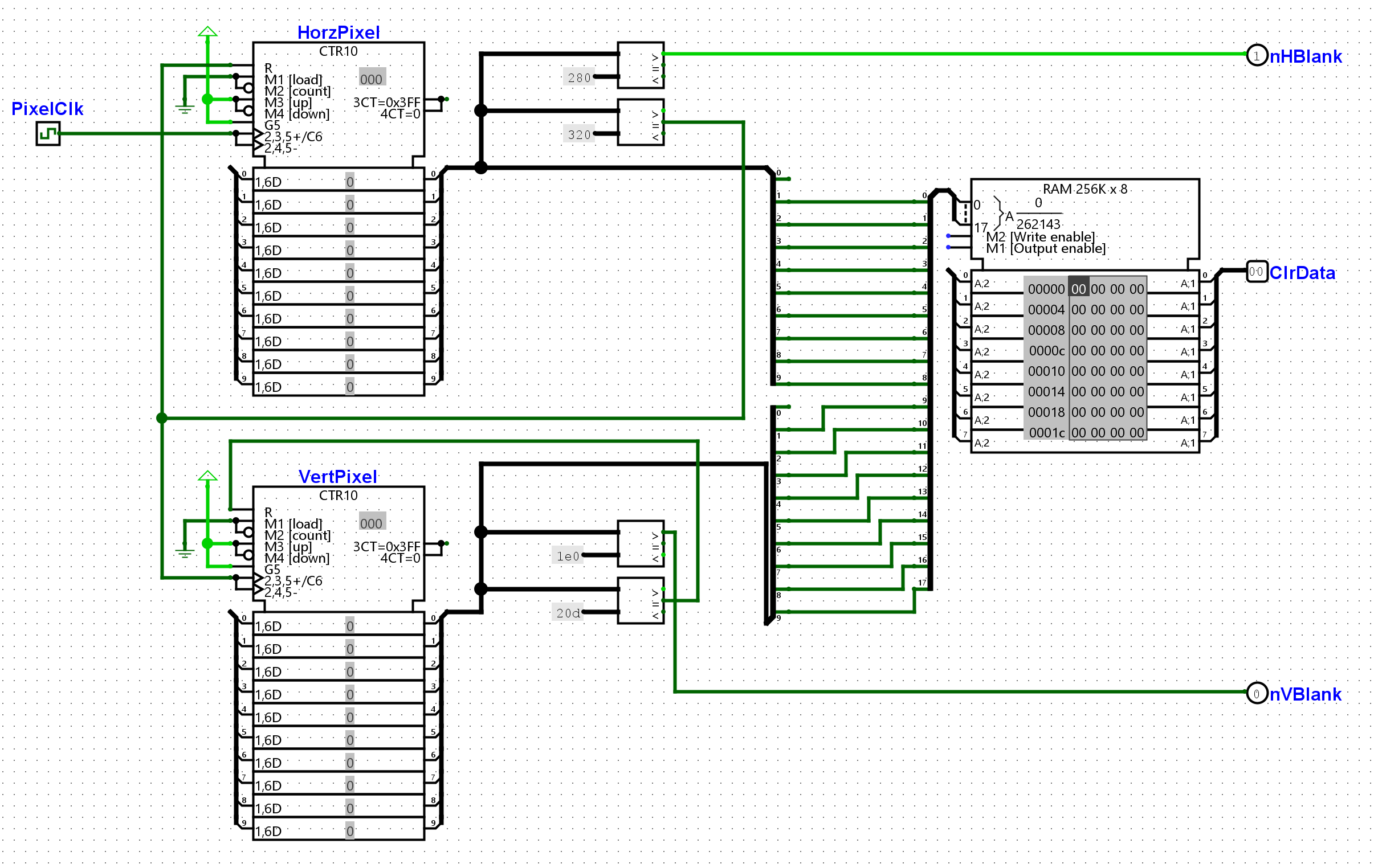

PostPosted: Wed Nov 15, 2023 8:50 pm
Posts: 257
The way I've generally considered to work through this is to have two sets of counters one for the horizontal and one for the vertical.
You'd then pipe in the horizontal counter into a set of address bits in the RAM, and the vertical into the other address bits, dividing the memory up.
This would leave some holes in the RAM, but it seems like it'd make the math easy.

Edit:
Of course reading back I see you want to keep the memory contiguous, so disregard the nut quietly laughing in the corner. He's harmless.
PostPosted: Wed Nov 15, 2023 9:44 pm
Posts: 988
Yeah, that was my first thought, but non-contiguous ram - 64 characters albeit on a 66 cell line would be *easy* - wastes loads of ram, and it's all in tiny chunks that are basically neither use nor ornament.
