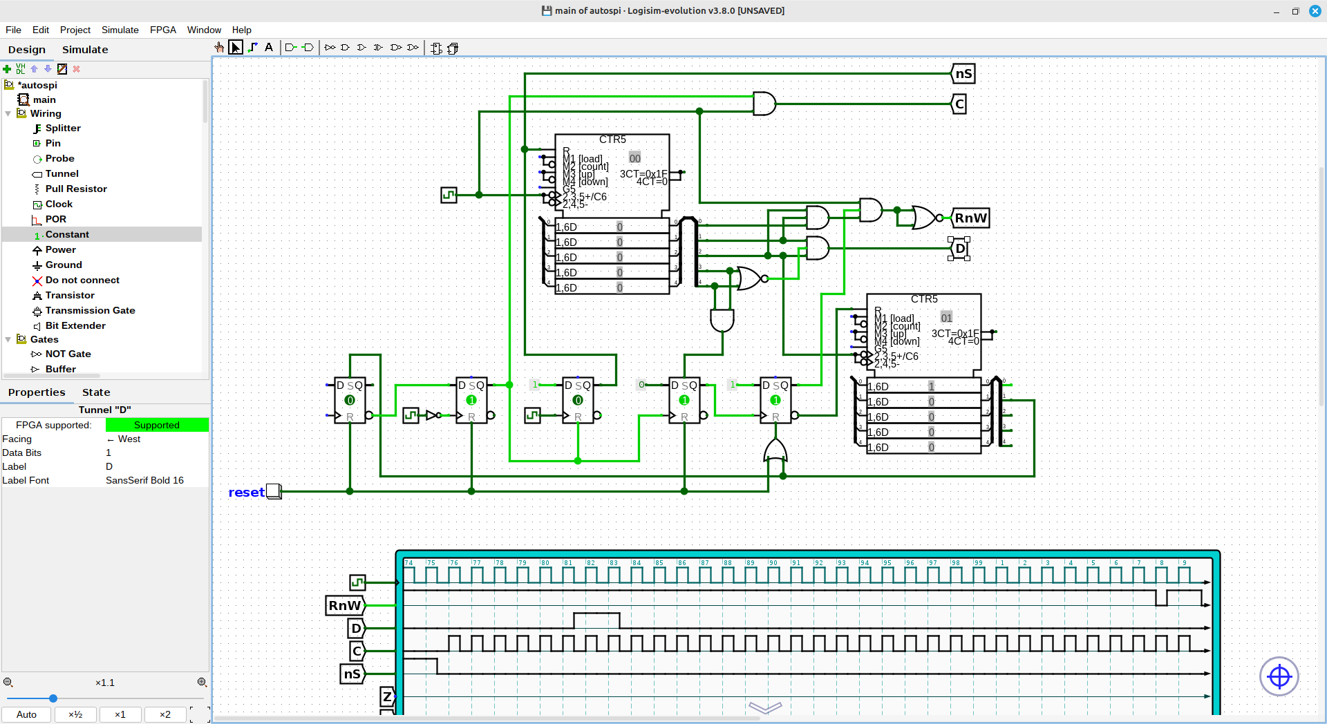

Sorted it, I think. This logic generates the necessary timing and control signals to read a standard up-to 64kB flash/eeprom into memory, including the address generation and an (unshown) hc164-type serial-to-parallel converter.
Both the counters are negative edge triggered (e.g. 393); the top one generates the 0x03 'read' signal followed by three 0x00 (two address bytes, one dummy) and then repeats. After the flash is reading, it ignores further commands so no worries there. It also generates a RnW pulse on the high part of the eighth clock pulse. Its last job is to enable the address counter via the AND gate and the rightmost two flip-flops. If we assume eight clocks to the tick, that first occurs on the fourth tick.
The other counter generates the addresses, having been held in reset until the fourth tick.
A high-going reset pulse resets most of the flip-flops (let's call them 1-5 from the left). At the end of the reset pulse, the next clock latches Q(2) high. That resets Q(3) immediately, and half a clock later nS is clocked low. Q(4) is already low from the reset, and this is confirmed by the rising edge of Q(2) - perhaps only one of those is needed, but I don't think it hurts.
On the fourth tick, Q4 is set which enables both the address counter and the clock signal to the flash. Thereafter, every eight clocks, the address counter is incremented and in the half clock before it does, it generates the RnW pulse. When a suitable power-of-two address is reached (I got bored waiting so this one only goes up to two :mrgreen: ) then the high-going next bit triggers a reset to flip-flop(5) and simultaneously sets Q(1). Half a clock later, the nS line goes high and normality is restored.
Next step is to see how few chips I can do this with in discrete logic. The intent is to download into a 65c02 memory space meaning I can use the nS signal to hold the BS and RESET lines low during the transfer. Note that the d-types here differ from a 74hc74 by having active high set and reset inputs; a certain amount of inversion will be required.
I intend to connect to the busses via 47k resistors which should be plenty low enough to provide the necessary drive current for the ram but high enough to provide isolation against the address counter which will remain at 0x0000.
