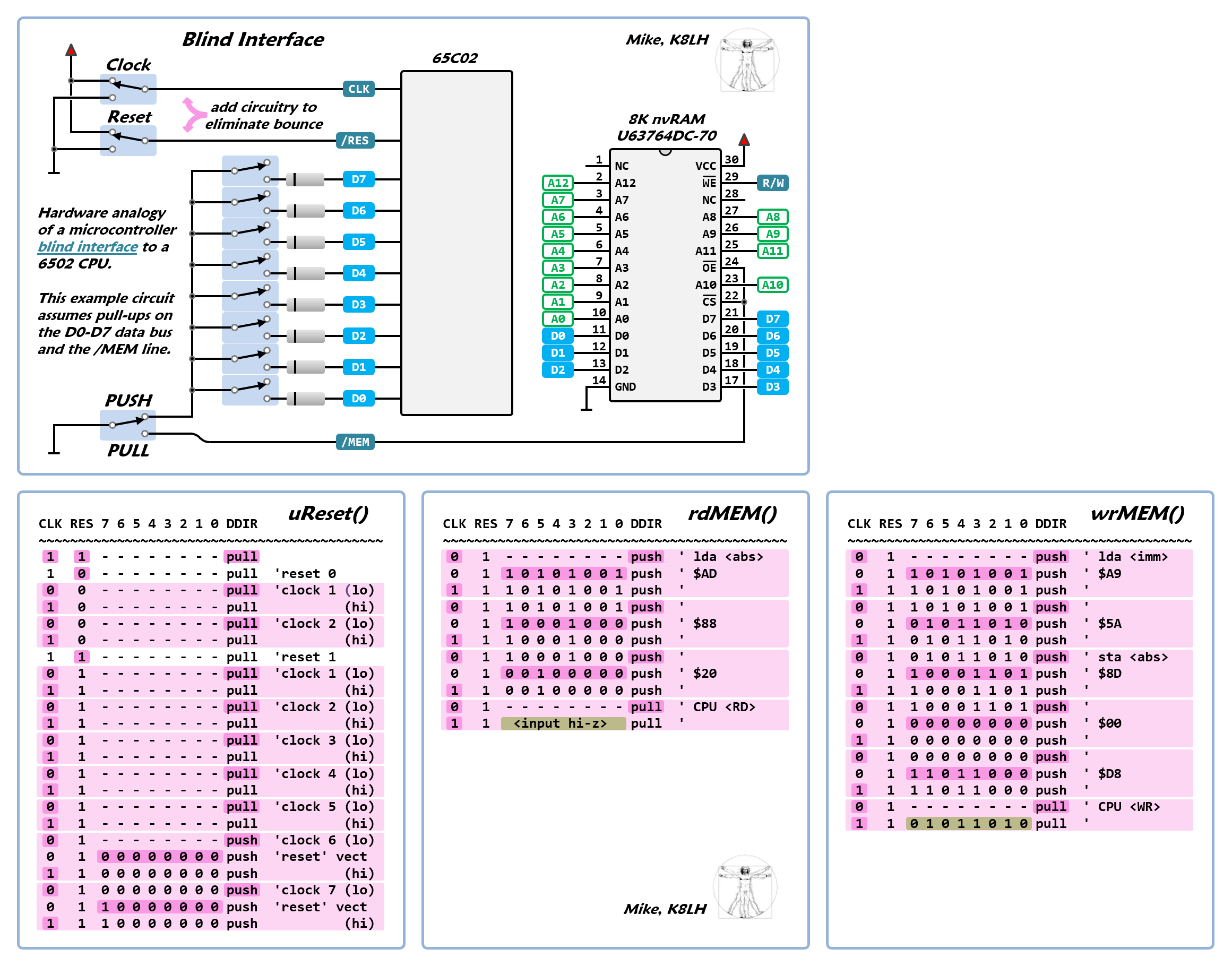

The microcontroller presents to the 6502 as a smart ROM of sorts. It simply provides LDA <imm>, LDA <abs>, STA <abs>, and JMP <abs> instructions while turning on ROM or RAM during the correct cycle within each instruction.
A hardware analogy might look something like the drawing below where you're setting clock and data switches during each half clock cycle to mimick the microcontroller single-cycle Push() and Pull() functions. I'm working on a demo project.

Simply build off of those core functions (loader, programmer, etc.)...
