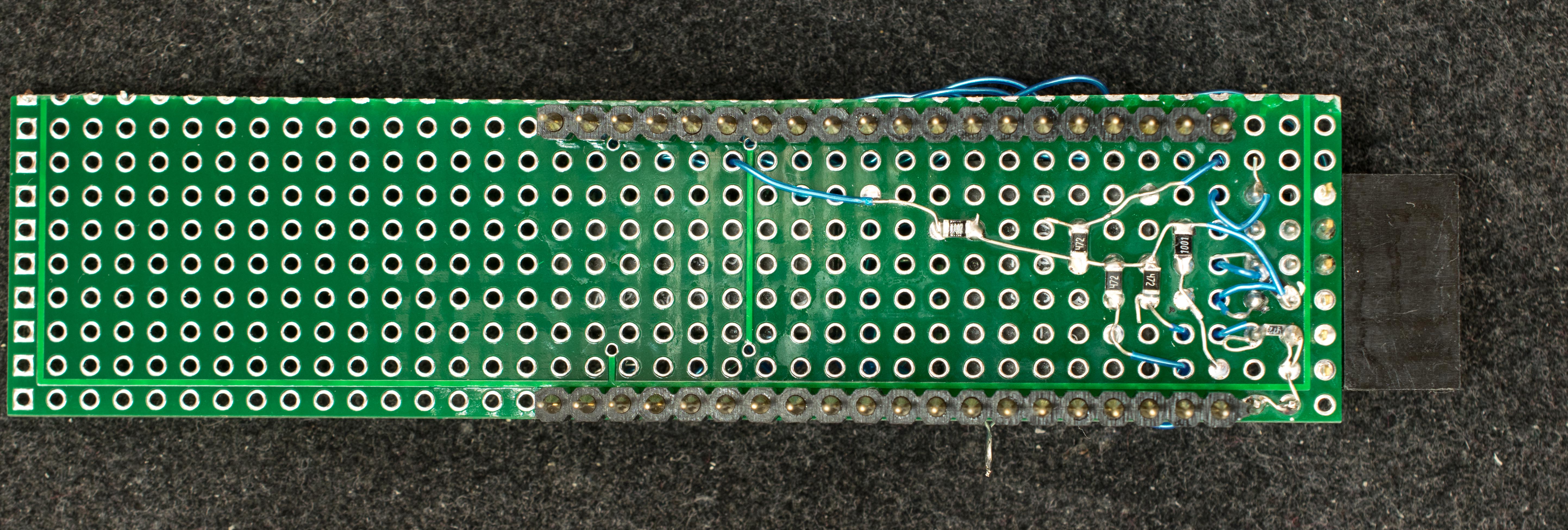

Reading several recent posts about hardware implemented on solderless breadboard spurred me to think about an add-on board that may help the debugging of breadboard hardware. Assuming the breadboard contains a microprocessor in 600-mil DIP package such as 6502, Z80, 6809, etc, the basic idea is a board that stacks over the microprocessor to provides user interface. This board has 2 rows of pins 0.8" wide with pin functions match the target microprocessor. It plugs over the microprocessor and monitor/control the activities of the microprocessor with several modes of operations. This board contains two components, 128K RAM and CPLD, and 2 headers, serial port and JTAG port. Different processors will have different routed add-on board, but the concept is the same.
I'm thinking of 4 different modes of operations depending on how the CPLD is programmed:
1. Enhanced NOP test where a small ROM is programmed in CPLD to bootstrap the processor and perform simple test of the breadboard hardware.
2. Instruction tracing where every instruction executed is output on the serial port. This requires processor to run very slowly but serial port to transmit data at high data rate such as 460K.
3. Instruction logging where processor is running at full speed and data is saved in RAM.
4. Functioning computer where processor with RAM+CPLD forms a simple computer that can load and run program through serial port.
Mode 1 is easy to do because CPLD can be programmed with 64-128 bytes of ROM data; mode 2 was done for RC2014 Z80 where Z80 clock is 10KHz and address/data are send out serially at 460K. With hoglet's 6502 instruction decoder the CPU clock maybe 3 times higher; mode 3 hasn't been done (by me) so it is an unknown; mode 4 is basically CRC65 design but without compact disk interface.
Solderless breadboard have 5 rows of connections on each side so two rows at 0.8" spacing plugged over 0.6" DIP allow one row of solderless connections at one side and two rows of connections at the other side. The 0.8" wide footprint is sufficient to accommodate hand-wired SOJ RAM and PLCC44 CPLD. For PC board, the row spacing needs to be 0.9" to accommodate PLCC44 or 100-pin QFP.

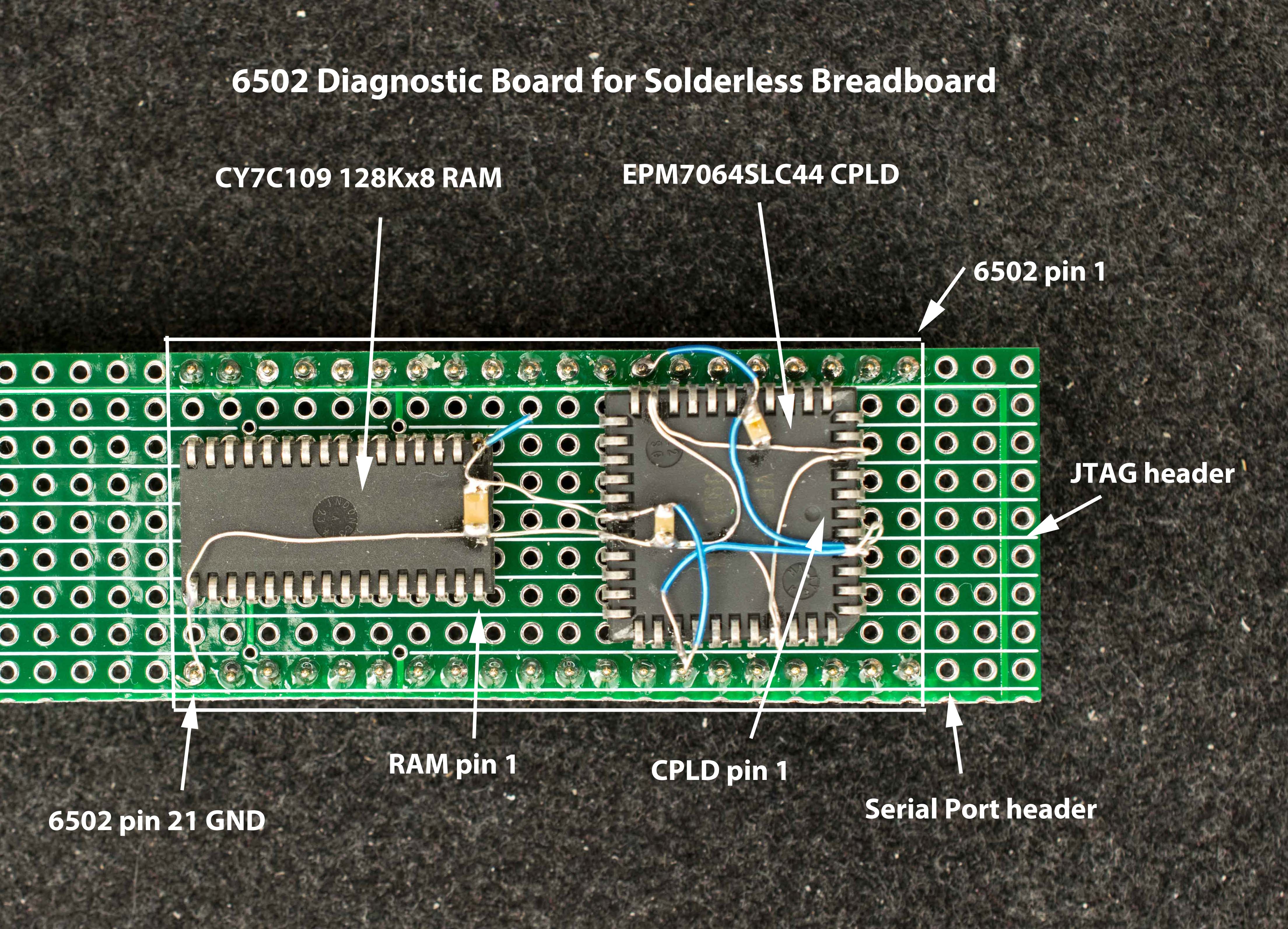

To check out the concept, I have started building a prototype board mounting SOJ RAM and PLCC44 CPLD in "dead bug" fashion on perf board. The two rows of pins are 0.8" wide. The CPLD is pre-programmed with CRC65 equations and the schematic is based on CRC65.
I've layout the ground/VCC and connected up the clock and 8 data line. While I enjoy building hardware, this prototype effort is tedious and I can only do a dozen or so connections before the fun ran out. I'm stopping tonight to write down my work so far. To be continued.

Nice idea. Be aware that it can be quite awkward fitting all the wires in around a 0.6" part, especially for the buses which might go to multiple destinations. Only having one row of pins on one side will make that harder.
I see that the CPLD's size forces this width - but I wonder if it's possible to fit pin headers or sockets to the board to allow connecting wires that don't fit in any more? Or maybe a mezzanine board above it with extra breakout pins or sockets?

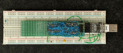

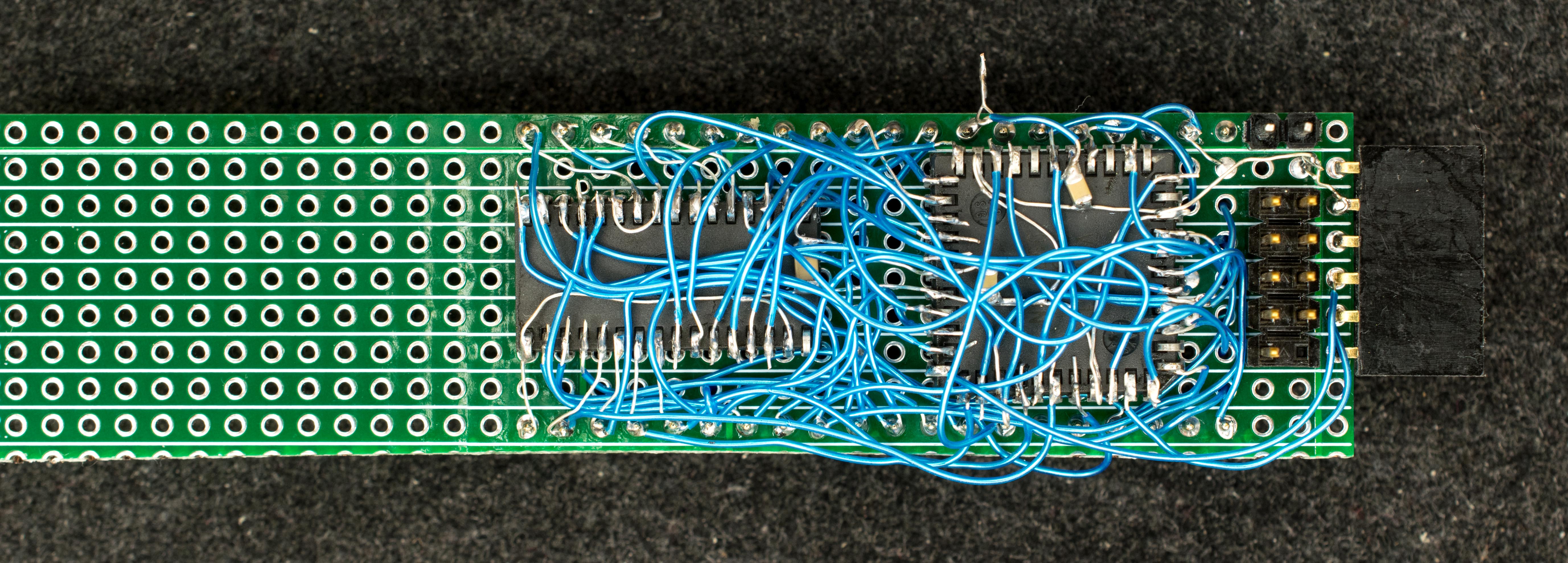

I completed the wiring of the diagnostic prototype. It is quite dense and tedious to wire. (I don't think I'll do wired prototype for Z80 version) There are several pull up resistors at the back for RDY, NMI, IRQ, SOB, etc. Powering it up by itself, the current consumption looks reasonable. I'm able to read/verify the pre-programmed CPLD.

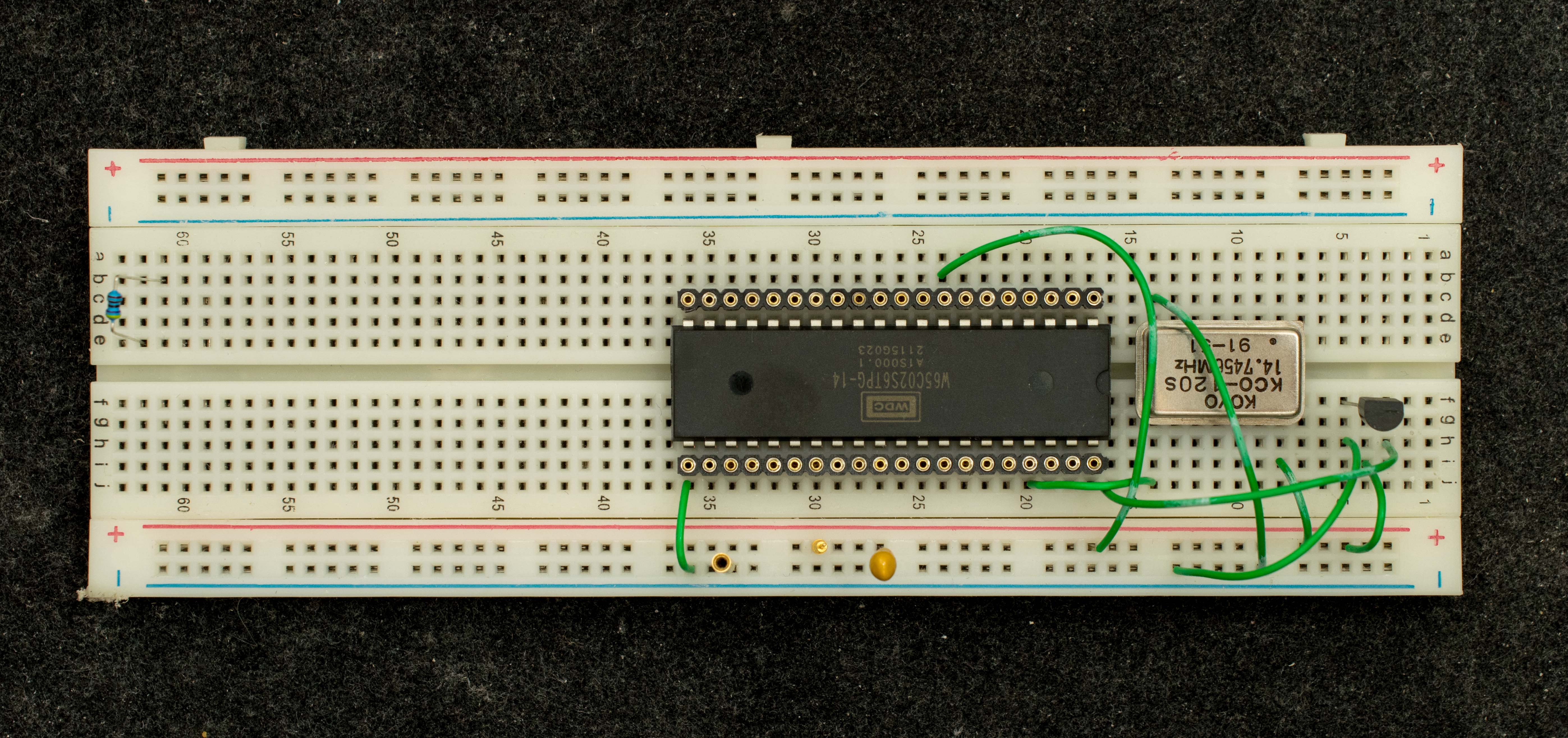

On the solderless breadboard, I have 6502, oscillator, and voltage supervisor. I plug in the diagnostic prototype and powered up, no magic smoke escaped. My first attempt is mode 4 operation where 6502 with the diagnostic board should be able to load program through the serial port, but that was not successful. So I'll need to visually inspect all connections. If it passes visual inspection but still not able to run mode 4, I'll need to start with mode 1, writing simple ROM program in CPLD to test 6502 and RAM, another word, using the diagnostic prototype to diagnose itself.

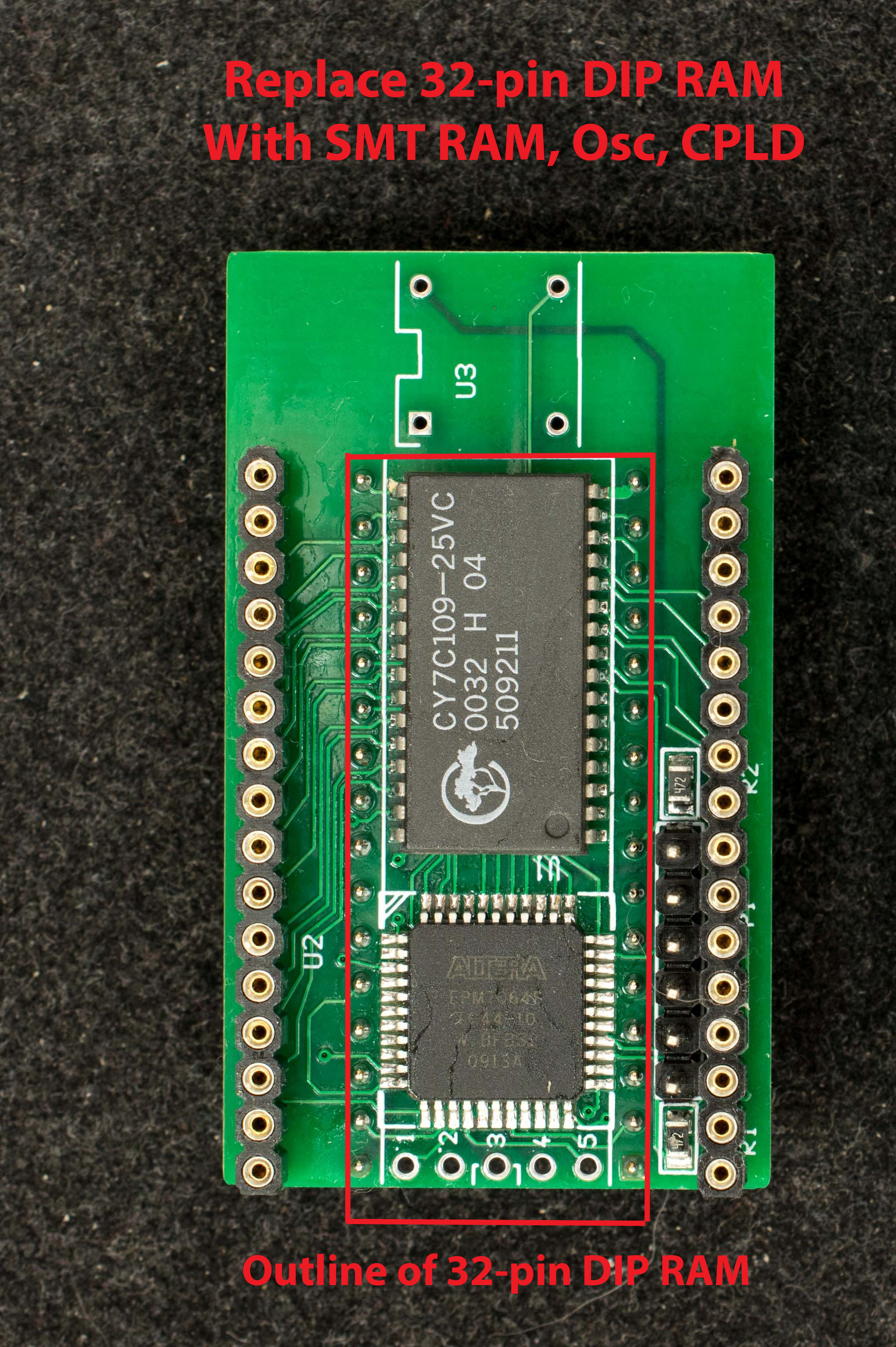

If 44-pin TQFP CPLD is used instead of PLCC44, it is possible to put RAM and CPLD inside 0.6" footprint. The routing is complex and require 4 signal layers. It may be possible to put RAM and CPLD under 40-pin 6502. Samtec makes machined sockets with extra long tails, so 6502 can plug into the sockets then the stacked assembly of 6502+RAM+CPLD with long tails plug into the solderless breadboard.

Sounds like the vertical stacking is plausible then, nice. I've also been looking at those Samtec stacking headers. Looks like Sager has the best price, but I don't have experience buying from them. For SRAM I've got some 512kx8 10ns CY7C1049G-10VXI, which are in SOJ 36 packages that look like they would fit (0.44mm to the outer edge of the pins). I'm looking forward to see how far you get with this -- it will really help with debugging at full clock speed when single stepping is not realistic.

It turns out there was nothing wrong with wiring of the diagnostic prototype; the problem is 6502's BE (pin 36) is not pulled up to VCC. So once BE is pulled up, the board booted and able to load program via serial port. Picture shows the 6502 monitor loaded and ran. It is running with 14.7MHz 6502 clock.

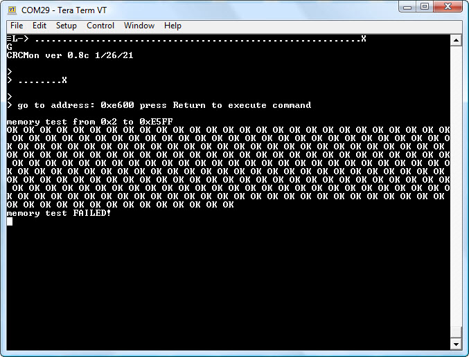

Since the diagnostic prototype + 6502 is small and compact, I thought it may overclock into 20+Mhz even though power/ground distribution is poor. It is easy to double the clock to 29.5MHz and run serial port at 230K without changing the CPLD design so that's what I tried. At 29.5MHz, it doesn't quite work at nominal 5V voltage, but when I cranked up the voltage to 5.4V, it will boot and pass memory diagnostic, most of the time. Here is a case where it failed memory diagnostic. Power consumption at 5.4V running memory diag is 150mA.
29.5MHz is clearly over the edge but the diagnostic board should work well at the nominal 14.7MHz.
Edit: I tried Klaus Dormann's 6502tst and 65C02_extended_opcodes_test at 29.5MHz. They both passed with several repetitions of the tests.

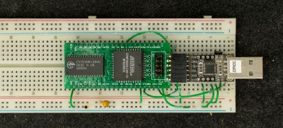

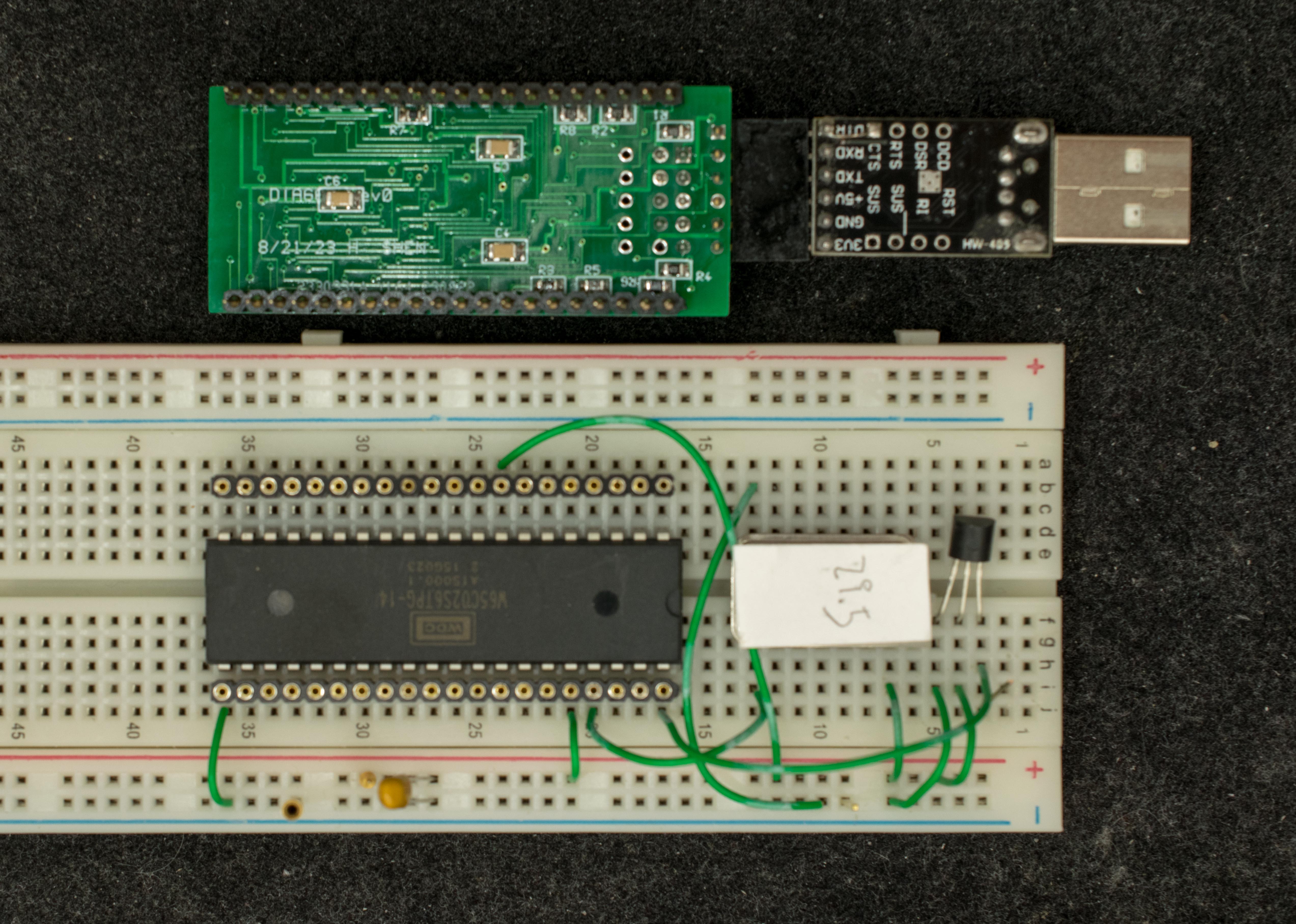

A quick update; this is 2-layer PC board version of the diagnostic prototype.. First photo shows the backside before plugging into the solderless breadboard; 2nd picture shows the diagnostic hat plugging over a W65C02. It works at the nominal 14.7Mhz. It also works at 29.5MHz @5V, room temperature. It may be interesting to see what is its top speed.
Updated schematic is attached.
I also made a pcb version of diagnostic hat for Z80.
