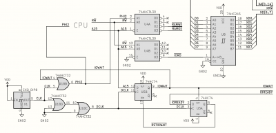

Back on the CPU module, I used discrete logic ICs for clock stretching and high level address decoding, because the propagation delays with AHCT parts seemed lower than the nominal delay of the simple PLDs I'm using:

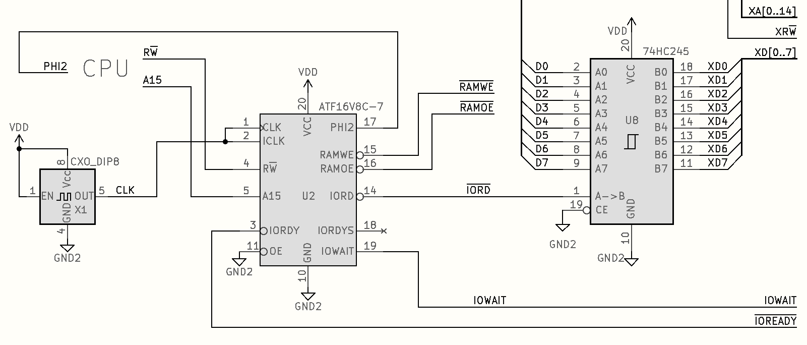

However, in practice the PLDs seem to perform much better than the datasheet would imply, and I'd like to swap out the 74AHCT139, 74AHCT74, and 74ACHT32 for an ATF16V8. That can easily do the same job, should be faster, and will have spare pins for other things:
File comment: Potential PLD-based glue logic design
Potentially I could make this update to the PCB design and fab that as a variant of the CPU module, as it is swappable.
It might also be interesting to make a 4-layer board version of the CPU module and see whether that's able to run any faster than the 2-layer board - again this can just be plugged into the existing I/O module without requiring changes there.

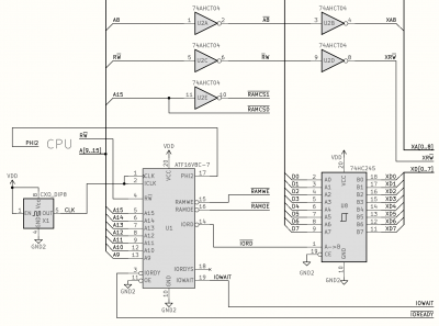

For general system improvement, I'm interested in revisiting the memory map and RAM/ROM split. Currently there's 32K of RAM from $0000-$7FFF, with 32K of ROM from $8000-$FFFF except for the region from $FF00-$FFBF which is decoded for I/O (VIAs, etc). A big disadvantage of this memory map is that in this system any code that runs from ROM is rather slow, as all ROM accesses are cycle-stretched just like I/O is. The plan was to just copy the code to RAM and run it there, especially if it's code that benefits from speed, but it means that half the address space is then lost, and there's only 32K of usable memory. It's OK for a prototype but not so good for general purpose use.
The reason for this memory map, initially, was to minimize the address decoding overhead for the RAM, to allow it to run as quickly as possible. Having one IC always selected achieves that, with initialy address decoding based only on A15 - if A15 is 0, it's a RAM access, otherwise it's either ROM or I/O and needs clock-stretching either way. I'm not able to find the 64MB ICs that Michael uses - 32MB is the only one I find in stock at the usual places, at this speed (~12ns). However I can of course use two of them, with one selected by A15 being low and the other selected by A14 being low and A15 being high, for example. In fact with the glue logic replaced with the PLD, there's enough spare pins to wire through all the address bits from 15 down to 9, and have the PLD decide whether high address space accesses are RAM or I/O/ROM.
File comment: PLD-based design with 64KB RAM
In this case, the PLD would disable RAMOE and RAMWE during I/O access, and the inverters drive the two RAM CS signals regardless of I/O decoding. The other inverters are also acting to buffer A8 and RWB for passing off the board, so I can get rid of the existing transceiver for the high address lines. I could use an ATF 22V10 PLD instead of 16V8, to get more pins and do the inverting in the PLD, but I found in the past that the 22V10s use a lot more current and run a lot warmer, and I didn't like that, so I try to fit things into 16V8s instead now.
This would lead to a memory map with one bank of RAM from $0000-$7FFF, another from $8000-$FDFF, then ROM from $FE00-$FFFF minus the same I/O window as before from $FF00-$FFBF. That is not much ROM but I believe it is enough for an SD card bootloader or something similar. This should be possible to do with changes to the CPU module alone - a new PCB could be fabricated that would plug into the existing I/O module.
I seem to have a spare inverter as well, which could actually be used to still pass A9 to the I/O board in addition to A0-8, allowing twice as much ROM if that turns out to be needed/useful.

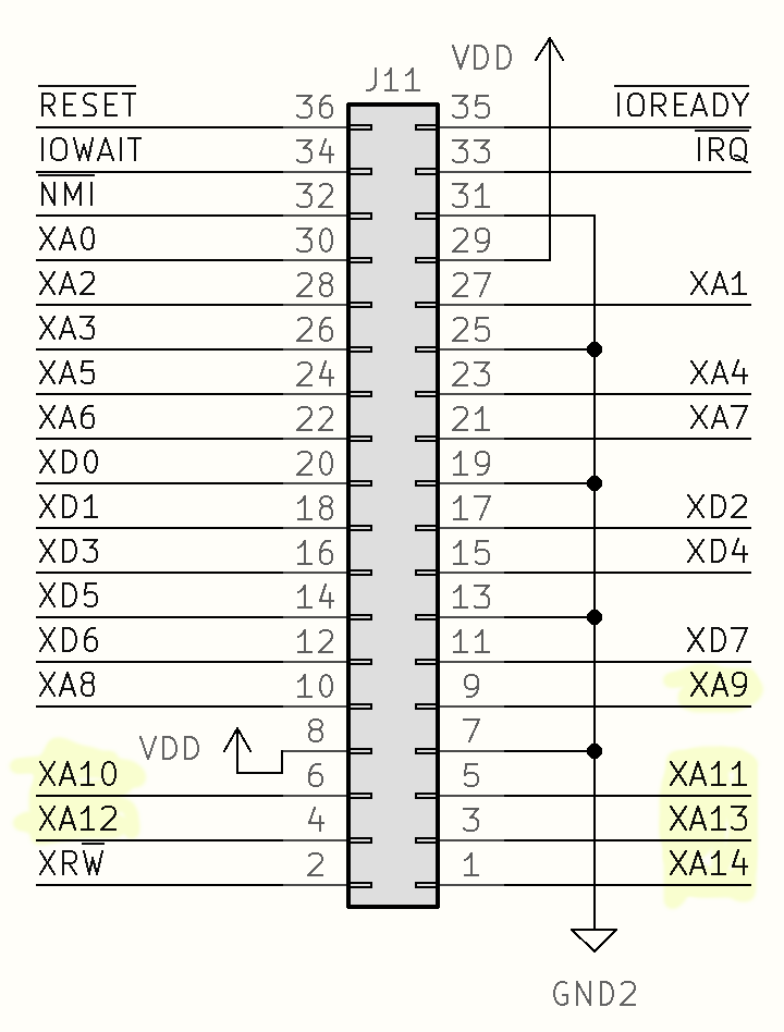

A nice side-effect of this would be that the CPU module no longer needs to send so many address lines to the I/O module. As noted above it saves a transceiver, and also the connector I have between the two is rather overloaded at the moment - it's a 36-pin card edge connection, with 29 data signals and only 7 power/ground lines. Getting rid of 6 address lines will bring it to 23 data signals and 13 power/ground return lines, which is not ideal, but is a better balance.

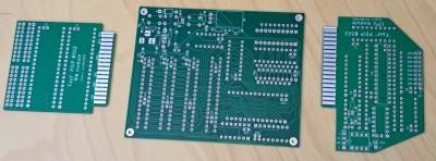

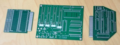

The PCBs arrived today - I have a VIA expansion board on the left, the I/O board in the middle, and a CPU board on the right:
I wasn't sure what to expect from the card edge connections, but they came out well. Crucially, they do fit into the sockets! I'm aware that the tin will get scratched off and connection quality will suffer, but interested to see how much abuse they take before that happens. I asked for a chamfered edge on the cpu board but not the VIA board, to see what the difference was like. I don't think it matters much.
The card edge sockets require a fairly thick board, these are 1.6mm.

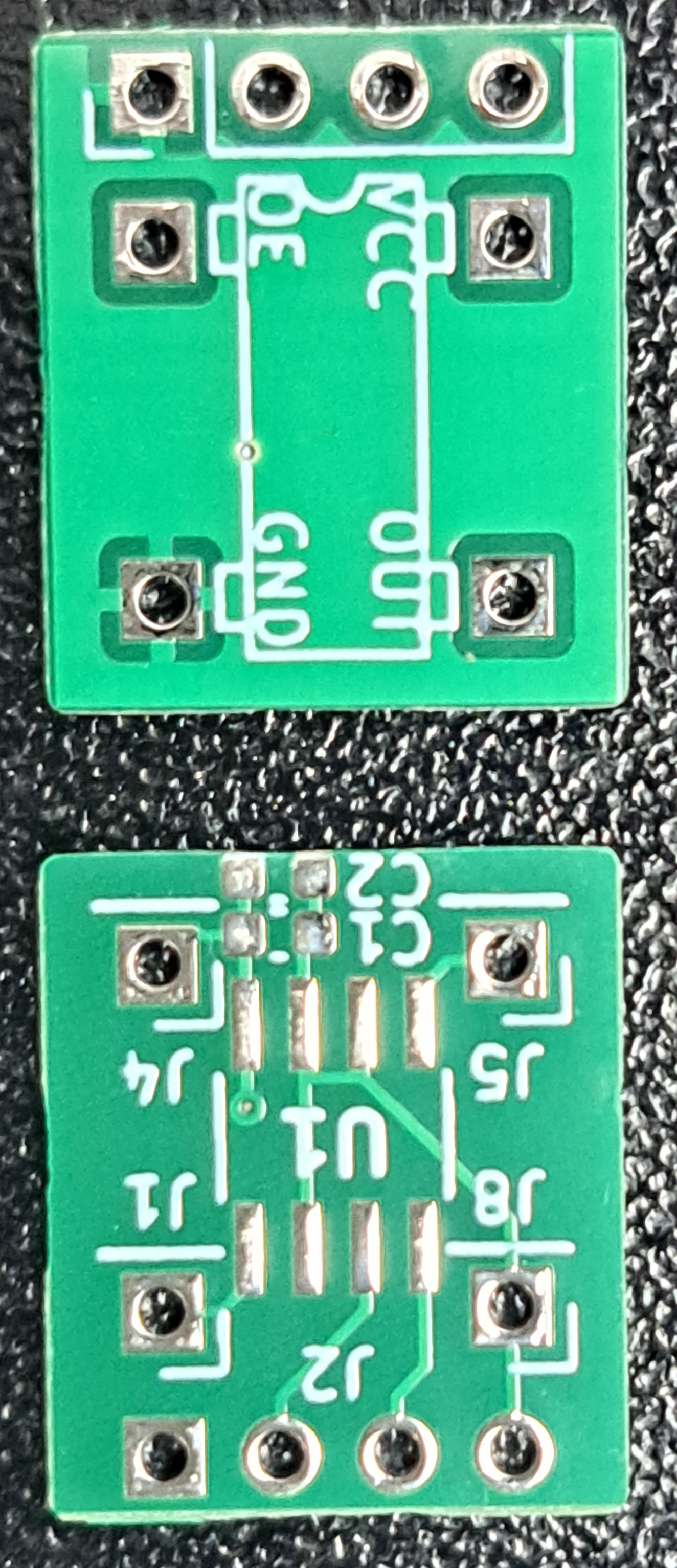

I also made some adaptor boards to use the SMD programmable oscillator (DS1086Z) in the socket for a PDIP-8 oscillator, and break out the programing pins:
