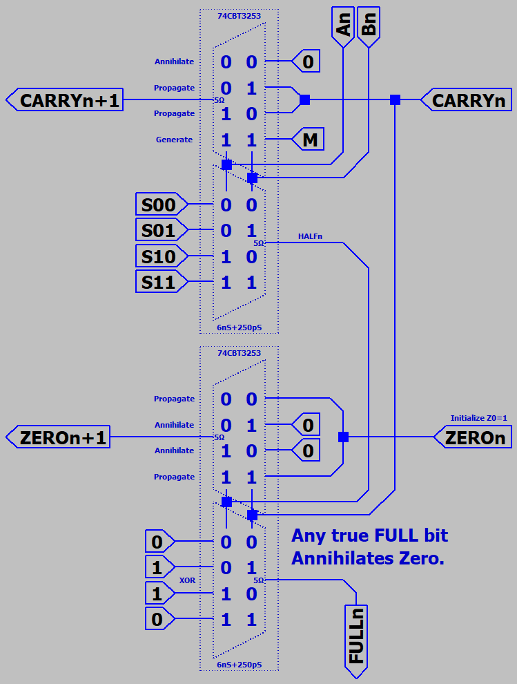

PostPosted: Sun Oct 01, 2023 11:59 pm
Joined: Fri Sep 22, 2023 9:42 am
Posts: 34
You mean CBTLV3251? Cause Google finds no such animal CBTLV2151.
Your earlier drawing shows an 8way, assuming must be your 8way.
How you testing Zero? I see no parts or module pin likely for Zero.
Could chain two 8ways and a dual 4way to test 8bits in some 7ish nS.
Chain of four dual 4ways might be more Elmore friendly.
I don't fully believe in Elmo yet, till I see it on my own scope.
Combinatorial Zero of LVC1G332 (OR3) followed by LVC1G27 (NOR3)
offers better minimum time (if lucky), but worse max. Sadly, 3 input
little-logic gates don't seem to be offered in AUC flavor. Tree of AUC
would be three gates deep instead. 2x74AUC2G02, 2x74AUC2G00,
1x74AUC1G02 still only 4 ICs. Contends for fastest if extra spaghettis
are well combed...
I'd like to test series Zero in parallel time with final XOR, buts needs
slightly slower dual 4way in place of LVC86 XOR gate. If can't proceed
till we know Zero, waiting a little longer for result might be worth it.
Like what I said in the 5th sentence, but one process step sooner
and not using dual 4way in parallel, cause the other half doing XOR.
Above drawing closer to 6502 behavior than before, still work to do.
Didn't draw XOR needed for subtraction, No rotate right yet, etc...
Or pre-charge a parallel bank of open drain inverters, if all fail to dump
the charge, that's Zero. Active pre-charge might be hard to syncopate.
Could interleave Zero detectors and let a pull-up resistor pre-charge.
How to keep from accidentally dumping before final result is valid?
This last option seems less reasonable more I think on it.
Maybe /OE's disable a chain of MUX4 with weak pullups...

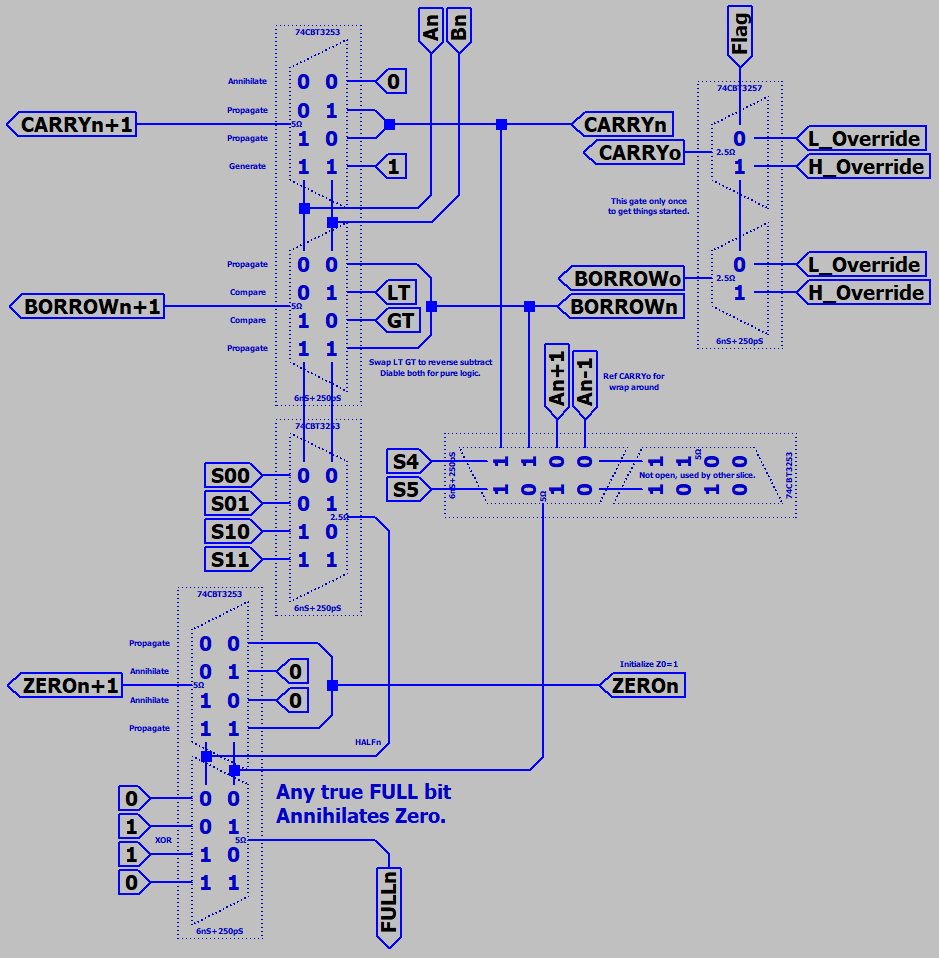

Posts: 34
Anything else need fixed, or ready for 6502 now?
Abusing borrow chain instead of inverting B input.
Why, cause it saves 3.5nS. 8way could select either
chain with capacitance penalty. But let extra MUX4
select between chains also provides a handy way
to rotate and still check for zero after.
Overrides can pass, invert, or suppress the FLAG.
Easy to make a rotate through carry act like shift.
I count 12nS + Elmo. Everything else in parallel time.
Zero's Elmo follows in Carry's wake, shouldn't stack.
Forgot to draw an Overflow. XOR (Carry7, Carry8)
Separate Borrow chain probably needs an overflow too.
Chains and rotations want 4way(S4,S5) to a unified output.
Had to mess up something...
Also no harm merging initial CARRYo with BORROWo.
Just thought it looked easier to read drawn separately.
If 0110 XOR inputs (or the output) might MUX2 to An.
Might allow for comparisons to work without changing A.
Zero flag would be set like A did change, no extra delay.
Would that behavior match 6502 expectations?
Still need to test sign, even a no-change comparison.
1G86 XOR for Sign separate from FULL7 should do.
Might use /OE2 to suppress all FULLs and another
gate like CBT3245C to pass A unchanged instead.
Except also uses /OE, would prefer non-inverted OE.
Nothing unfixable or needing a slow fix noted so far.

PostPosted: Mon Oct 02, 2023 6:26 am
Posts: 34
Oh, so V=XOR3(C8,F7,F6). I guess that works.
But can't start till we have Full F7,F6 results.
Was thinking V=XOR2(C7,C8)
Same rule for Borrow /Borrow.
Can begin figuring V 6nS earlier...
Unless V is inverted for a 6502 borrow?
I assume V overflow true regardless why.
Correct or incorrect, need to read more.
PostPosted: Mon Oct 02, 2023 6:28 am
Joined: Tue Apr 11, 2017 5:28 am
Posts: 68
Removed by author
PostPosted: Mon Oct 02, 2023 6:32 am
Posts: 34
No, I broke up the Elmo problem to not much worse than a single 4way chain.
If I had abused 8way (and I did not), that would be a huge parallel capacitance.
No need to convince me that stupid pet trick would Elmo face first and hard.
The rotation 4way adds capacitance to each tap, yes, but worth it. Somehow
rotations have to occur before Zero is tested. Where else would be better?
Wait to XOR B, wait to Prefix, wait to Carry, wait to XOR, Rotate, wait to Zero?
Elmo hiding somewhere in my scope scares me less, if only slightly...
When the Zero chain Elmos 6nS behind either arithmetic chain, it lags by 6nS.
No extra chain delay added to, nor an extra load upon either arithmetic chain.
Zero does not wait for higher half-results or any full results to begin switching.
Zero should Elmo slightly less, since its only loaded by one flipflop at the end.
How bout I add few ohms or buffer to each early arithmetic tap? Would slow those
results, but also might reach end of chains sooner. Only a complete result with all
flags counts. No advantage gained by early least significant bits slowing the rest.
