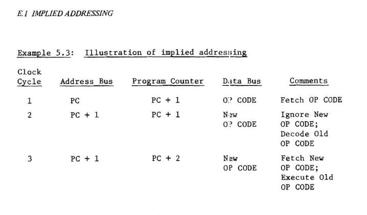

why would you think the CPU sit Idle, it just shouldn't use memory.
If a 6502 can't use memory, it can't run, because it reads or writes memory on every clock cycle. (Starting with fetching the next opcode to execute and its following operands, if any. Even for single byte opcode it reads (and ignores) the next opcode during the next cycle while it's executing the opcode it just fetched, and then reads that next opcode again on the subsequent cycle.
It may help to read the MCS6500 Family Programming Manual (and perhaps the MCS6500 Family Hardware Manual) to better understand how the CPU works. In particular, "Appendix E: Summary of Addressing Modes" in the Programming Manual gives details of what the processor is doing every cycle during instruction execution. The example of a singe-byte opcode uses implied addressing, for which the clock cycles look like this:
could you go over those cycles so I can point out where Im talking about using the 6522?
Just write a simple data copy loop and then break it down cycle by cycle using the tables from Appendix E above and you'll have what you need for 6502. If you want to post that here, I'm sure you'll get plenty of us checking it over.

cjs wrote:
you cannot do operations between registers without RAM access?
Correct. For a start, if you can't read the RAM, how do you read the opcode that tells you to do a register operation? Remember, these processors don't have any cache.
I suppose you could execute from ROM (or even a different RAM device) while DMA is reading and/or writing RAM, but then you'd need to have logic to split the data bus into two data buses, one between the CPU and the device it's reading/writing and another between the DMA and the device it's reading and writing. That would get complex really, really quickly.
very different overall design than I might have done... if you have operations that take multiple clock cycles internally, why would you do anything externally?
Well, it's a good thing you weren't designing the 6502, then. :-)
I'm not a 6502 super-fan or anything like that, but it's truly an ingenious design for its time, and that's probably what made it so successful. They focused on making something not only fast, but small and cheap (i.e., having minimal circuitry). That's why they could sell it for $25 when the Motorola 6800 was selling for $175. (IIRC Motorola quickly dropped the price of the 6800 to around $75 after the 6502 came out, but that's still quite a bit more expensive.)
One of the things they did to reduce the amount of circuitry was to make the read-ahead simpler. The 6502 is a sort of piplined design. After reading an opcode on cycle 0, it then decodes it on the next cycle, cycle 1. But when cycle 1 starts, because the opcode has not yet been decoded, it has no idea if it needs to read an operand or not. It deals with this by reading the next byte from memory anyway, so that it's there for immediate use if it's needed. If not (because the opcode has no operand), it just throws it away, doesn't increment the program counter, and the next read after that will read the next opcode again. I suspect the savings in time and logic from doing this, rather than trying to decide whether you need to read an operand, are fairly obvious.
