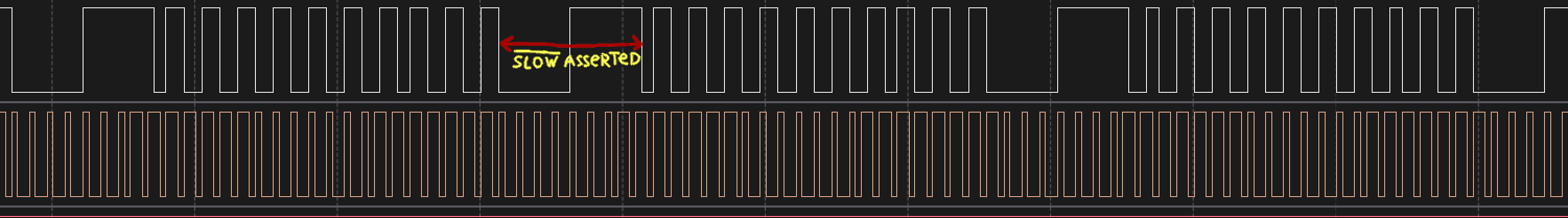

Simulated timing diagram:

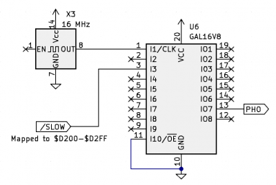

Schematic (I used GAL16V8 for presentation purpose since my Kicad doesn't have GAL20V8):

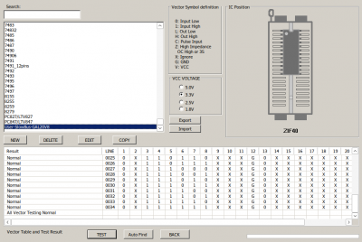

Actual test:
Surprisingly, this worked really well. Obviously, PHO will go to 6502 only: VIA will still use CLK/2 (probably divided through GAL as well in order to avoid clock skew between 6502 & VIA and ensure matching clock edges).
