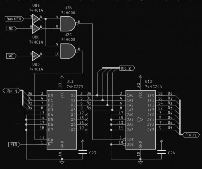

Is /banken qualified with phi2? Otherwise it stays valid for too long, and the CPU has taken the data off the bus already
IIRC the 273 latches the data in at rising edge of CP. So you should make sure CP is only low when phi2 is high.

Good you found the '273 because of its reset capability.
is your /BANKEN qualified with phi2? The '273 latches the value at the rising edge of its clock input, this needs to be at the same time as phi2 going high, otherwise the data might already be lost. You can easily add phi2 to the first stage NAND that you currently use as inverter, to achieve that.
Yep, it is: I have used /RD & /WD signals (qualified with Ф2) as inputs in my latest design, since I already have them in my SBC. I also happened to have just enough spare '14 gates for this task:

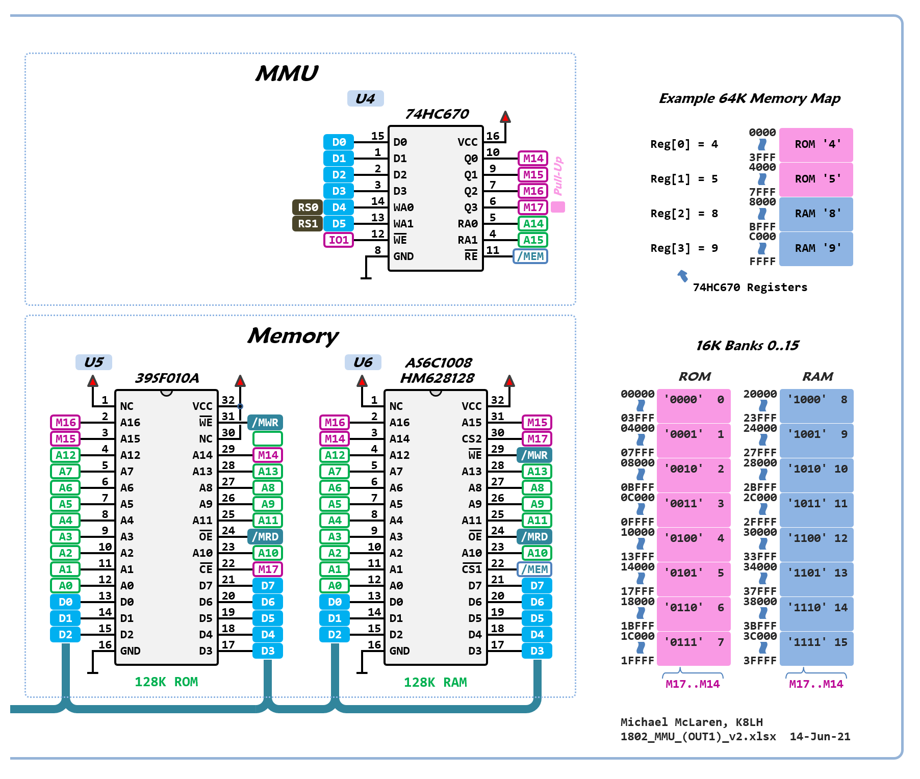

and3rson wrote:
Yeah, it seems like it would be nice to have an ability to map different regions of multiple banks at once, especially when there's a need to copy data between processes, or work with kernel & user-space data simultaneously.
I was looking at the 74HC670 4-bit Register File IC some years back for the ability to map different segments into 64K address space. I had seen the '670 used in projects by the RC2014 Z80 crowd. Could something like that be useful in your project? *drawing below was for an '1802 project which uses separate address space for I/O...
Good luck on your project.

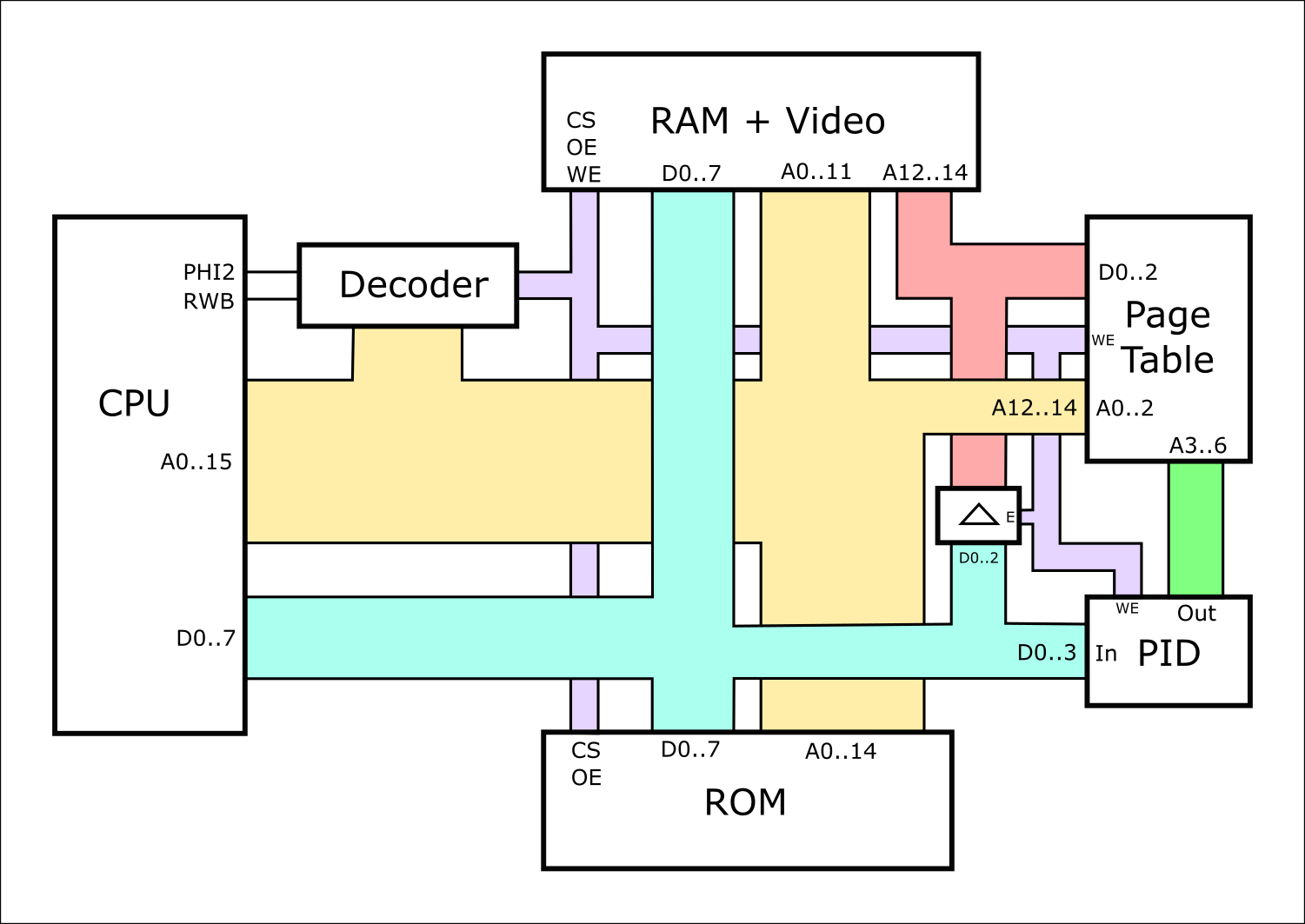

I can't remember whether I already posted this, I thought I had but can't see it, so sorry if it's repeating, but in my experiment with this sort of thing I put some normal static RAM between the PID register and the high address lines of my main memory so that each process had its own page table. Processes used a system call to request pages to be mapped, and the supervisor (PID=0) can map any pages it likes for itself including those already used by other PIDs, so it can read memory of other processes if necessary.
In the prototype I only used 32K of main memory, so not many address lines were used, but it would scale up well to larger RAM modules - or the high bits in the page table could reflect executability and other protection states. At some point you might want 16 data bits in the page table. I probably copied most of these ideas from Andre's system.

@gfoot how do you set the pagetable values? Wouldn't it require some registers visible to the CPU? That seems to be missing or I haven't understood how it works
For the supervisor process I think it was memory-mapped, with user processes using a syscall to request maps be set up for them.
On the hardware side I think ideally you'd use some transceivers or multiplexers to control the buses to the pagetable RAM, but I didn't get that far, this prototype was very hacky and I seem to remember I cut a lot of corners on that bit. It's no harder than the way video RAM is shared between the CPU and GPU though - you just need to make the address decoding swap things around when you're writing to the pagetable.
