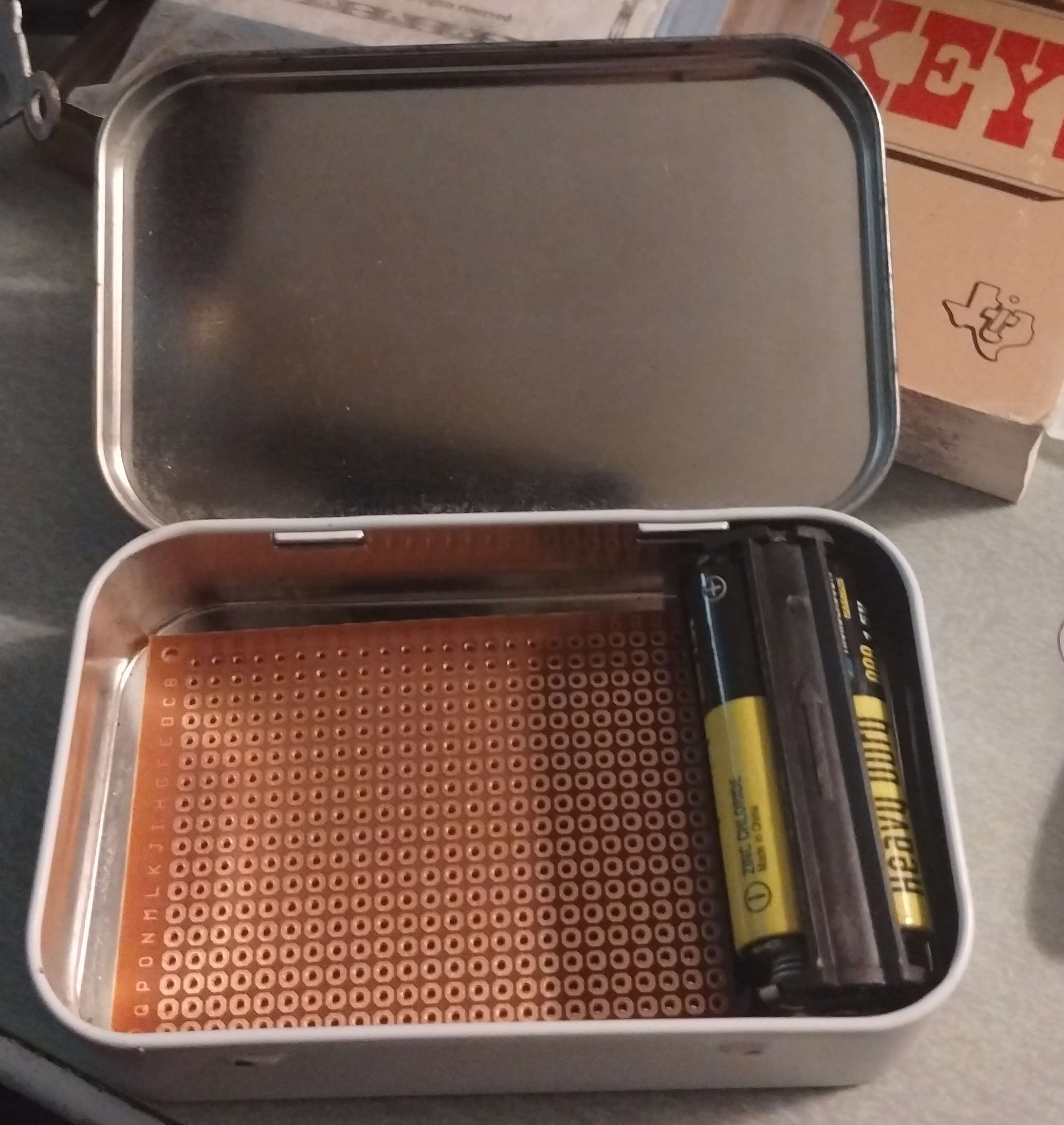

ok, so an Altoid's Mint Can, the full size one, is usually just a few dollars and will hold a credit card or business card ok. so, that means business card PC. trying to make this 'apartment and hobby friendly';
WIP Shots!
any particular screen is TBD as of 5/14/23 for the Mark-I.

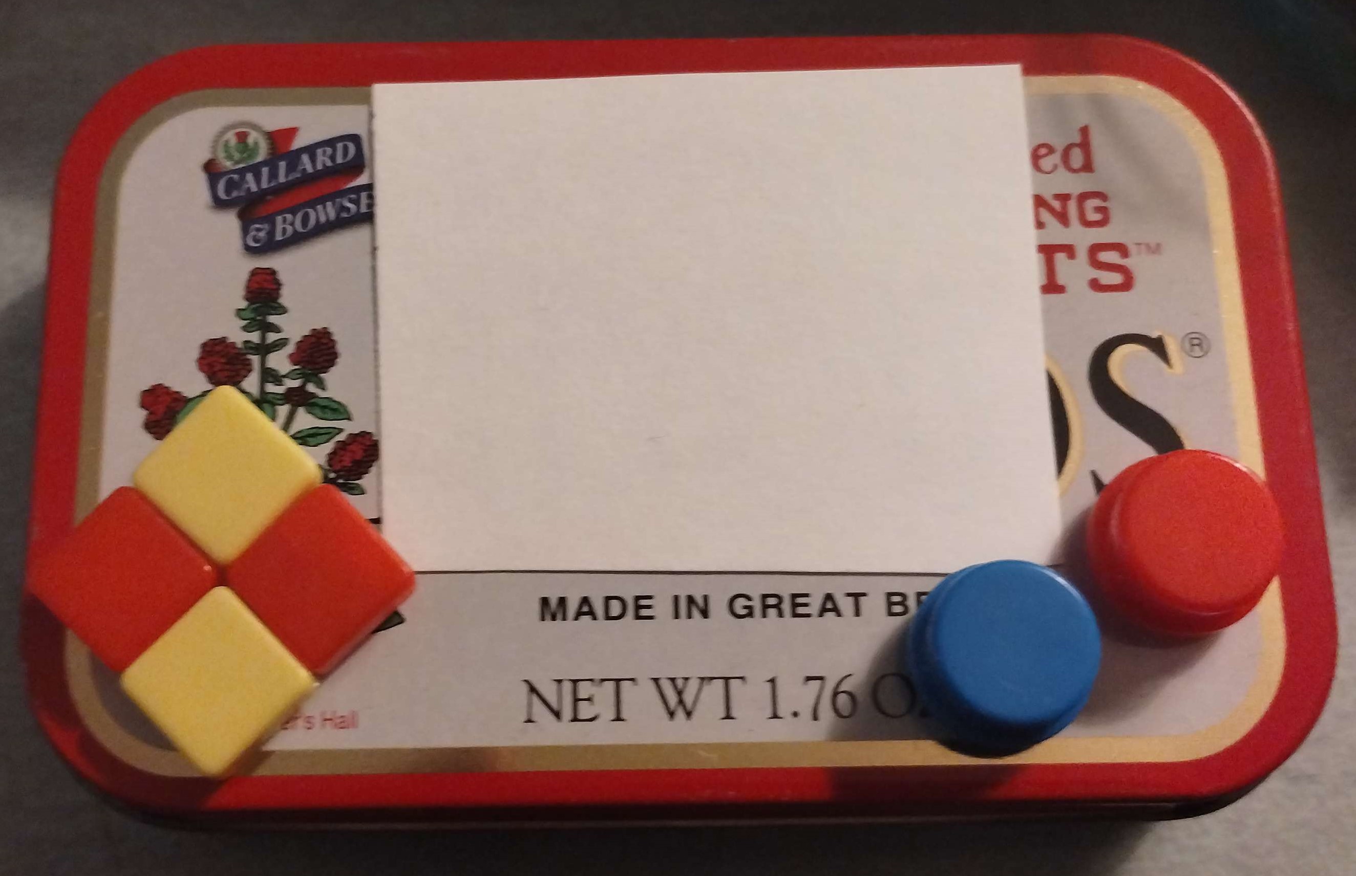

so a Dpad, and 4 buttons on the front with a 2.8" or so screen, mono speaker somewhere and/or a headphone jack.
lets call that "Type One" Im thinking of 3-4x AA batteries or a cell phone battery. idk yet
Display: a 2.5" to 2.8" lcd screen running an ST7xxx. we get a 128x64 LCD with a Neotech or Sitronix "driver" IC. The multicolor backlight is kinda nice for a few extra bucks., though I think I am fine with a White-on-Blue or Yellow-on-Black. I have done a lot of little maths and searches on available hardware, and a full-color screen would fit, you need a GPU for it though. For this design, the 6502 is basically just running the screen, input and simple audio.
Input: If you have the buttons on top of the Altoids can, 2.8" is about the limit you can hit. those ST77xxx chips can 6800 or 8080 in, and I guess I just prefer this to SPI or IIC. A few had MIPI or other controls, I guess I really want that more familiar console old school shared VRAM thing going? idk, Im open to ideas and this tin can might get a USB or serial port. probably not.
Design: as we further reduce the design to an MVP then you have a Screen Module, a ROM IC, a RAM IC, a system clock and support passives, a sound chip if possible and the 6502. It is likely to space concerns that the 6502, power clock and RAM will be on one protoboard, with a set of headers as busses to another porotoboard with the audio (and maybe power) and possibly ROM and the display connector.
Physical Constraints: This should all fit correctly. Even with PLCC sockets, on the perfboard, its too complex for most to wire up. This should be much easier to complete, workshop activity level. So a 6502 needs RAM, 128*64 = 8192, or about 8Kb. a 32Kb RAM IC is about $5 right now, and that would give plenty of program, screen and general purpose space for a device of this type. It is considered to put 2K of RAM nearest the 6502... 32K is half of 64k, which we will need some of for ROM on this as its not likely to have much I/O. A very simple SD card or Flash Card reader is proposed in several places here and on the web by 6502.org users; however, space constraints are very great and a very basic ROM chip (a socket is pushing it, so programmable by pin headers?) is probably all we get, and will need to be tested on a breadboard before final soldering and assembly, though here a plcc socket or such might work. 8Kb of ROM is $5, and 32K is about $11, so that is still approachable by many.

I added a couple of concept pics to the first post. Im not 100% of what Im putting in here, though this will end up being very close the Core unit I use in other projects later I think.
