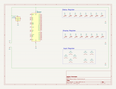

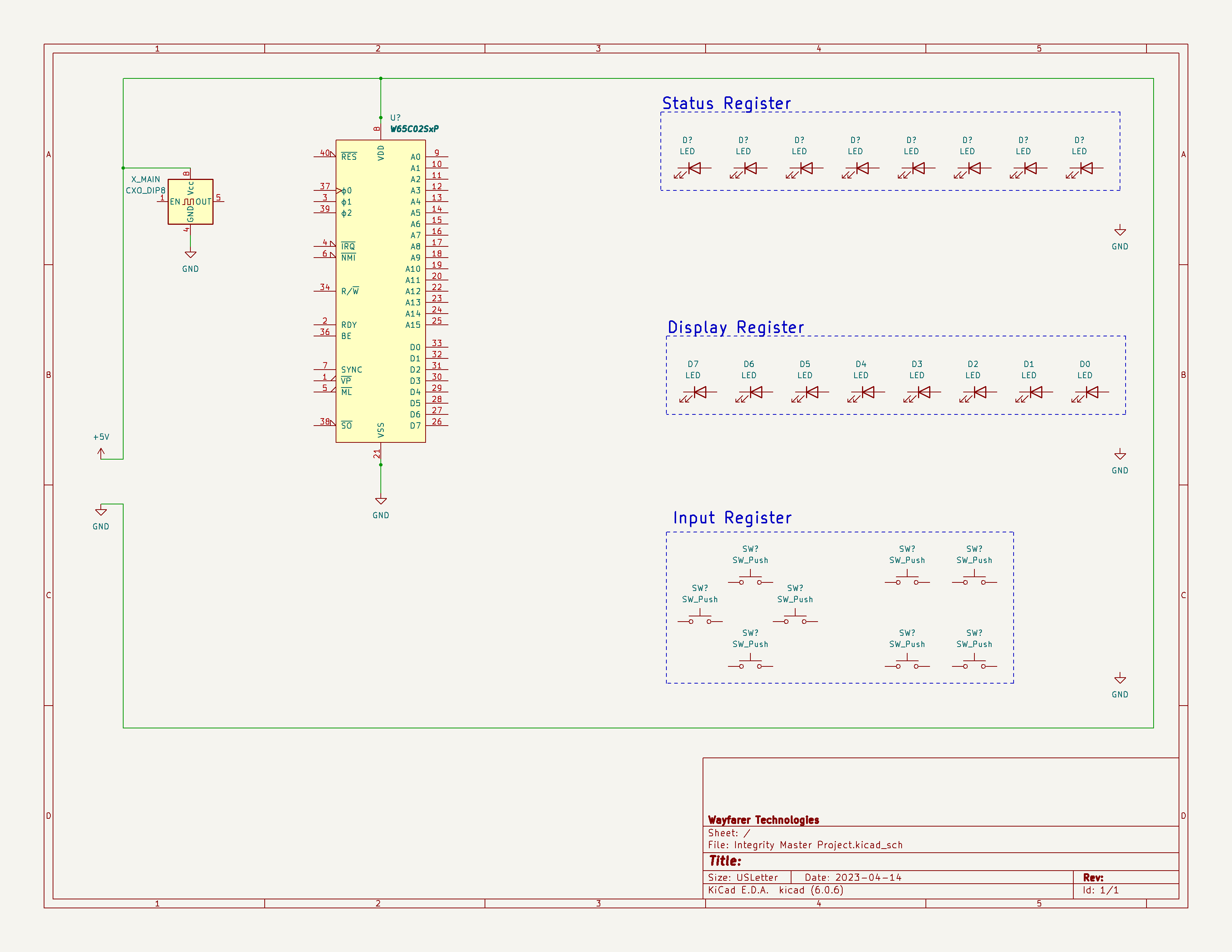

The Chronos by default uses banks of 8 LEDs to represent contents of the Flag register, and the "Display" register, which is basically just copied from the Accumulator on update.
Further iterations may use multiple Display Registers, such as A, X and Y, or even a full 8x8 grid, or other arrangement may be explored, it is possible that a version of Chronos may exist with an LCD screen, however this along with an 8x8 register bank are beyond the current scope of this project.
Operation.
Chronos uses the accumulator and various opcodes to perform binary computation directed by the user.

I started on a schematic, though I need to head out for the day. Im pretty sure I want to use some Latches in here and there is a lot of other little stuff I am missing. I was not planning to use a 6522 for this, I think its probably overkill.
all the passives, all the little things, a counter for the clock to become a Real Time Clock, stuff like that.

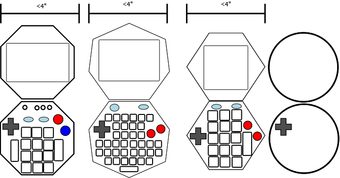

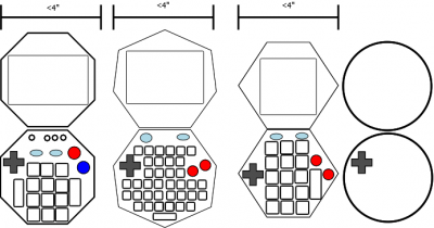

the screen is a huge determinant in form factor. I see two devices emerging from this experiment, a device a bit bigger than your phone, a graphing calculator with some options, maybe a PC Card slot. its going to have a lot of value for its cost. it will not be a full blow Integrity penabled speech synthesizing tablet with an 8.4" screen at 480x800. It will have a 4.3-5.5" screen, at 240x400. It will not have a big GPU or sound card. It might have a GPS and or radio, probably to receive weather band. It will have a 64-bit (probably unless trying to use it with a 6502 is too much overhead and the 32 works better) math coprocessor, it will have a few nice features and may never exist, because the work to build it, is as much as the integrity. maybe Ill just make a nice calculator.
the other is a portable device, its like a clamshell gameboy advance, the SP., it had a ~3" screen at 240x160, so we will be exceeding that only slightly, it has our input setup, a compass, music player, gps, weather radio, possible distress beacon, is hardened and it can play a few games and do math, it will have the OS 'monitor' and maybe some calculator software you could use a little.
I think I can build that for well under $100, though Im not sure if I can make it 'hardened'

a clamshell design is a notion as is a book/bar type. I like a set of keys under the screen between the normal input. getting a board for a keyboard with a gamepad is really easy they make controllers with keypads on them, so that is something to explore.
I think qwerty is 'too much' and a good set of calculator keys is the way to go, maybe with the Hex digits. lots of math symbols like pi.

So a 6522 is starting to look likely, once we get past blinking LEDs and want to do anything useful. I do want to demonstrate and that you can use a 6502 'directly' to do math at human speeds. Beyond this however, if you are going to have more than a clock or alien math fidget stick, you need some hardware. with a possible screen or more complex display, a 6522 is an obvious choice, especially once you add in a keyboard. So, if it is a calculator, then using a math coprocessor is only a few extra bucks and rather 'worth adding' in addition to those lookup tables. one does not preclude using the other. the micromega uses I2C or SPI, and several other possible chips use SPI, which is not difficult to do with the 6522 from what I have read. So this is starting to look more and more like that 'Core' or RED zone for the integrity, with a 6502 instead of a 65816, and no DART unit yet. some RAM and ROM. I wanted to put 2Kbit of SRAM at zero page, though its hard to get that these days in anything except SPI... SPI for ram.. wth? its probably for a battery backed solution of some sort. SPI for RAM, makes very little sense to me, especially for something like zero page, I want to use as 'cache RAM'.
Getting a bigger RAM chip is fine, I do need to make room for the ROM and I/O devices. for the Math coprocessor, sure, you are going to use it for its big number and advanced functions. its 64 bit, unless I opt for the 32bit version (idk, its only $3 less)
a bunch of stuff wants a 32.768kHz clock. so thats going to be a thing. 2,3, 4 different chips so far, FPU, the MAX real time clock/calendar chip thats less than $3 and gives a full PDA worth of functions through 2399 or whatever. Ill review a few other chips, having a nice clock with stop watch is nice. I know you can maker one with a 6522, though I figure I want one anyway. if I could find one with a few more timers or such, multiple alarms for $1 more I might to save writing software. So, a 6502, and a 6522, and a &32k clock, and a real-time clock chip. we are getting close to a computer here. if the 6551 was not bugged I might add it, as is Im not certain this device needs a UART or 'DART' unit. kinda... when it comes to a clock, everything 'wants' a 32.768kHz crystal or clock signal. the max chip prefers a crystal with capacitors. Personally, I want millisecond precision. Time stretching and single stepping the CPU/system clock is great, however, somewhere in there, I want milliseconds, and that means, well, 32.768 MHz, or with margin of error, about 33Mhz... that number does seem to pop up here and there on some busses... I think running the GPU at 3.2768 MHz, or an independent frequency from the clock is probably ok, however, that is probably an okay speed to run the bus at, so perhaps some multiple there off might work, or we can decouple the buss from the real time 'low speed' oscillator and use sensible numbers on the bus. Again, we have now stepped into the "Integrity Lite" territory, however I think this device, which we cannot call the Chronos , does have merit.

ok, so an Altoid's Mint Can, the full size one, is usually just a few dollars and will hold a credit card or business card ok. so, that means business card PC.
I think I can fit a 6502, a RAM with RTC, a 2.8" or so 320x240 color LCD, some registers or a 6522, support hardware etc in this space, I believe I saw a business card PC on the SBC- area of the site.
this suggests an even more simple design that the Chronos, which is a pretty maximized 6502 system that can probably take expansion cards and a GPS. the Chronos is meant to be used on jobsites, where you would not use a motorola Z-Fold. its the size of a tape measure and might have a good level and compass. It will do carpenter math better than a Construction Master Pro.
I will out math a Ti83.
so this little idea. is a tin can. a sardine can (I have a couple) are closer to 3x4 inches.
an Altoids can is cleaner and in this type of hobbyist project, traditional.
so a 2.8" lcd screen running an ST77whatever, or similar. Ada fruit has one for like $30 with touch if desired, I saw several for under $20 and a few around $10. YMMV. Id like to go to a bigger screen and hit 400x240, or 1/4th my Integrity screen size.
If you have the buttons on top of the Altoids can, 2.8" is about the limit you can hit. those ST77xxx chips can 6800 or 8080 in, and I guess I just prefer this to SPI or IIC. A few had MIPI or other controls, I guess I really want that more familiar console old school shared VRAM thing going? idk, Im open to ideas and this tin can might get a USB or serial port. probably not.
Im thinking of 3-4x AA batteries or a cell phone battery. idk yet
so a Dpad, and 4 buttons on the front with a 2.8" or so screen, mono speaker somewhere and/or a headphone jack.
lets call that "Type One"
if you put the screen on the inside of the lid, you can fit a 4-5" screen depending on its arrangement. I saw a really nice 3.5" or so 400x240 screen on digi or the mouse. it was not a lot more expensive.
so then your lid opens like a mini laptop and you have room for controls, speaker, more buttons etc.
lets call that "Type Two".

so, I'll end up at least blinking LEDs, probably making a low end game boy on a breadboard. commercially, unless I hit a niche use... [snip] maybe its a 'Wayfinder' or such.

its not so much 'commercial' as 'practical'. I am probably going with an open hardware model for a lot of stuff.
Im all for someone 3d printing and building their own one of these or improving it.
