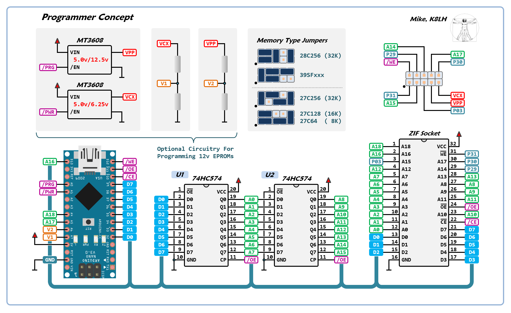

Loading up a pair of 8-bit latches in cascade could be faster than loading up a pair of '595s. Also, please note the cheap MT3608 'boost' regulator modules will pass their input voltage when /enable is off which is perfect for supplying 6.5v or 5.0v on VCC and 12.5v or 5.0v on VPP for the 27C64, 27C128, and 27C256 12 volt EPROMs. Unfortunately, cutting a trace on the MT3608 modules to expose the /enable input can test your mettle, and, I'm not sure what you'd need for the various voltages required for the 27C512.
Have you looked at the relatively inexpensive single-voltage SST 39SF series flash ROM's?

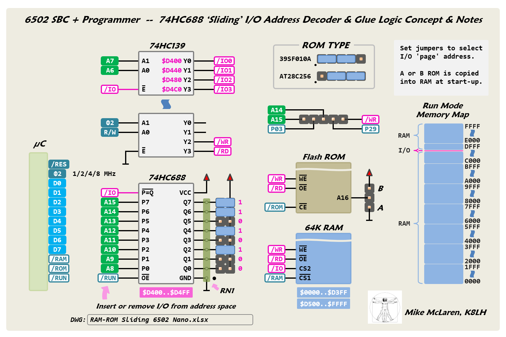

I have to say I really like the SST flash ROM's but a design could support either AT28C256 (32k) or 39SF010A (128k) devices by including a 32-pin socket and simple set of jumpers (see below).

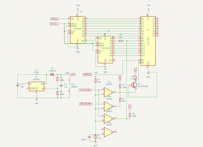

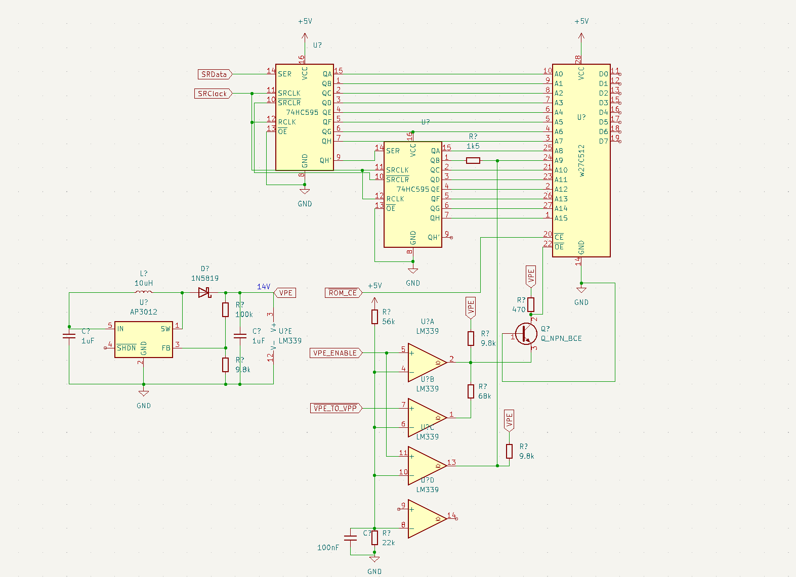

I've attached a schematic to make things clearer. I think only VEP/VPP (~OE) needs to source (30mA max) current so I've added ... what I think is. ... a current buffer BJT. A9 probably just needs the voltage. Will it pass on the voltage and add a current source?
Will it work and will it successfully switch between 12V and 14V depending on VPE_TO_VPP?

Hmm I'm not sure I follow what's going on with the comparator. I'd be more inclined to take the 14V divided down to 12V, pass it through an op amp to buffer it (if you can get one that supports the output current you need), and use a P-channel MOSFET or PNP transistor to optionally bypass the top resistor of the divider - so that if the base/gate of this transistor is grounded then it will bypass the top resistor and the output of the divider - and hence op amp - will be 14V instead of 12V.
I don't think your "Q?" transistor is correct, you have the base grounded. An emitter-follower current amplifier usually has the input going into the base, output coming from the emitter, and collector connected to the high supply voltage. The emitter output is then about a diode drop lower than the base input. I'd prefer an op amp as it won't have that drop over it, but you'd still need one that pulls all the way to the high voltage input (or boost to an even higher voltage to power the op amp). I'm sure others here have better suggestions too, my analogue experience is very limited.
It's just level shifting from 5V -> 14V. @GARTHWILSON has an explainer here: http://wilsonminesco.com/6502primer/potpourri.html
That's usually how a common base amp works - still not sure it works as I expect though :) https://www.electronics-tutorials.ws/am ... ifier.html
