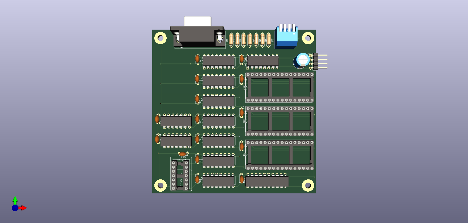

Hey everyone!
Back when I started in 6502-land, I had built a system very similar to Garth's Potpourri design. It was capable of I/O through the 6522 VIA, but the actual I/O devices were lacking. I eventually learned how to hook up a 16x2 LCD, and get some SPST buttons detected. But my dream was always to get something displayed on a monitor and with a full keyboard.
The PS/2 Keyboard is super easy to connect directly to the VIA, but VGA video display takes MUCH more effort. When I was fresh at this, I wanted some pre-built module that I could use similar to the 16x2 LCD, but would display on the monitor instead. I found some things out there, but they were either discontinued, or required CPLD's which I myself could not program.
Now that I've gotten more experience with video display, I am now working on a VGA I2C (or SPI?) Module (see attached schematics). You interface with the device through the CLOCK and DATA pins. Send 22 bits sequentially and you get a character on the screen! This module would display 8x8 characters, with a total of 80x60 on-screen characters. It allows for 256 different characters, with 16 character banks available. 8K of RAM, 2x 32K of ROM, some shift registers, some counters, and some glue logic.
The picture of the board is from KiCad, and it definitely not completed. Lots of silkscreen to fill in! But the basic layout works, and auto-router finished within a few minutes.
I haven't had it printed yet, mainly because I'd like some feedback from y'all. Not to see if you find anything wrong (though I wouldn't mind that), but just to have some overall design insight. What would be helpful to a newbie? Should there be a different placement of components/connectors? Should I go with something more 'parallel' instead of I2C? Should I assume that they have access to a EEPROM programmer, given that they are playing with 6502 to begin with? Would character-only graphics be sufficient, or should I go with bitmap graphics instead (slower but more customizable)? Anything you can think of that would be better or more useful?
Any thoughts are appreciated. Thank you!
Chad
EDIT: Changed the tag name to SPI instead of I2C, thank you Gordon.

From a protocol point of view SPI is much easier than I2C - assuming you're doing I2C correctly....
... which It looks like you're not as clock + data just go into a shift-register, so it's effectively SPI with a weird bit length. That's fine.
So it's actually a 24-bit 'register' with the bottom 8 bits being the character data and the upper 13 bits (? 0:6 + 10:15 ?) being the address (screen location?) and another bit for 'clear' ..
If you gated clock with another input signal (via that spare NAND gate?) then it could be more like SPI with the other input signal being the enable line, so you then open up the possibility to it being a more generic SPI device and allowing the host to have multiple SPI devices using the same clock+data output pins, just different enable outputs?
But without pouring over it for more time - I guess what have have is now the VGA version of Don Lancasters TV typewriter - well the video side if not the keyboard.
It's so tempting to use something else - CPLD or even something like a Pi/Pico/ESP32 - even an ATmega but without anything programmable, really hard to add in "smart" stuff like attributes, partial screen clearing and so on.
Parallel vs. Serial? Go either way. I have a 115200 baud serial interface from my Ruby system to it's "smart" terminal (A Linux application that interprets commands in much the same way as terminals of old did, but has fancy facilities for graphics, sprites, sound, ...) however it's more than fast enough for some simple games/animations.
I am moving to parallel for another project but I'm also moving to a faster MCU type of thing - but just for graphics & keyboard.
Could you make the Font ROM a RAM? Then an extra bit in the output stream to select where the data is being written? A down-side is that at power on, the first thing you need to do is download the font... Which will require ROM storage at the host side... But might allow for programmable characters..
And there's always "PETSCII" style graphics if you wanted to go that route...
Hope it works well!

Thank you Gordon, good feedback, making a few alterations now!

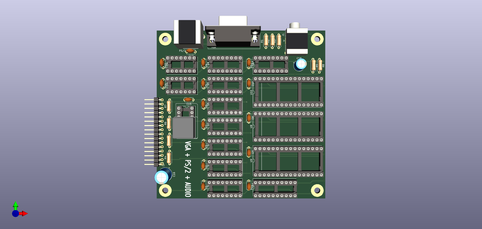

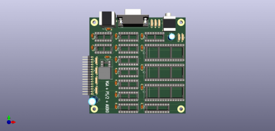

Updates:
I've been messing around with it a bit this afternoon. Attached are some updated schematics and a picture of the board layout. I put the VCC/GND traces on the board, and auto-router finished the signal traces in under 2 minutes.
Some things that I said I would look into implementing, I haven't yet done. The main things are the addition of a PS/2 Keyboard connector, and the 3.5mm audio jack. The keyboard connector has NO LOGIC attached to it, it is only the connector. Think of it more like a breakout board. The audio has a polarized cap and some resistors to turn 0V to 5V into -1V to +1V basically. It will not oscillate by itself.
These are just handy things I think will help. As in, if someone were to plug this into a breadboard, they could chose to use this as a type of 'breakout board' for some other features, if they choose.
Thanks for the suggestions everyone! I'm looking forward to testing this, and then posting it on my GitHub and having the gerbers available for anyone to print their own.

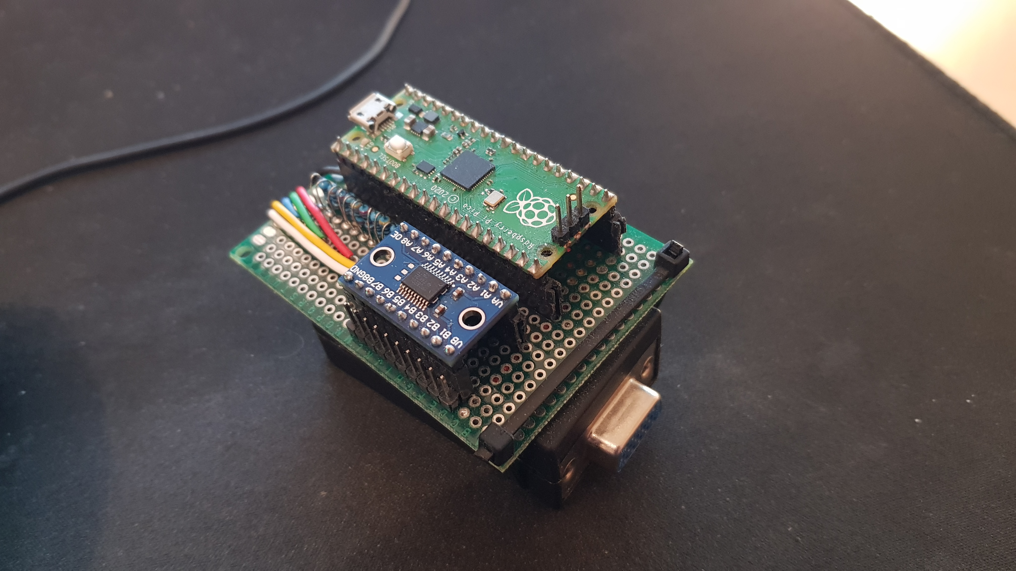

an SPI Video Card is a pretty interesting project! i honestly didn't expect you to use 74 logic to handle all of it. i thought it have it's own 65c02 to handle the interface and communication, similar to my first try at a VGA Card (which failed horribly, but the idea was good).
a while after my failure i created this monster: a Raspberry Pi pico connected to a resistor DAC and a level shifter.
the thought behind this was to have a very cheap and easy to construct video card that would be powerful enough for basically any system that can drive an SPI interface. with a target resolution of 320x240 @ 256 colors, and using mainly commands rather than directly accessing memory through the SPI interface.
examples for commands would be: scrolling or moving parts of the screen, placing tiles/sprites, drawing pixels/lines/shapes, filling areas, moving chunks of data into or out of the Pico's Memory (like tile sets), or even some non graphical functions like floating point math, accessing an SD Card, or some kind of sound output (maybe?)
sadly the project never made it far as i ran into issues just getting a VGA signal out of it. it would generate the right Sync signals, but never draw pixels correctly.
specifically the colors are only correct near the top of the screen and fall off further down, which is confusing as i would assume a broken DAC would make the colors consistently wrong across the whole screen... but anything analog is black magic to me so i just stopped questioning it.
i'm just glad the DAC on my second VGA Card works perfectly fine.
anyways, of course not everyone would want some non-retro ultra powerful microcontroller just for a video output. but on the other hand a lot of younger people getting into the 65xx/Z80 world likely wouldn't care and just want a cheap way to draw things on a screen without having to make their own line drawing routines and such.
either way, i wish you the best of luck with your project as it sounds way simplier and more achievable than what i had planned.

Hi Chad,
I think it's a cool idea, and I probably would want one. Here's a similar project I've been eyeing off and on for the last year:
