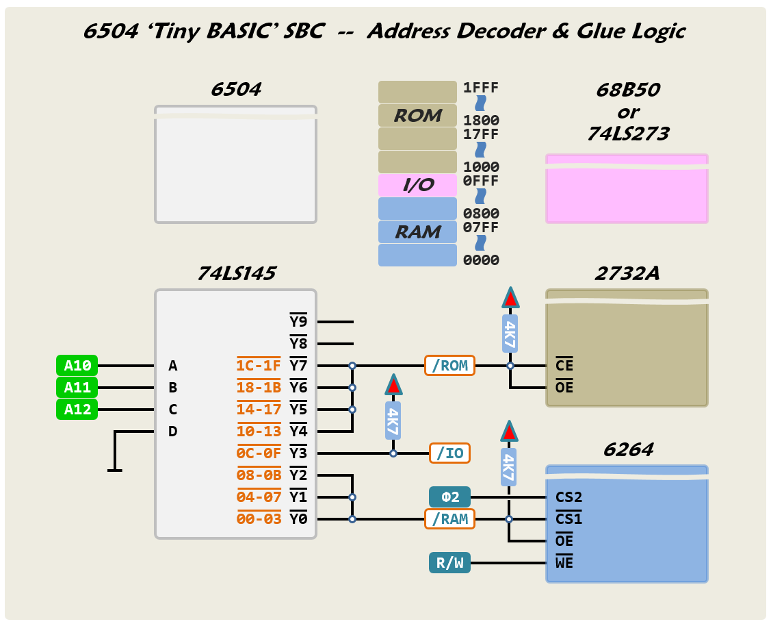

A first attempt (missing oscillator, bypass caps', etc.). Tiny BASIC will fit in 4K of ROM, correct?
Good attempt - I like the Open Collector address decoding. However 6264 with its handy dual CS pins was not available in the 1970s. AFAIK The Intel D2186 was the first 8kbyte (pseudo) SRAM and was available in 1982. Could carry forward the LS145 to try and map the 74LS74 to get a 2 bit output port in zero page, with a pair of 2114's for ram.

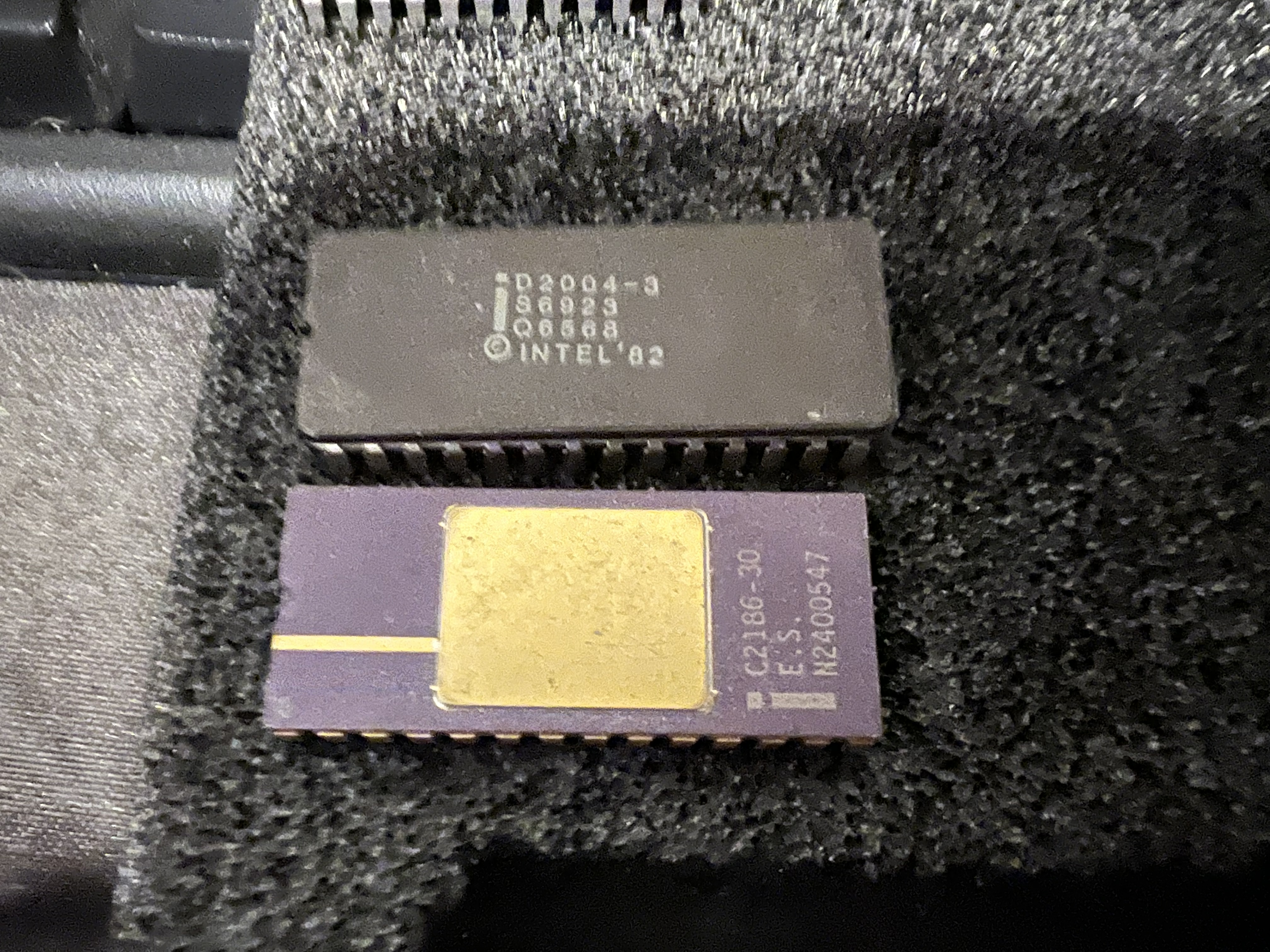

I've got a gold C2186 ES that I've been wanting to power up. It is a DRAM with internal self refresh used as SRAM. The D2004 next to it is a 256 byte SRAM with parallel load/unload NV storage from 82 period.
Greg
