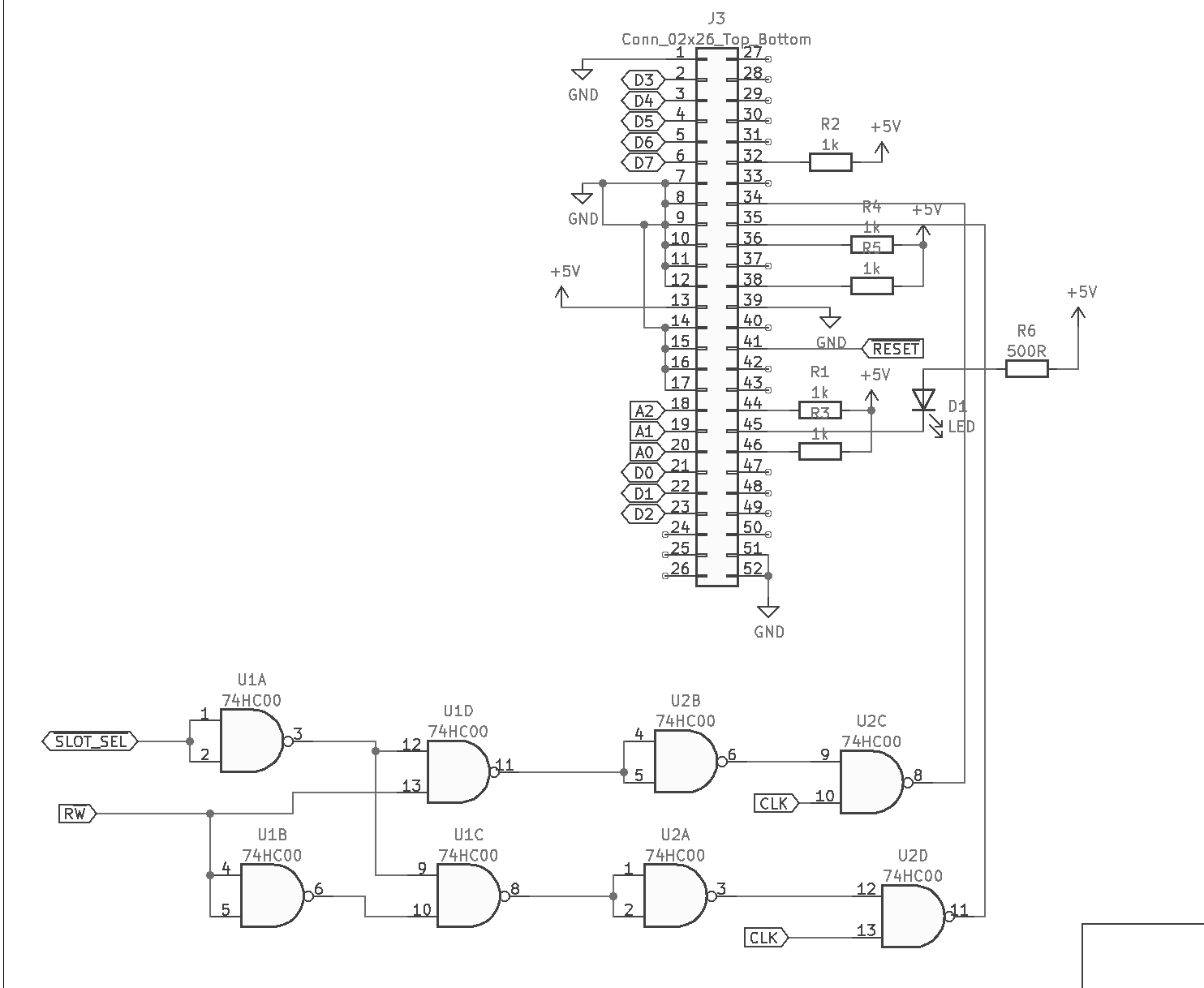

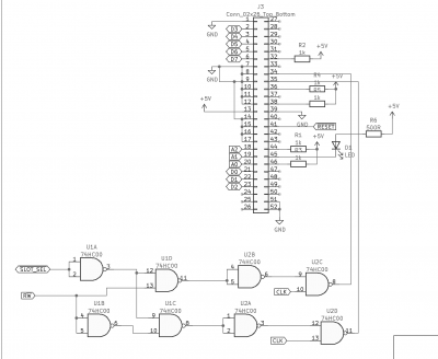

I am trying ( and so far failing) to reliably read data from a CF card.
I built a circuit which seems to work, but I am getting some missed bytes, or sometimes added bytes.
Here is a schematic of the circuit, but note I am using a CF to IDE adapter on my prototype board (to my understanding they are just passive adapters, am I wrong?)

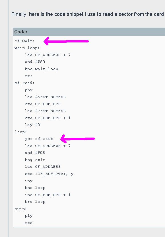

Finally, here is the code snippet I use to read a sector from the card (adapted from this code)
cf_wait:
wait_loop:
    lda CF_ADDRESS + 7
    and #$80
    bne wait_loop
    rts
cf_read:
    phy
    lda #<FAT_BUFFER
    sta CF_BUF_PTR
    lda #>FAT_BUFFER
    sta CF_BUF_PTR + 1
    ldy #0
loop:
    jsr cf_wait
    lda CF_ADDRESS + 7
    and #$08
    beq exit
    lda CF_ADDRESS
    sta (CF_BUF_PTR), y
    iny
    bne loop
    inc CF_BUF_PTR + 1
    bra loop
exit:
    ply
    rts
where FAT_BUFFER is a 512 byte buffer, CF_BUF_PTR is a ZP pointer and CF_ADDRESS is the base address of the CF card.

I think you might be having an issue with your hardware setup. The schematic is a bit confusing... as you show a 52-pin connector and compact flash is a 50-pin connector. You noted you're using an adapter, but all of the ones I've used over the years are setup for either a 40-pin IDE interface (with separate power connector) or a 44-pin 2.5-inch IDE connector (integrated power). In any case, these are basically passive, but would have the correct wiring to put the CF Card into IDE mode. Also note that there are two power pins on the CF Card: pins 13 and 38. You have pin 13 to +5V and pin 38 via a 1K resistor to +5V. You also have the /CS0 select tied low and are using a bunch of gates decoding the read and write lines to the CF Card. This might create some timing problems, but maybe not. You show pin 50 as floating, but the SanDisk specification shows pin 50 as Ground.

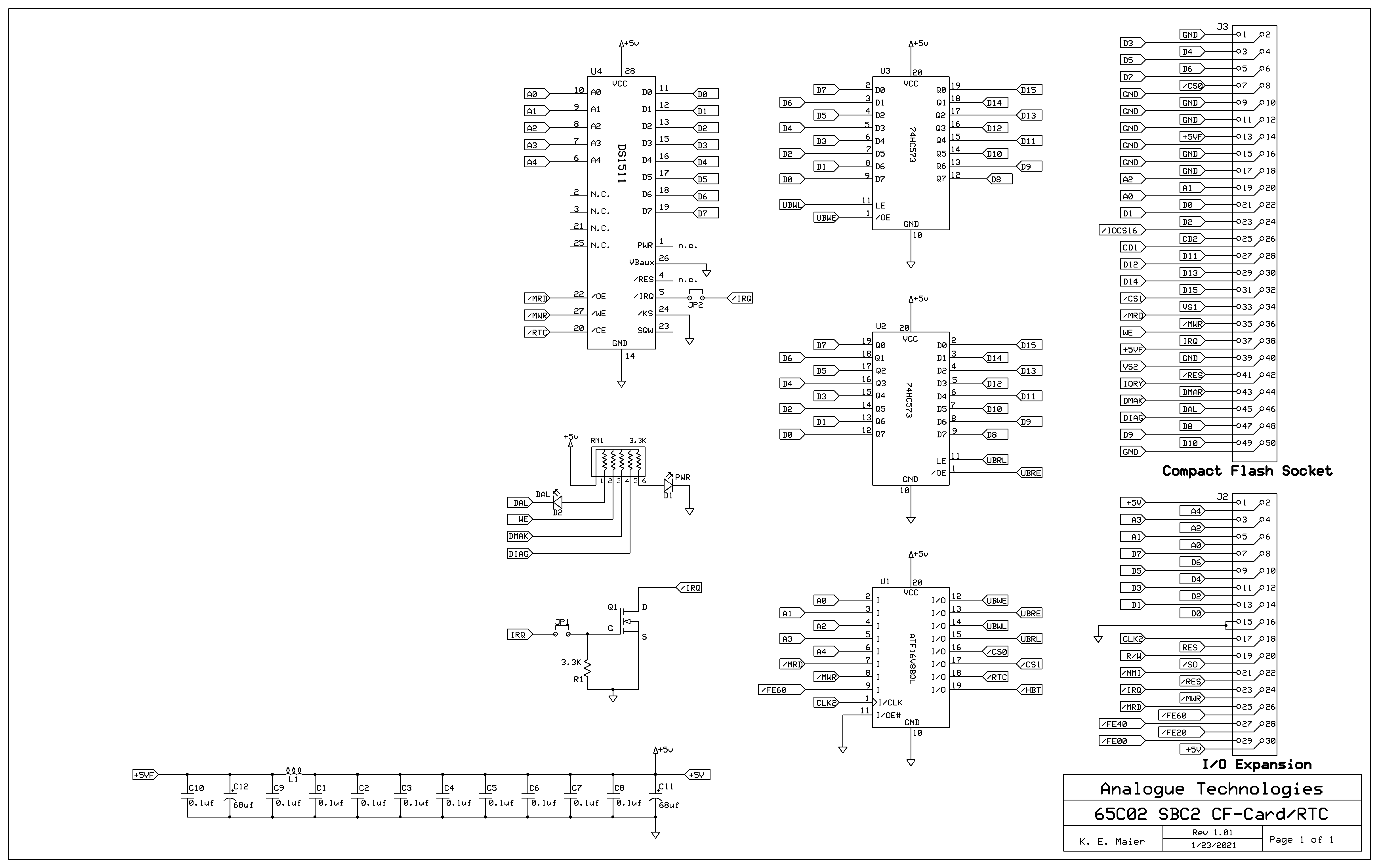

Attached is the schematic for my compact flash adapter. It's different as I'm also using an 8-bit latch for the upper 8-bits to provide 16-bit data transfers, but the full wiring of the CF Card socket is show with signals grounded, pull-up resistors and such. It might be helpful... but maybe not.
My decode logic is via the ATF16V8 PLD. Note that the chip selects are done via address lines only and not qualified by any clock signals. I also have CLK2 qualified read and write signals that are driving the CF Card read and write lines.
As for the software, you're using 8-bit data mode, so that has to be set first as the default is for 16-bit transfers, which you're probably already doing. My BIOS code (github page) sets up the CF Card and uses interrupt driven transfers. It might be helpful to take a look at it.
Also, Bill (Plasmo on the forum) has a compact flash setup he uses in 8-bit polled mode, so his looking at his CRC65 hardware and software might be helpful as well.

Hmm, I'm forced to guess some details. Is CLK the same as PHI2? And is SLOT_SEL the output of an address decoder?
I does not seem to be a timing issue either because I get the same types of errors whether I run the computer at 1, 6 or 12 MHz...
Altering the clock speed isn't 100% proof you DON'T have a timing issue. But if CLK is indeed PHI2 then your circuit looks reasonably good to me. You could try replacing the 'HC00 with 'AHC00...
And, is there a transcription error? See below. It looks to me as if the code is calling itself! But I'm still on my first cup of coffee of the day... :) :roll:

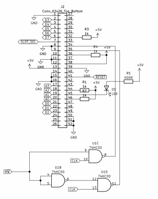

Pins 51 and 52 are the little tabs that hold the connector down on the board. This is the footprint I am using
The schematic is not the exact circuit I am using at the moment. It's a design for a board I am planning to make once I have this prototype working. I can see now that it is wrong in a few places. I can draw and post the prototype's schematic if that would be helpful. I used the same decode logic, but I have CE1 (pin 37 on the CF card) tied to the chip select out of the memory decoding. CE0 (pin 38) is tied to ground. Thank you floobydust for your keen eye, I'll make sure to fix these mistakes on the schematic before having the board fabricated. Your schematic will definitely be helpful. Could you also maybe point me to your PLD code so that I could check my own logic against yours ?
Yes to both
There is an "rts" on the line above "cf_read" that maybe escaped your coffee deprived brain :D
you should have 3 controls: chip select, read strobe and write strobe. Timing wise, read strobe or write strobe need to be asserted last and negated first. Think of chip select as one of the addresses.
Chip select is tied directly to the output of the address decoding.
The read and write strobes are mostly the same, but incorporating the RW signal gated and by the PHI2. Is that enough?
CF operates at 16-bit data mode natively. There is a "set feature" command to switch it to 8-bit data mode. You should do 8-bit mode to reduce switching noise
Yes I am using 8 bit mode (or so I think) by calling this routine before any CF card operation:

Here's the SanDISK technical document I referenced when I was working on the CF Card interface:
SanDisk CompactFlash Memory.pdf [8.59 MiB]
Downloaded 77 times
My GitHub page has the PLD code as well:
https://github.com/floobydust/CF-Card-R ... RTC-CFcard
I use the adapter with my C02 Pocket SBC, full details here:
https://github.com/floobydust/C02-Pocket-SBC
I also have an updated DOS/65 that runs on this configuration:
https://github.com/floobydust/DOS-65-V3.03-ROM
There's also a detailed explanation of the 8-bit latch and PLD code on the forum, albeit a slightly modified interface, as I switched to a 35-pin PATA Microdrive:
viewtopic.php?f=4&t=6825#p96395
Hope this helps...

Thank you floobydust for the code listing. it helped me a great deal when trying different things. I still had some trouble getting reliable reads from the CF card, even after trying probably everything that was offered here.
I then realized that plasmo's comment about signal integrity was probably on the money, so I had a board fabricated according to the schematic I posted in my first post, modified to take into account everyone's remarks.
Here is the current version.
And it turns out that when on a proper PCB, this design works flawlessly! I had a bit of trouble soldering the socket, but apart from that I am very happy with it. I can now use the Taliforth block read and write facilities, and have even played with a very small boot rom (about 200 bytes) that only copies the code from CF to RAM and jumps to it, it's great!
So again, thank you everyone for your help!!
