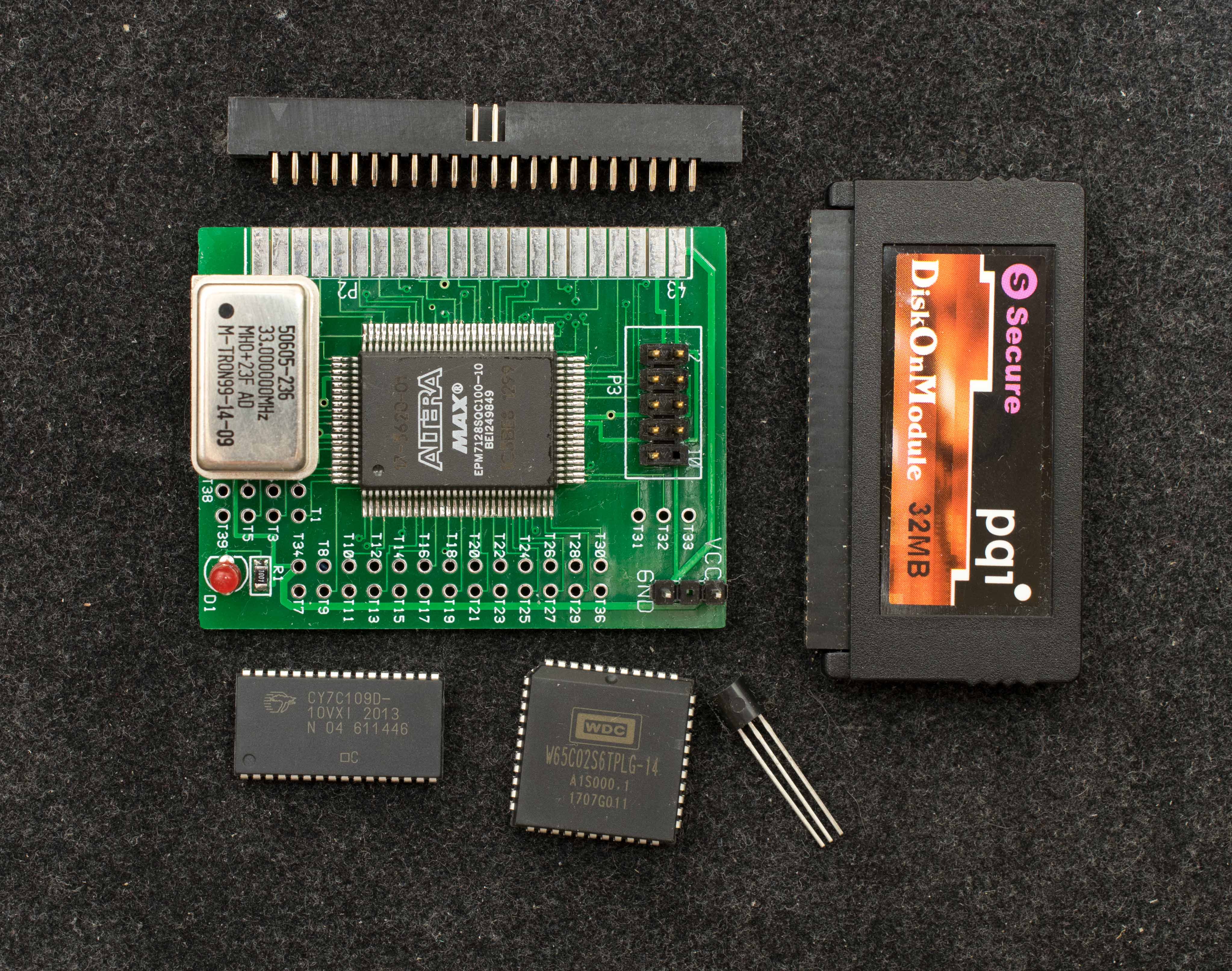

Picture show the components I plan to use, and how they'll be put together. The CPLD board is the base, W65C02 in PLCC44 package is in the middle of stack and 10nS RAM is on top. 6502 has fixed pin assignments, but RAM and CPLD's signal assignments are flexible which is important to achieve short point-to-point interconnects. This should be a functioning computer with mass storage and capable of running DOS/65
Even with short point-to-point interconnect, I expect this to be a messy ball of wires!

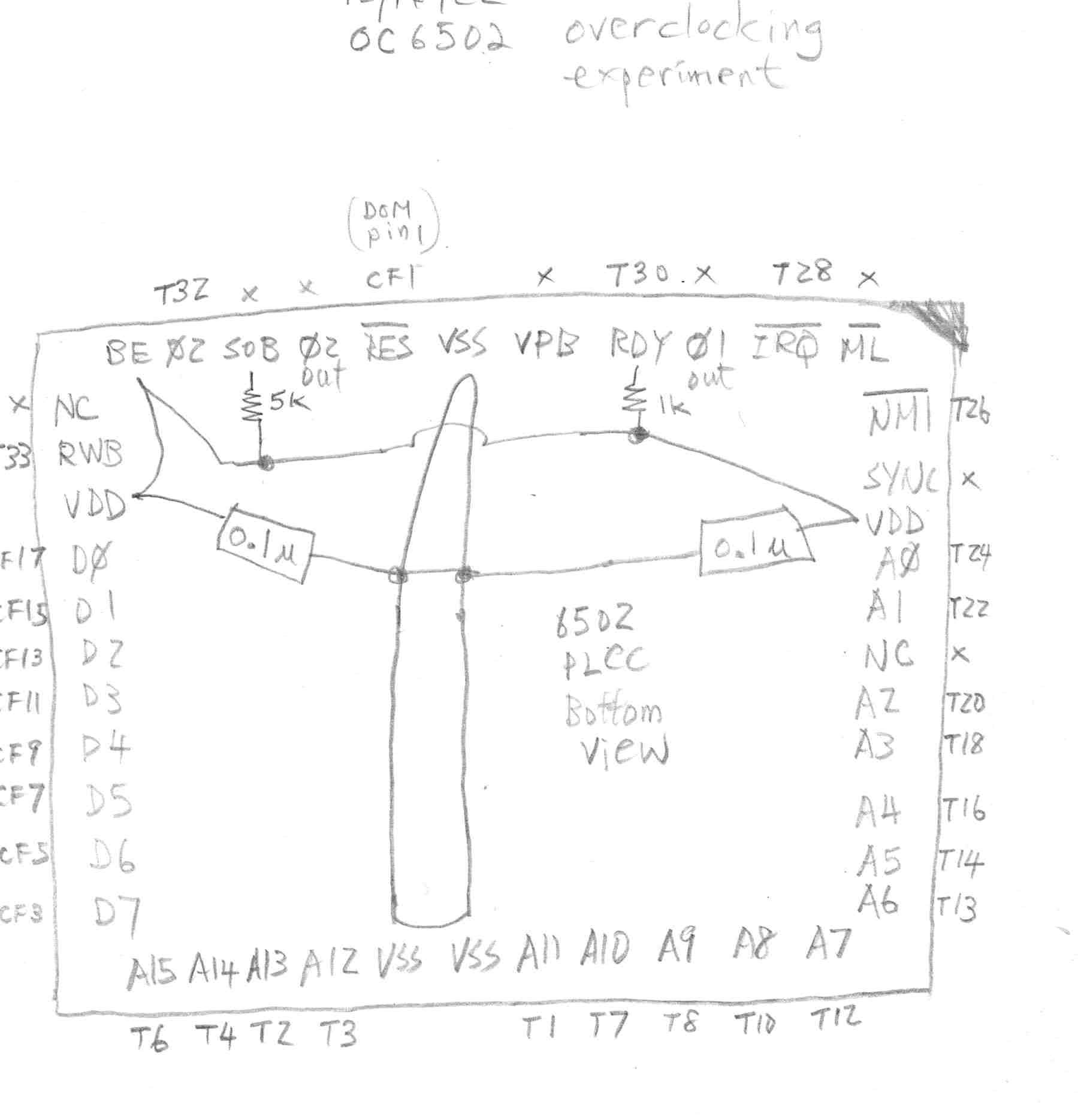

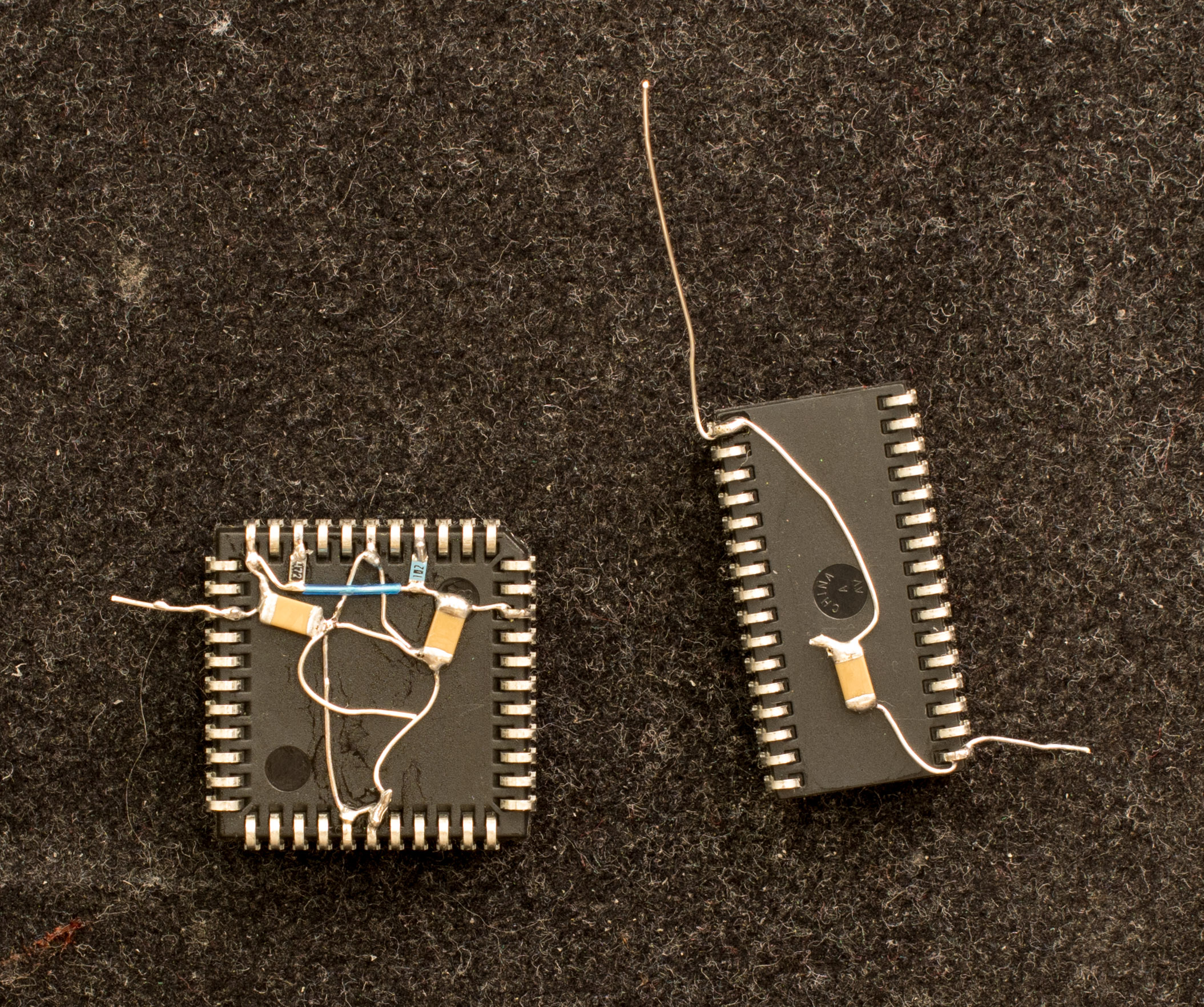

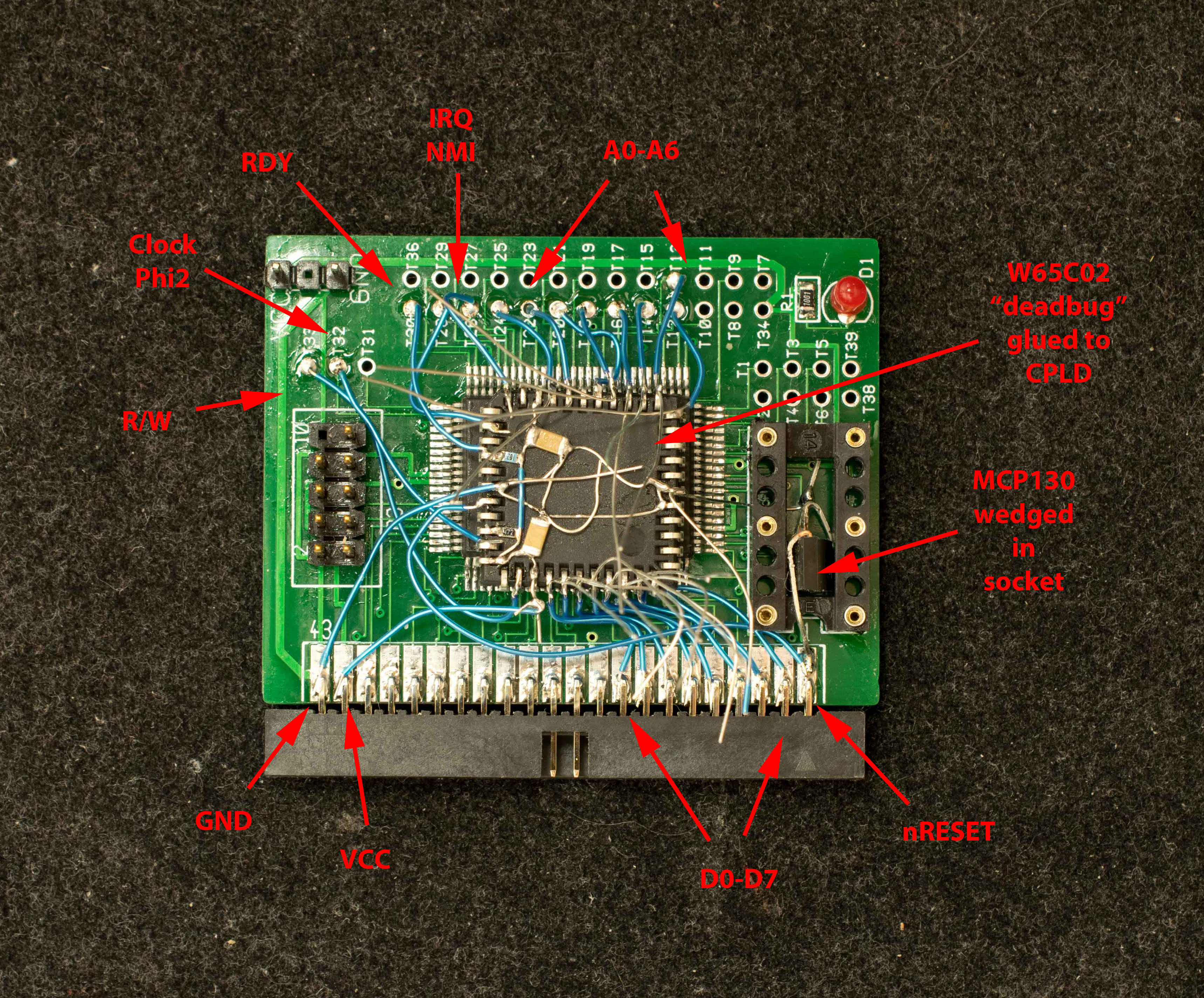

Attached are schematic, assembly guides, and a picture of W65C02 & RAM partially wired up. I built up most prototype boards using the assembly guides only, schematic is for big picture and seldom referenced during construction. In this case the schematic is even less useful because the assignment of CPLD's test points to various signals of 6502 and RAM are based on proximity to the pins, so the schematic is back-annotation of the actual construction.

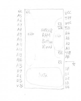

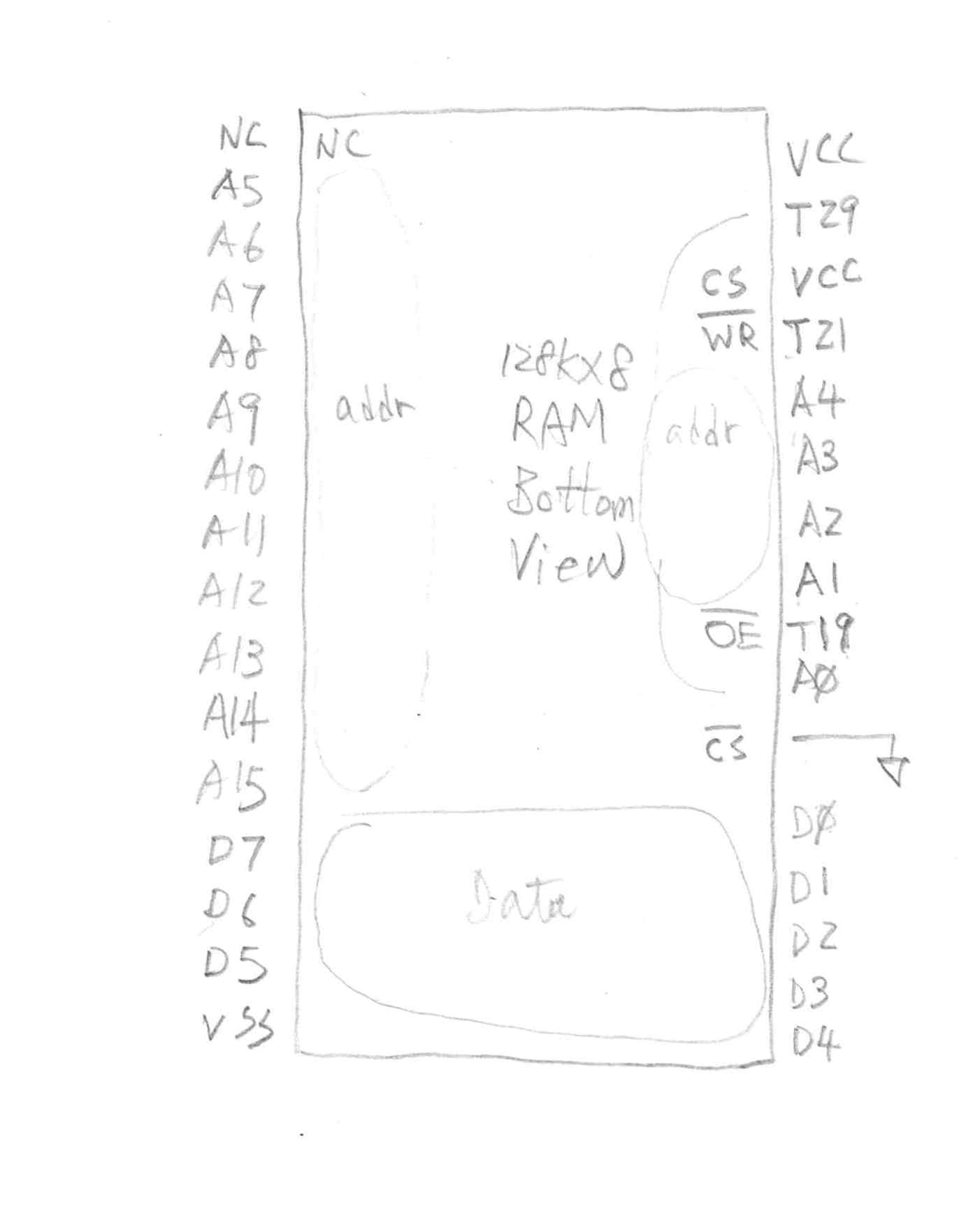

Yes, that's just solder flux residue. It is not necessary but I like to wash off the flux with IPA to get better picture of the connections.
In this picture the W65C02 is glued to CPLD "dead bug" fashion. Most of the connections to W65C02 are wired in, enough to install the RAM on top of W65C02. RAM won't be glued in, it will float above W65C02--not ideal but that's what I have to work with given the geometry of the parts.

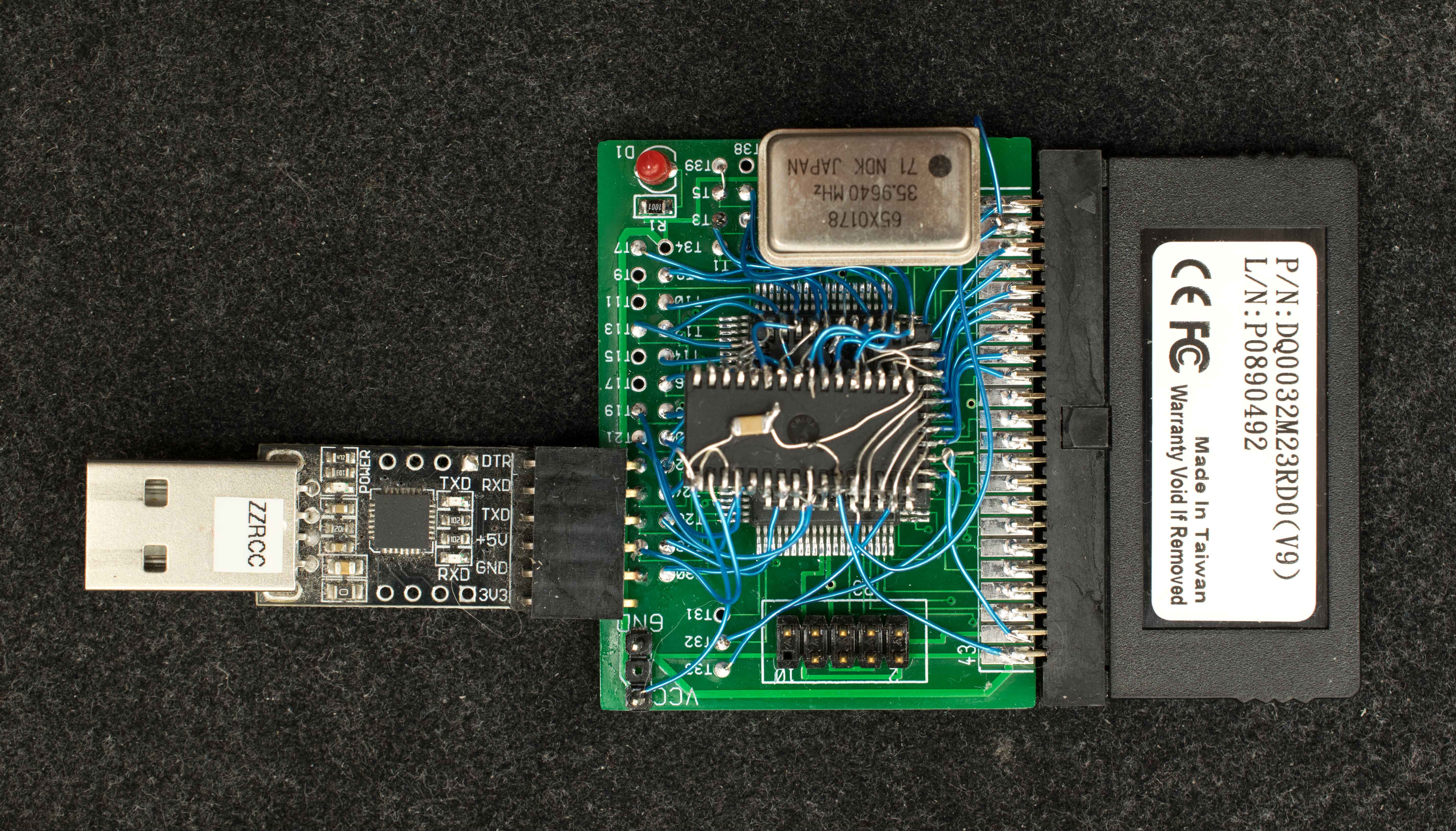

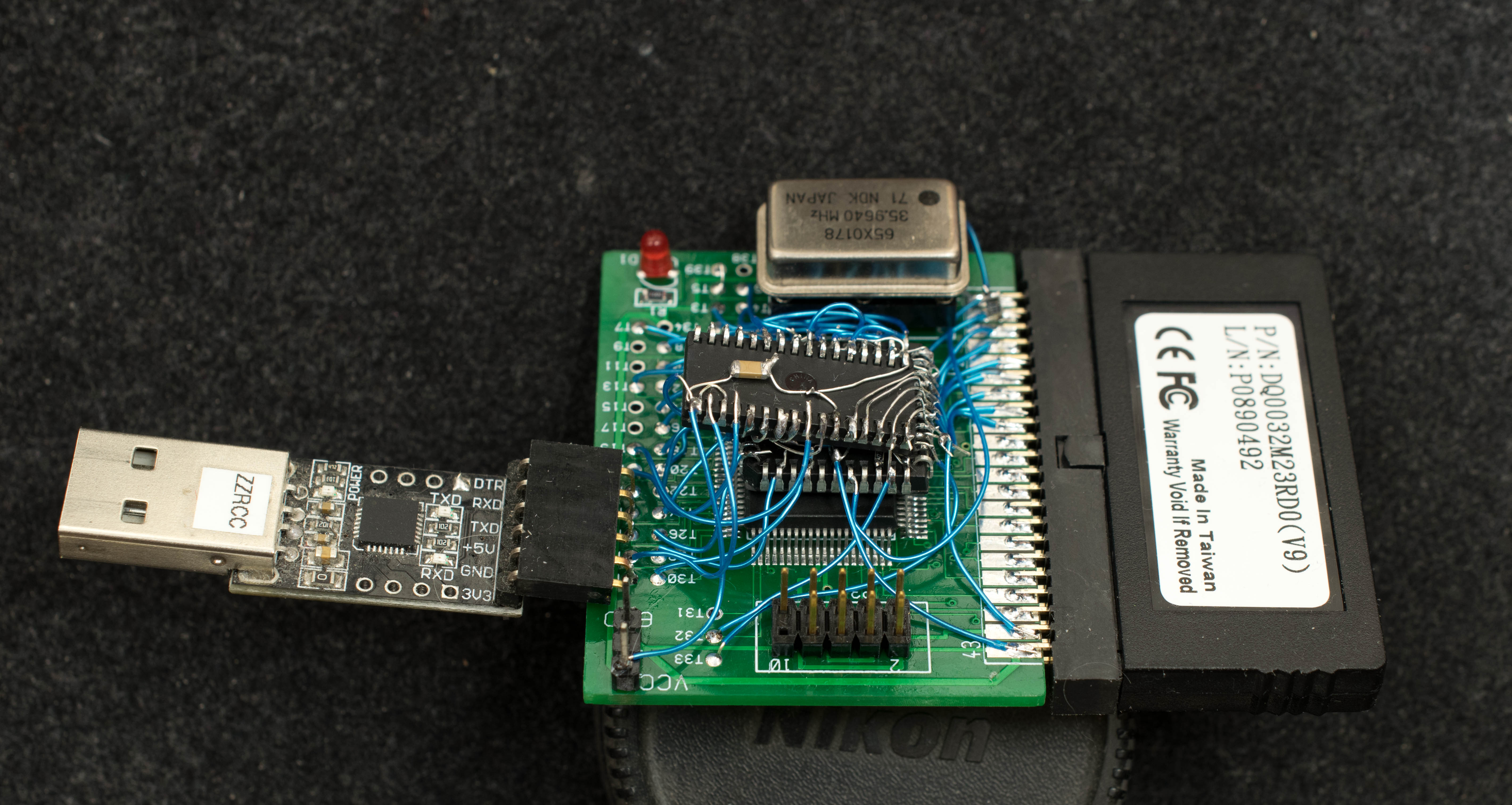

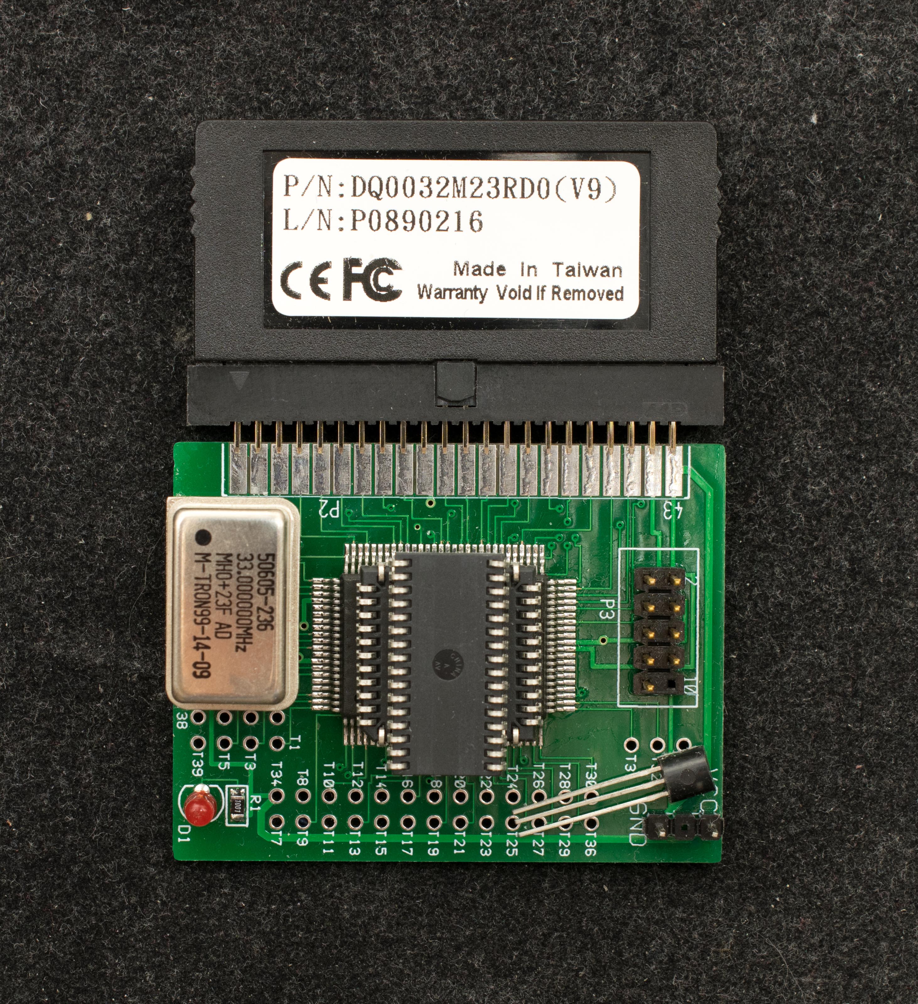

This is the completed prototype with RAM installed on top of W65C02. Not a pretty sight, in fact, if ever there were an "ugly computer competition", this surely will take a blue ribbon, possibly "best of the class"! In the picture it is shown with USB-to-serial adapter and DOM disk connected.
I did applied the power and no smoke came out and there were signs of life. I'll start testing it with simplest NOP test and see what it can do.

Start testing without the DOM disk.
* a simple serial transmit test that repeatedly bit-bang out a character to serial port will run to 40MHz IF the supply voltage is raised to 5.4V. The current draw is 250mA @ 5.4V. This is likely the upper frequency limit of this board. At 36MHz the circuit is very stable. I don't have oscillators between 40MHz and 36MHz so I can't tell at what frequency it started to work reliably.
* At 36MHz, nominal 5V, current of 205mA and still without DOM disk, I'm able to serial bootstrap and load a monitor program to poke around the system. I can load a memory diagnostic and run memory test successfully.
The results are similar to my overclock experiment with W65C816 which also operated at 40MHz at elevated 5.4V but ran reliably at 36MHz at normal 5V.
I'm pleased with 36MHz because it happens to be SVGA (800x600) frequency so beam racing SVGA with W65C02 is now a possibility.
Onward to more testing with DOM disk installed.
