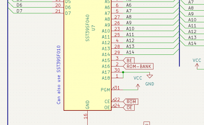

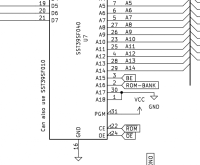

When BE is high, the 6502 runs as usual. When BE is low, the addr and data buses go to high-Z, which allows for my '590 counters to jump onto the address bus and talk to the RAM and ROM directly for the video colors and signals. I do this while PHI2 is low, so thus:
BE high -> PHI2 high
BE low -> PHI2 low
On this particular build, I forced BE to only go low during the second half of PHI2-low, allowing for the PHI2 falling edge to have the address and data buses unaffected. Essentially the BE line is saving me about 3x '245 chips.
But now that we are talking about it, I have something small to alter. I'm going to replace the A15 line on the ROM with BE instead of PHI2. Attached is the change. Thank you BDD.
I'm not seeing what you changed due to your graphic having color combinations I can’t discern.
Just attached the B&W version too, sorry about that BDD.
