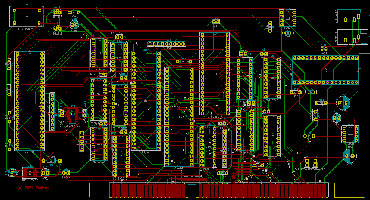

I developed a PCB for the project which is a 4-layer PCB. I hope it is okay as it has 3 signals layers and a ground plane. I made the power signals double-wide. There was some trouble getting the design to auto-route and I had to route some of it by hand. Routing around the clock synthesizer was nasty as this was a SMT chip. To place the chips the auto-placer was used, then the result was modified. The I/O components needed to be moved to the edge of the board. The whole circuit fits into a medium length ISA card format.

Not yet. I am redoing the PCB as a two layer PCB. A four layer board with internal signals has a higher engineering cost. Auto-router has been running about 8 hours now. It is into optimizing the number of vias and trace length, and has managed to route everything using two layers.

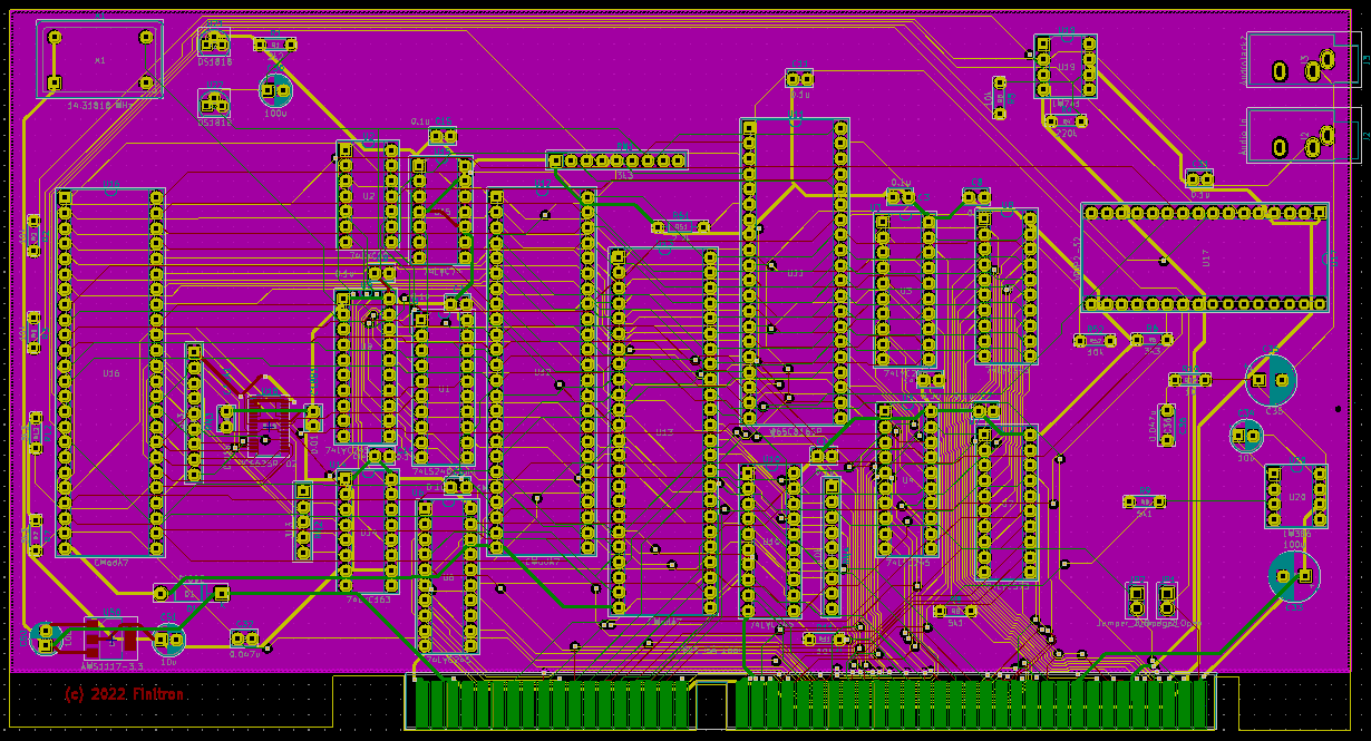

Be sure to make a fine mesh of ground connections, and one of power connections, like Chad did at viewtopic.php?p=92852#p92852 and shows in his VCCandGNDlayout-Color.pdf attachment. The autorouter will need some manual help.
The following is from the AC-performance construction page of the 6502 primer:
    For cost-sensitive situations where someone feels limited to a 2-layer board, I frequently see recommendations to make the power traces super wide. This has been very much overemphasized and misunderstood. It's hard to get the myths to die though. Resistance is not the problem, and an .008"-wide (0.2mm) trace can handle 500mA with ease. The real enemy is inductance, and making a trace wider on a 2-layer board with no ground plane has very little effect on its inductance. Doubling the width of a 2"-long trace on 1oz copper, from .010" to .020", only brings the inductance down about 10%, according to this flat-wire (trace) inductance calculator. IOW, it has almost no effect. Wanna go wider? If we widen it from .010" to .050", ie, multiplying the width by five, the reduction in inductance is not even 25%. [...]
    So if you're limited to two layers, route a fine grid of ground connections, so there's the least impedance from the ground pin of any one IC to the ground pin of another IC, then get the bypass capacitors connected with the shortest practicable connections from each IC's VDD pin to its ground pin (which might mean putting them on the back of the board, under the IC). Then route all the signals, and then sew-in a VDD grid with the room that's left. An autorouter won't have the intelligence to do a very good job at that; so I would do the ground and VDD connections by hand.
Making the power and ground traces the same width as your signal traces will probably allow you to get a finer grid of them in.

Got what I was after with this version; an estimate of the cost which turns out to be about 1/3 that of the first version. Still some work to do taking Garth’s excellent advice and laying out the power and ground signaling before auto-routing. One thing I may drop is the frequency synthesizer. I do not think I can solder it and the ‘163 used to control the wait state can be used to divide the clock frequency down too.
Used a trick of making the power signals wider so they can be seen on the PCB viewer. I was curious how well the auto-router could route the power signals.
I may leave the heftier power/ground as I am not sure what the draw of the FPGA modules is. I think they can use up to about 1W depending on the circuit which is 300 mA each at 3.3V. A more realistic estimate may be 200 mW or 60 mA.
