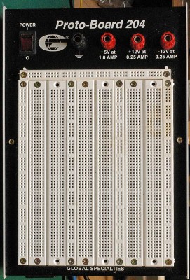

Re: Do I have a faulty 65C02?
I've had good luck with 3M (A P Products) and Global Specialties. Equal sized boards from Global Specialties are about 1/4 the cost the the 3M ones and you can get bare breadboards (not mounted.) for under $15. The ones below are what I use. The 3M one dates back to the 80s and is still working great. Neither is cheap though. Your looking at $400+ these days. The G-S one has a 3 voltage supply built in. Just the mounted boards would run about $100.
