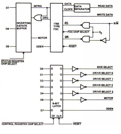

The motivation for this is that the Rockwell Forth ROM has built in code for floppy disk control, so the software side is done. The documentation on this shows a block diagram of possible hardware using a Western Digital 1993 controller. This particular chip requires a lot of support circuitry to interface with a drive, but the newer 1793 has all of this built in, and the data sheet says that they are register compatible. So it should be possible to build a relatively simple controller using the 1793. This was a very common floppy controller back then and most of the more modern controllers were backward compatible (The main exception being the NEC 765 controllers).

I'd guess that the WD37C65C would be similar, but probably includes the input and output registers that I implemented with the 74LS logic. So it should be an even simpler design. And it would probably support HD disks too.

This is the floppy interface diagram from the Rockwell Forth Manual:
