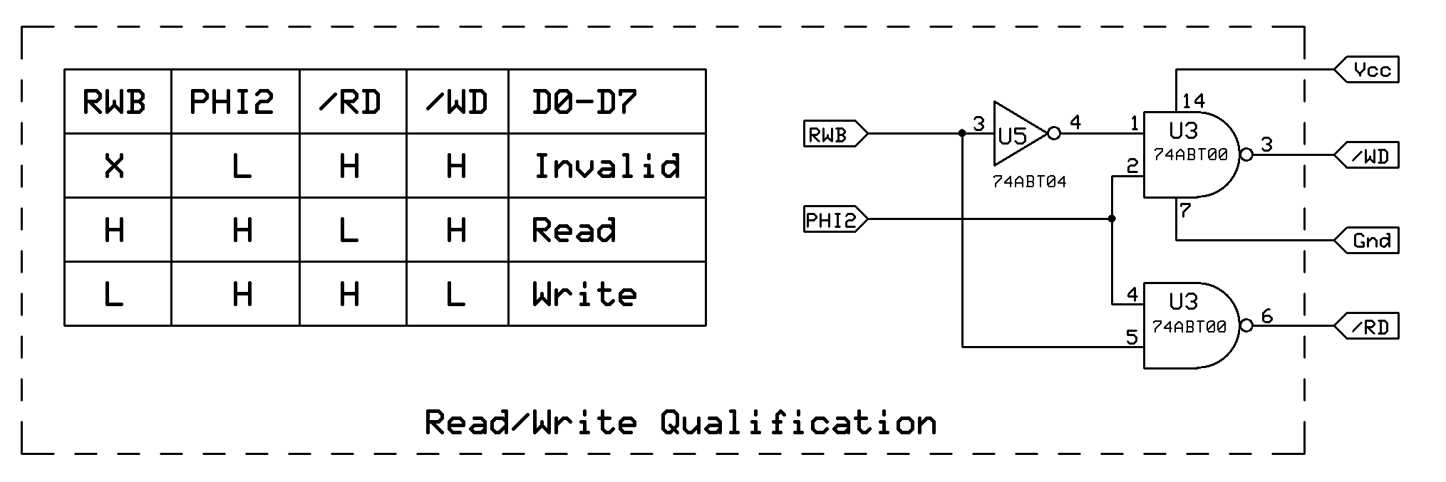

I used to gate RW and PH2 using the usual NAND schematic that seems to be the accepted standard. This works well, and only adds the propagation delay of 2 NAND gates at most, so let's just say it has about 16 nanoseconds of delay.

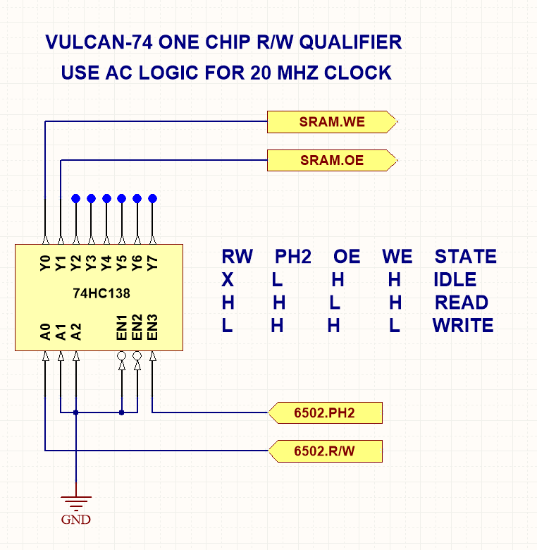

I wasn't satisfied with that, so I tried a ton of different schemes to finally come up with the one shown above that only introduces 4 nanoseconds total!
This is of course using AC logic, but even with plan old HC (8 ns delay) logic, 18 MHz was stable.
The secret sauce : using a single 138 as the RW/PH2 gating.
I call this setup stable at 20MHz because it will actually do 25MHz, and breaks down around 28MHz. This is my margin of safety.

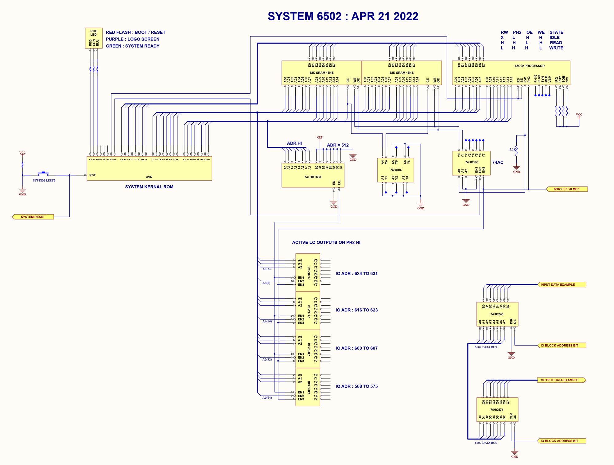

My IO decode logic is also greatly simplified, feeding the address and select line of the four 138s directly form the lower address bus after triggering the chain from the higher bus at address 512. This is working perfectly on my massive board, and the 65C02 is a real performer now!
Also not that this is the WesternDesgin 65C02, not the TTL version, and I am running fully from 15ns SRAM that has been boot loaded with my Kernal.
A system kludged down with ancient ROM would probably never achieve this level of speed without some serious variable clocking magic.
I am also using my slowest (15ns) SRAM with an inverter to tie the 32K together. I bet 25 MHz or better is possible with 10ns SRAM!

I’m not able to read the entire schematic, but I can make out two things that might warrant review.
74HC logic is likely too slow for reliable operation above 10 MHz. I use 74AC logic in my POC units. POC V1.3 runs at 16 MHz, and its predecessor runs at 20 MHz. 74AHC performs at the same level as 74AC, but with less-aggressive outputs.
Chip selects should not be qualified by Ø2. Doing to significantly shrinks the the timing window from when the address bus becomes stable (about midway through Ø2 low) until the selected device is ready for access. Best performance is achieved by allowing selection to occur during Ø2 low and using Ø2 to qualify read/write operations, especially writes.

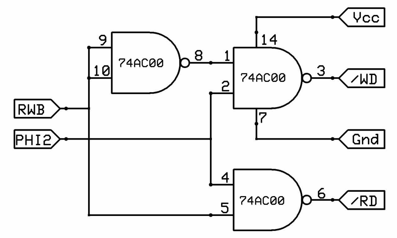

Here is the basic RW + PH2 Qualifier with the other stuff removed.
I have had this running @20MHz for several weeks, using the entire 64K SRAM without any glitches.

Yes, HC offers only 14MHz operation on my board.
With the AC, I can do 25, which is why I consider 20 to be "safe".
I will have to think about your statement, but unless I am missing something, my circuit does exactly what this does, minus the extra gate delay...

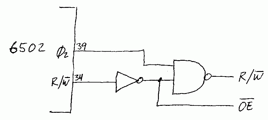

Also the same as this simpler version (used to use this)...
Also, I never use CE on SRAM. In fact, you can do away with OE in some cases as long as you have a bidirectional buffer.

Some pieces seem to be missing from the schematic. Is it in color?
What extra gate delay? On the WDC 65C02, RWB is valid well before the rise of Ø2. So the inverter’s output will already be reflecting the state of RWB when Ø2 goes high, which means there is effectively a single gate delay.
You should know that I have a derivative of that circuit that works at 50 MHz in a test rig, 50 being the highest frequency for which I have an oscillator in my parts pile. Here's the derivative, which is a single-chip solution:
Single-Chip Qualified Read/Write
With most SRAMs, the time from when /OE is asserted until data is emitted is always shorter than the time from when /CE is asserted. Cypress, in particular, recommends /CE be asserted as soon as a valid address appears and that output be gated with only with /OE. Their timing diagrams clearly illustrate that asserting /CE before /OE will produce faster response.

In that case dude, your Jedi skills are at a level I can only dream of.
I thought I was doin' good with a 6502 at 20MHz!
Please post a schematic (with RAM), I would love to see my system push 50Mhz!
Even using an FPGA with very tightly controlled delays, I could not get 50MHz out of a 10ns SRAM.
For now though, I shall continue with my 138 solution, which so far has yielded my best performance, even when put up against the other 2 solutions shown above.
I do want to know more about your 50MHz rig though!

You misunderstood me. I tested the read/write circuit at 50 Mhz, observing its behavior on the scope. No microprocessors were involved.
My POC V1.2 unit runs at 20 MHz. POC V1.3, the current unit, is stable at 16 MHz. Due to prop time associated with bank latching and its effect on the clock-stretching circuit that wait-states ROM and I/O, things go off the rails around 18 MHz. The next rendition will use a CPLD to handle glue logic and latch the bank bits, which should improve the timing picture.

I guess our timing circuits are really dependent on our designs. With mine, I latch out about 30 8 bit values to various 574s on my board, and read 4 values provided by the 245s. Each of those is enabled by the outputs on my 138 decoders. I found that with the AC138 gating RW/PH2, I only required HC138s in my decode.
I checked again, and my system runs fine 1t 25 MHz, breaking down around 28 MHz.
So 20 MHz seems to be the magic number in my design.
In one past experiment, I also drove PH2 at 25 MHz from an FPGA, splitting the HI phase to be about 75% longer than the LO phase. This was stable, but highly complex.
I used the FPGA block RAM as well, so we can say that it was about 6ns access time.
Since I only hoped for 10 MHz speed on this project, I am going to consider 20 MHz a total win.
