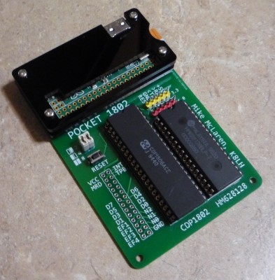

Sorry you're not interested in a Pi based solution. I really like the "bare metal" PiGFX serial ANSI terminal running on a $5 Pi Zero with my USB wireless keyboard and mouse and HDMI video monitor. Only caveat is that it refuses to work (for me) with a uSD card 2-gig or larger (I used a 64MB uSD card).
