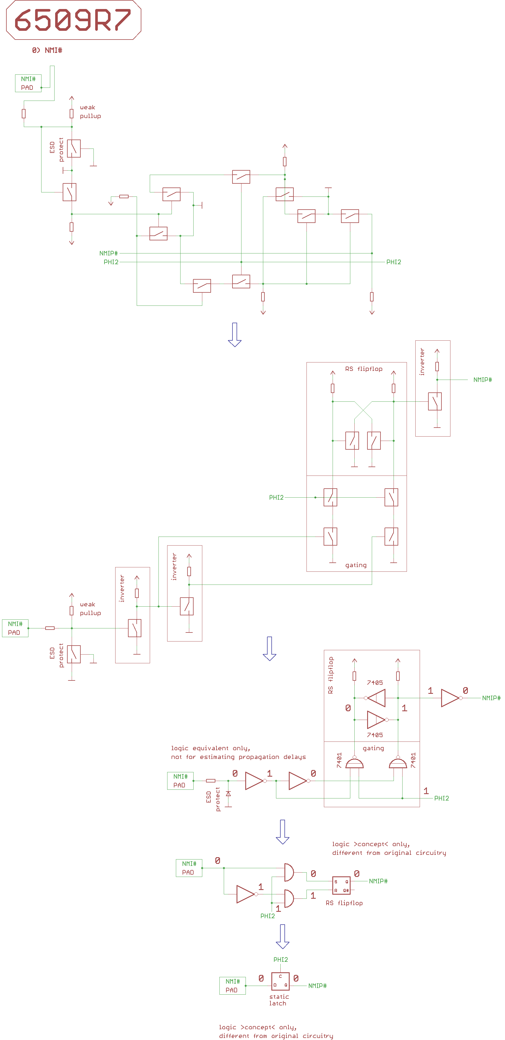

Re: 6509 dissection: the remaining pads
0) NMI#
//Falling edge at the NMI# input triggers a non_maskable interrupt.
There is a weak pullup resistor (FET) tied to the NMI# pad, 20 kOhms maybe.
Plus the usual ESD protection circuitry.
The Signal from the NMI# pad goes through two inverters,
which are feeding a transparent fully static latch.
The static latch samples the inverted/buffered NMI# signal at PHI2,
and gives out NMIP#.
NMI# and NMIP# have the same polarity.

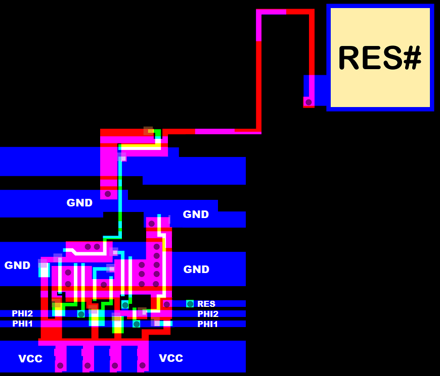

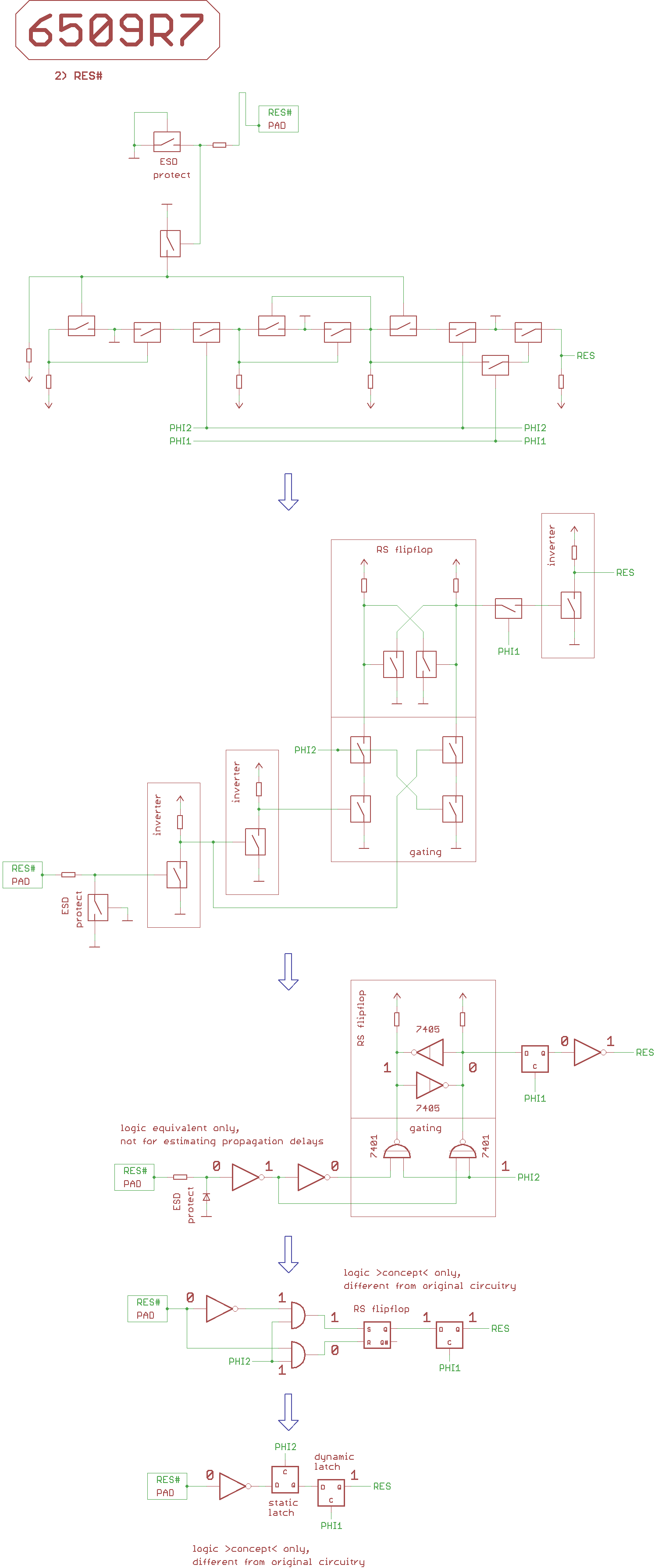

2) RES#
//RES# input low puts the CPU into a reset.
The game isn't too different from "1) IRQ#".
The RES# pad has ESD protection, but no pullup.
The low_active RES# signal goes through two inverters, which are feeding a fully transparent static latch.
The static latch samples RES# during PHI2.
The output of the static latch is sampled by a dynamic latch during PHI1,
which gives out the high_active RES signal.

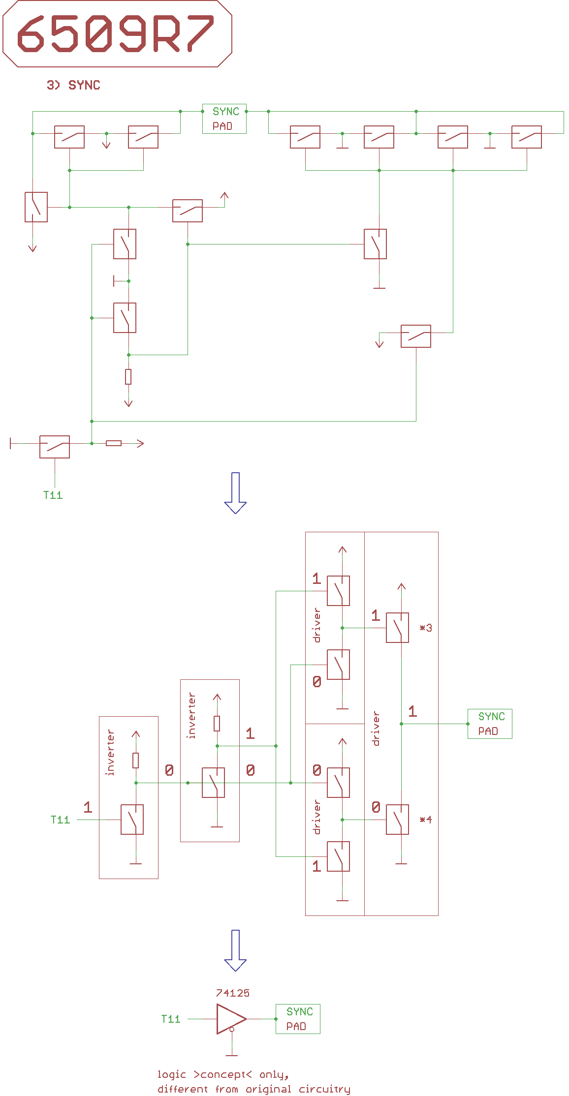

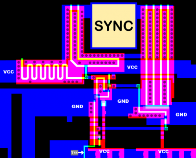

3) SYNC
//When the CPU reads an instruction from the data bus, SYNC output goes high during PHI1 for the rest of that cycle.
Just a non_inverting driver, fed by the T11 signal from the sequencer, driving the SYNC pad.
