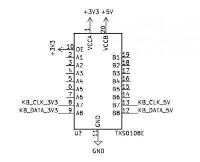

This worked well, but it took up a bunch of space on my board, so I decided to try my hand at a proper bidirectional level shifter, and landed on the TXS0108E (which seemed to be like a good fit, particularly given that, at some point, I also want the MCU to talk to the 65C02 side of the circuit, which also runs at 5V). My circuit looks a little like this:
(Note that the TXS is on a breakout that also includes decoupling capacitors.) I don't have any pull-up resistors here, because my understanding is that the TXS has them built in—and, indeed, the lines are high on both sides when there is no activity.

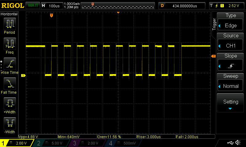

Now to my problem: for some reason that I do not understand, the signal on both lines looks like this:
This is the data line, as the keyboard is trying to send data to the host. You can kinda see the transmission happen, but it's dirty and causes all kinds of spurious readings at the keyboard end. If you zoom in to the solid-yellow areas, they turn out to be some kind of very tight sine wave at ~2x the clock speed of the keyboard.
This only seems to happen if the keyboard is connected to the TXS breakout board. As far as I can tell, is happens regardless of whether the MCU is connected at the other end. (FWIW, the MCU's pins connected to the lines are both set to inputs.)

Try tying the unused A pins to VccA & unused B pins to VccB.
Use your 'scope to measure each of the IC pins. Are Gnd & VccA & VccB present & clean?

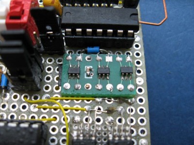

I suspect the TXS0108E is not an appropriate replacement for an Open Collector driver in this use case. An Open Collector driver can pull low but, by design, it has no ability to pull up. (You were probably using the MOSFETs in the same way. :wink: ) I'm half guessing, but maybe the TXS0108E is pulling up at times, and that's what's causing your difficulty.
If you want a space saving alternative to a MOSFET, you can consider using one of the tiny gates in the 1G and 2G series. There are numerous offerings, including a few Open Collector (actually Open Drain) devices. See my post, Tiny, superfast gates rival programmable logic.
Note that a 74LVC2G06 dual open-drain inverting buffer will replace two MOSFETs.
I'm attaching a photo of three 1G Series devices located on a breakout board. These are SOT-23 packages, but even smaller options are available. The SOT-23 is plenty small enough for me! :shock: :lol:

Well, I couldn't wait for the new parts to arrive, so I jury rigged the PS/2 port with—I kid you not—a couple paperclips, and connected all the unused lines to VCCa/b as leepivonka suggested, and lo and behold:
So, it seems that that was the problem. Thank you so much for your suggestion! Now for a follow-up: Is this the kind of thing that one is just “supposed to know” based on experience, or is it explained somewhere on the datasheet? I find these documents hard to read, probably because they assume the level of knowledge that makes sense for an EE, but not for someone like me who is just starting out.
