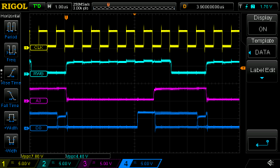

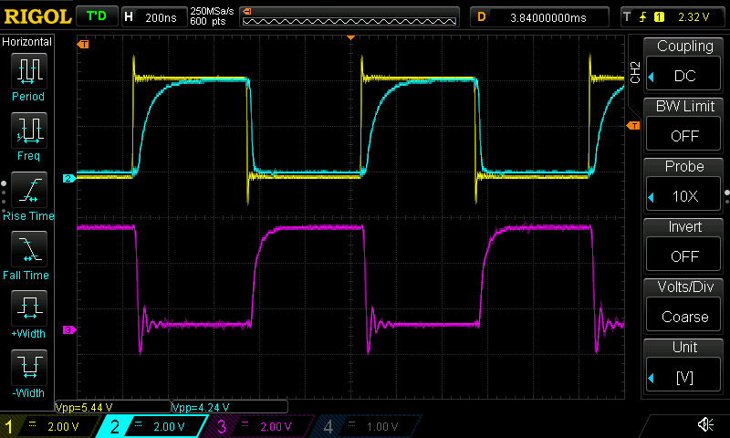

Just in case it's helpful, here's a crystal oscillator external clock to the Φ0 input (yellow) vs. 6502 Φ2 output (cyan) on an old NMOS 6502. (That's the Φ1 output in pink below.) I don't know the exact manufacturer or date of this CPU because it's been relabeled, but from the power consumption (>100 mA) it's definitely NMOS. You can see that there's considerable delay there, though most of it comes from the slow ramp-up of the leading edge; there's little delay on the falling edge.
That's from my RC6502 Apple 1 clone SBC board. I've got some more timing examinations of Φ0 vs. Φ2 vs. RWB on that board that I'll put together and post in a subsequent message, in case that provides any illumination on this topic. (Or maybe in a different topic if I'm finding myself too confused about them.)

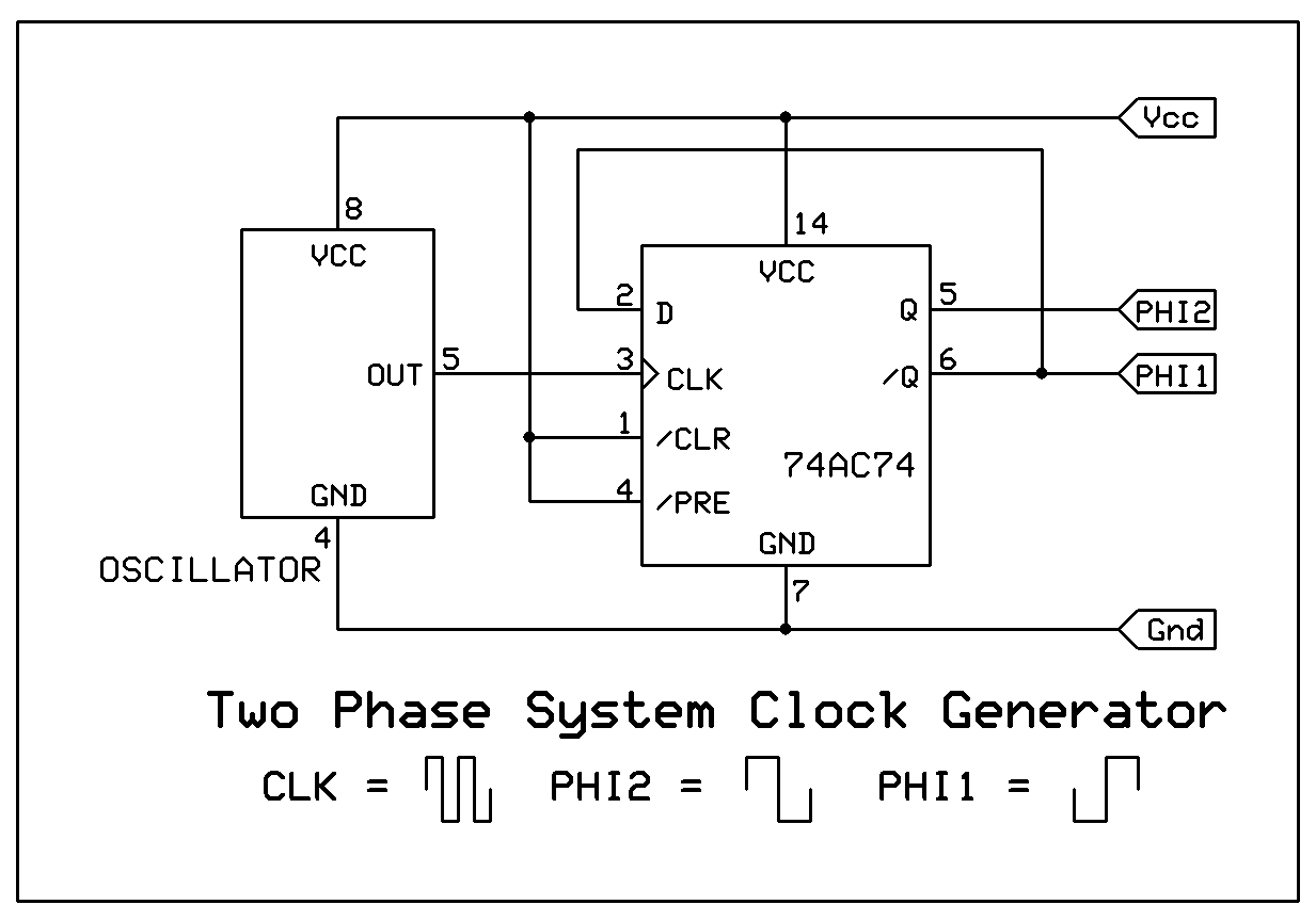

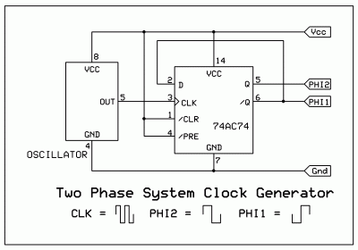

Here's the clock generator I used in POCs V1.0, V1.1 and V1.2:
File comment: Two-Phase Clock Generator

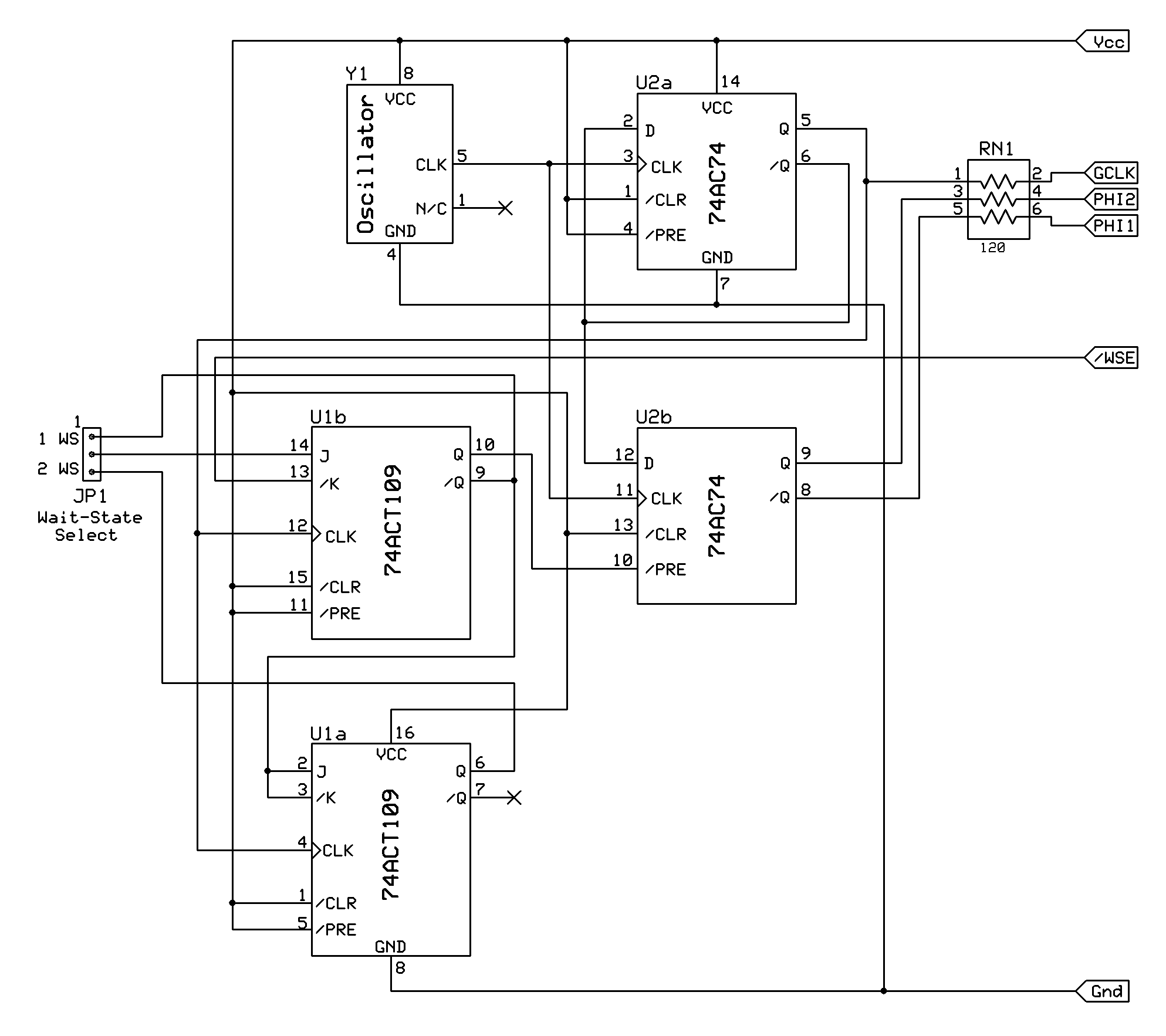

An augmented clock generator is used in POCs V1.3 and V2.0:
File comment: Stretchable Two-Phase Clock Generator
The above version can be stretched on the high phase to produce one or two wait-states, depending on how jumper JP1 is set. The wait-state is "armed" when the /WSE signal is driven low during GCLK ("global clock") low. When GCLK goes high the wait-state commences. PHI1 will stay low and PHI2 will stay high for one or two GCLK cycles, according to how JP1 is configured. The MPU will halt with all outputs "frozen" until the next fall of GCLK.
Note the use of a 74AC74 in both circuits to produce the clock outputs. WDC MPUs require a clock input that swings from ground to VCC and has no more than 5 nanosecond rise/fall time. Other CMOS logic types, although able to meet the output amplitude requirement, may not be able to meet the rise/fall times.
The 74AC74 can source/sink 24 mA, producing a robust clock with a rise/fall time well below the maximum of 5 nanoseconds. However, the extremely fast edges will likely give rise to some ringing, which can be suppressed by various means. Series resistance placed physically close to the flop's outputs will help, as illustrated in the "stretchable" clock circuit.
GCLK is not affected by wait-stating, since it is driven by the Q output of flop U2a. In addition to supplying the time base for the 74AC109 J-K flop, GCLK is meant for use with 65xx peripherals, especially the 65C22. Were the latter's Ø2 input to be connected to PHI2 in the above circuit, the C22's timers would stop any time a wait-state was in effect, even though the C22 wasn't being selected at the time.

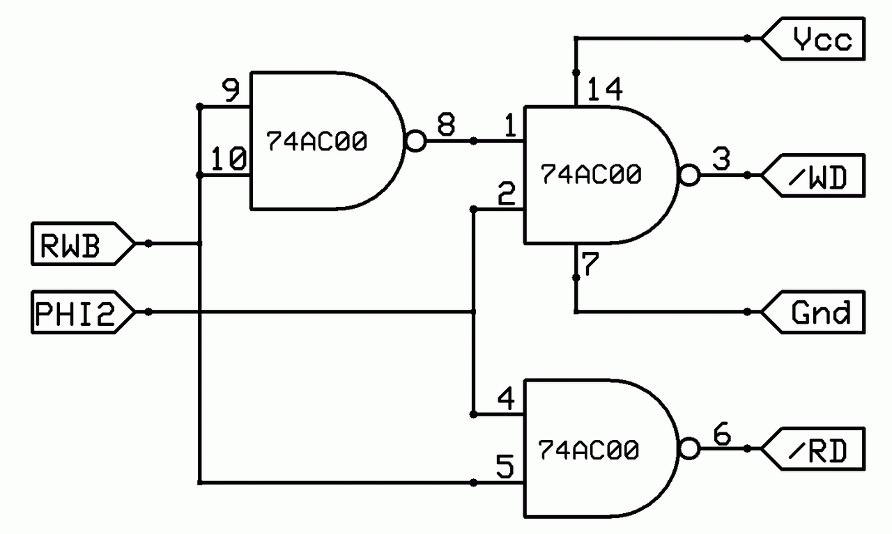

In my POC units, RAM, ROM and I/O all have separate /RD and in the case of RAM and I/O, /WD control inputs (aka /OE and /WE). Therefore, these signals have to be derived from the MPU's RWB output, using Ø2 to qualify the signals.
File comment: Fully-Qualified Read/Write Generation
This entire circuit can be implemented on a single quad NAND—the fourth gate can be used to invert the MPU's low-true reset to produce a high-true equivalent for devices that need it (e.g., the NXP 28L92 dual UART). It illustrates use of a 74AC00 but other CMOS types could be used, 74AHC00², for example. 74HC00 in this application is okay up to about 10-12 MHz, beyond which prop delay may become a concern.
In a 65C02 system, the gated /RD signal may seem unnecessary. Consider, however, that an I/O device may react badly to having its /RD input asserted during Ø2 low, when the address bus is momentarily unsettled. An ill-timed access of this sort may cause trouble if a read-sensitive register is accidentally "touched." Such an event can be completely avoided by using /RD.
In a 65C816, use of /RD is mandatory, since the 816 drives the data bus with the A16-A23 bits during Ø2 low. If /RD is not used, bus contention will occur and the A16-A23 bit pattern will be garbled.
A design feature I occasionally see in 6502 systems is use of Ø2 to qualify chip selects. I recommend against doing so, primarily because of performance implications. If a chip select isn't asserted until Ø2 high then the device will not be ready for access until some time after the rise of the clock, narrowing the window during which reliable access is possible. This will set a hard limit on the maximum clock rate that can be run.

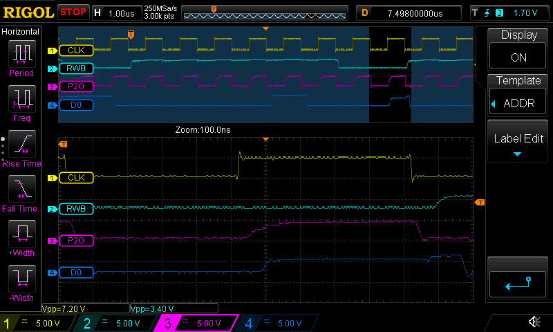

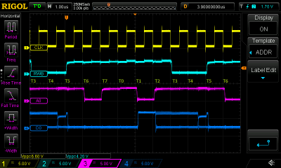

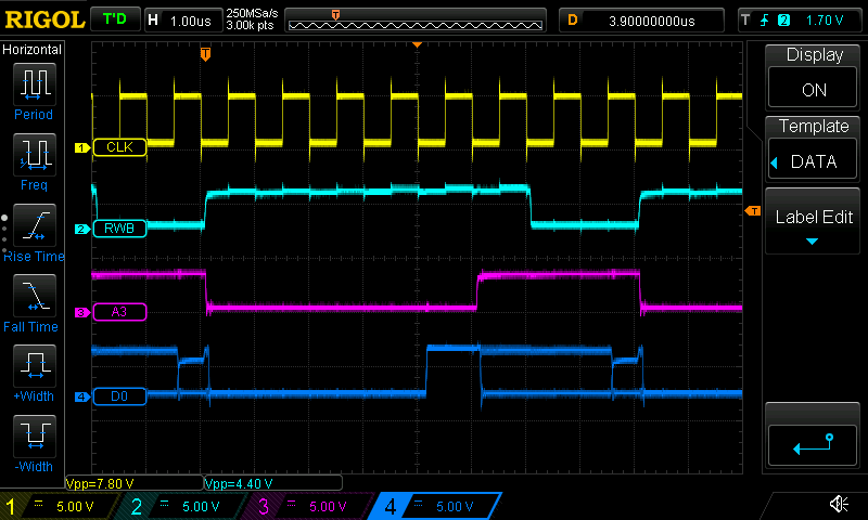

BDD, thanks for your detailed answer. Though I'm operating on the assumption that the external clock will always be clean and properly conditioned, it's good to remember that one needs to be careful to achieve this or it may affect what otherwise would be working timings. I use a can oscillator on my RC6502 Apple 1 clone SBC, and intend to continue using those on other boards.
Last week I 'scoped out my Apple 1 clone SBC to look at some of the timings related to Φ0 (the CPU clock) and Φ2 (the system clock output from the CPU). I was focusing on the data bus here. I now realize I actually wanted to be looking at the address bus, but something of a little concern to me came up with the data bus signals, so I thought I'd post this here both to get confirmation that I'm looking at these things properly and get thoughts on the data bus timing.
The code I'm using to test is a tight loop incrementing a location in memory. Below I gave the address in binary (LSB only) and hex, the data in memory and the assembly language code. I kick the machine off by jumping to $80; the loop is obviously $81-$84. The code at $85 returns to Wozmon; this is executed only if I change the BCC to a BNE to run the loop only for a short time. (I used this to test the code.)
    7.adbit.0   addr    data        disassembly
    0111.1111   007F    nn          (incremented location)
    1000.0000   0080    18          CLC
    1000.0001   0081    E6 7F       INC $7F
    1000.0010
    1000.0011   0083    90 FC       BCC $0081
    1000.0100
    1000.0101   0085    4C 1F FF    JMP FF1F
    #   Alternate for testing code; return to mon after incrementing to 0
    1000.0011   0083    D0 FC       BNE $0081
    time  addr  data    action
     T-2   80   r 18    read opcode     CLC
     T-1   81   r E6    execute         CLC
     T0 0  81   r E6    read opcode     INC zp      p. A-8
     T1 1  82   r 7F    read addr       (zp)
     T2 2  7F   r n_    read data
     T3 3  7F   W n_    execute increment           !!! book says read cycle
     T4 4  7F   W n+    write data
     T5 0  83   r 90    read opcode     BCC         p. A-13
     T6 1  84   r FC    read offset
     T7 2  81   r ??    offset added to PC (seen on addr bus)
       (3)              (skipped because branch doesn't cross page boundary)
Below the code I have the actions of the CPU worked out cycle by cycle. The details for the cycle behaviour of each instruction were taken from the MOS MCS6500 Microcomputer Family Programming Manual and then confirmed against the timing capture. The T-times above are annotated in the capture below. This is followed by another capture with A3 instead of A0 on the third channel, as that helped confirm that I was correctly differentiating between the program reads (A3=0) and data access (A3=1).
So as I mentioned, this experiment turns out not be properly set up to confirm that the address lines change well before Φ0 rises (which of course would also be well before Φ2's later rise). But it does show that the data bus appears to be changing well after the Φ0 rise on which we'd enable a write, and even probably a little after the Φ2 rise. (The latter is harder to determine because it's not a sharp edge.) Following are a couple of single-shot captures of a loop execution where D0 (which changes with every loop) goes from 0 to 1 and 1 to 0, with the third channel now showing Φ2 instead of an address line. The top-half of the capture is at the same time base as the captures above, with a selected area marked, and the lower have is a zoom in to that selected area to make it easier to see the exact relationships between the signals when D0 changes.
I see two things here that worry me.
First, RWB asserts write on cycle T3, while the CPU is still incrementing the value its read, as well as asserting write on T4 when it's writing the now-incremented value. The is not what the book says it should be doing, and this will cause the previous value to be rewritten just before the new value is written. Obviously this isn't a big deal for RAM, but it seems to me it could be problem for other devices, such as output ports that trigger an indicator to a remote device on write (such as with a 6821 PIA's control output pins in certain modes). Those might see this as two sequential writes of the old and new values, rather than just a single write of the new value. Is this kind of thing to be expected with the INC instruction, making it something that just generally should not be used for I/O unless "extra" writes are acceptable?
And second, I notice that the data lines are changing after the Φ0 rise that one might use to qualify the write, and even around or possibly after the Φ2 rise that this board uses to qualify the write. I think this is not a problem for RAM, since the proper data value will have been held for some time before the chip's select and write signals are deasserted, but I'm not totally sure about this. But again, for I/O, this could cause incorrect values to be output, even if just for brief fractions of a cycle, which seems as if it would be a bad thing, and this looks as if it could happen on any write instruction, not just the read-modify-write INC instruction. Is that something that I/O devices are supposed to be designed to be careful of, e.g. by not reading the data lines until the system clock's falling edge?
I guess I need to go back and do some further experimentation to determine timings for the address bus line and a non-RMW instruction, but I'd appreciate any feedback on what I've got so far, and any thoughts on how use of Φ0 vs. Φ2 as the system clock might make a difference to this, and whether it should make a difference to this.

If you can, it might be instructive to recapture at a slower clock speed. I think this will show that address and control signal changes are caused by the falling edge of the clock, with the rising edge being irrelevant. On the other hand, the databus is not driven during clock low, so will be indeterminate or will hold its previous value during clock low, and then will be driven to the right value as a consequence of, and therefore a little after, the rising edge.
Of course, if the time for the address and control signals to take on their new values happens to be less than half a clock cycle, it might appear that the changes are caused by the clock rising. That's why running slower might be informative.
It doesn't surprise me to see the unincremented value written before the incremented value: I haven't memorised which RMW instructions do this, but visual6502 shows a double write and it's been discussed previously. Any given documentation might be wrong, or might refer to a different design: it was useful back in the day to have such tables of clock by clock behaviour, but they are not definitive, as you've found.

Which "book" is this? If it's talking about the 65C02, then some of the details won't apply to NMOS chips.
On NMOS, RMW instructions access the target address three times: read the original value, write the original value back, then write the new value. I don't think it was officially documented anywhere, but it's well known among demo coders, and is a key part of a popular way of acknowledging interrupts on the C64.

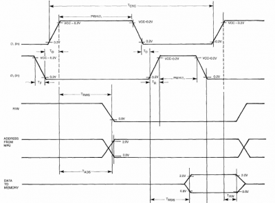

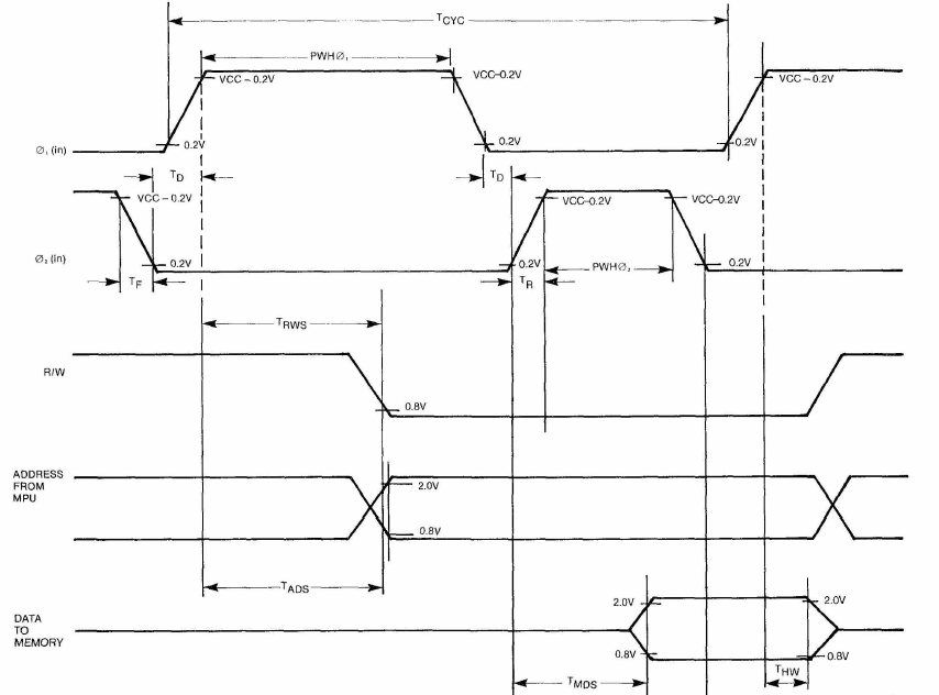

Continuing, I just want to make sure I'm clear on this: "first phase" is Φ0 and Φ2 low, right?
I was reacting to this:
because it implies some linkage between the rise of the clock and the change of the address lines.
Well, there is an explicit linkage, is there not? If you follow all the timing calculations transitively, you come up with the conclusion that the address lines must be valid before Φ0 rises, and thus you can (and should?) use Φ0 rise as a signal that address bus value is stable and you should read it then. Or am I getting confused here about how we build systems?
I was not meaning to say that Φ0 rising causes the address lines to do anything, and I am unclear about how my statement could be interpreted that way, since if the address lines become valid before the Φ0 rising edge, that rising edge clearly can't have caused the event that preceded it. (But I welcome comments on where I might have phrased things poorly.)
If we imagine a 6502 running at rather a fast clock rate and with rather heavily loaded address lines, I think we will see the address lines settling as late as we like, without relation to the rising edge of the clock.
Wouldn't that be a broken system, then, if you can no longer use the rising edge of Φ0 (or Φ2) to determine that what's on the address bus is now valid (and therefore it's now, e.g., safe to assert a RAM's write signal)? Could such a thing happen if you're obeying all the timing restrictions in the data sheet and not doing things that would cause bus contention?
My belief is that the rising edge is a convenient, but not a definitive, timing marker...
This is where I'm really confused. If we don't have a definitive timing marker for when the address lines are valid (and can then, e.g., assert a RAM's write signal), how can we have reliably working systems?
...the data bus, which is indeed driven by the CPU only during the second phase of the cycle (and of course only during a write.)...If you arrange some other device to access memory during this phase, you'll find you can, because the CPU is not driving.
I think you by "this phase" you actually meant the other phase, Φ2 low instead of Φ2 high, right?
Looking around at the diagrams, only the one from the 6510 (1982) data sheet gives me much clarity on this, and seems to indicate that A) it will definitely start being driven sometime before the Φ2 falling edge, and B) it will stop being driven some time after the Φ1 rising edge that follows the Φ2 falling edge.
I get conclusion A) from T-MDS (data setup time) being max 200 ms. (at 1 MHz) from the start of the Φ2 rising edge, which is well under the 470 ms. minimum of PWHΦ2 alone even before you add in the length of time it takes the edge to rise (T-R). I get conclusion B) from T-HW (data hold time–write) being a minimum of 10 ns after the Φ1 finishes rising, which is no earlier than when Φ2 finishes falling.
After the end of the write, bus capacitance will hold the data for a surprisingly long time when nothing is driving the bus
Well, I knew that, but it just now finally sunk in that of course I'm seeing the results of this in my captures above: while I can tell when something starts to drive the data bus, I can't tell when it stops because the data bus won't change much, if at all, when that happens. (Though there is an interesting little "bump" in the zoom of DB0 0→1 increment capture just after the Φ2 falling edge where the D0 level actually increases slightly (a fraction of a volt) for some reason at just the time when you would expect the CPU to stop driving it.)
At any rate, if my above timing analysis is correct, and a correct summary is "on writes the data bus will start being driven sometime after Φ2↑ and well before Φ2↓, and will stop being driven very shortly after Φ2↓," then I think I'm good with this part.
And then, getting back to the original topic of this discussion, I think we can also conclude that, given the relatively huge amount of time between data setup finishing and Φ2 falling, the Φ0 falling edge should also always be perfectly fine for indicating that data on the data bus are driven and stable and so for that particular purpose it's always safe to use Φ0 instead of Φ2. The only way I can see that breaking is if there's some stupidly long delay between Φ0 and Φ2 which would probably mean a system terribly broken in many ways, right?
PostPosted: Thu Aug 26, 2021 8:37 am
Yes, sorry, my typo there: as the 6502 uses the databus during phi2 high, the free half for other purposes is the opposite, the first phase.
Jeff wrote up a very thorough treatment with animated diagrams here
https://laughtonelectronics.com/Arcana/ ... iming.html
and discussed here
viewtopic.php?f=4&t=2909
You are of course quite right that, for the older parts, you can add up the various maximum and minimum timings and conclude that phi2 is a good signal to use to declare that the address bus is stable, and this is often done. As I say, it's useful. But it's not definitive: in some systems one might have another clock which rises earlier and gives more time to a memory access. It would of course be necessary to derive that clock in a safe way, such as by using a much higher speed master clock to determine the edges.
In the more modern faster parts, it all gets more compressed, and the documentation is lacking. I think I've seen it said that the modern datasheet doesn't really give room for 14MHz operation of a system - but we're saved by the practical observation that we don't seem to see worst-case behaviour.
But to the original discussion, I'm all for a thorough analysis of phi0 vs phi2 and the pitfalls to be avoided.
In the same area as an undriven bus holding a value for a little while, hold time constraints are very important and often overlooked. And slightly behind those is the question of bus contention. Which is to say, commonly one frets about meeting the timing during an access - meeting setup times - but that's only part of the job, as the various devices see the clock fall and the control lines change but need their hold times to be met.
