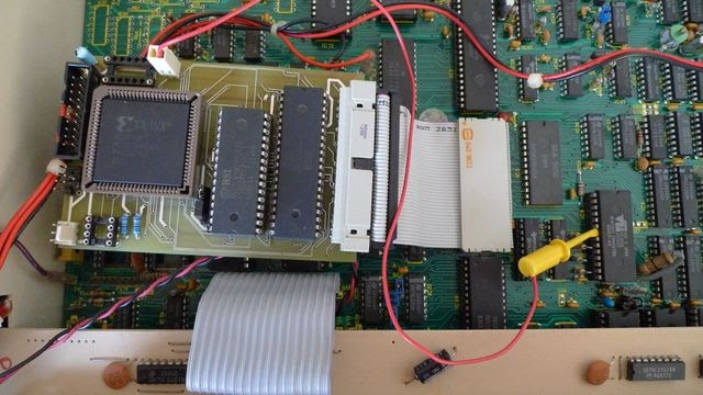

Here's a very early cut of the board:

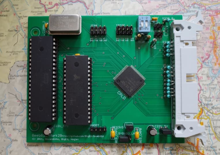

And here's the latest:
Beeb816 is a simple plug in board, with a real 65816 CPU, to accelerate and expand your Acorn BBC Micro (your Beeb). The Beeb has a socketed 6502, which is a good start. (The present board connects by a short 40 way cable to a header, just for our convenience.)

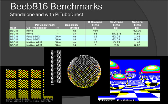

Here's a snapshot of a benchmarks slide:
As you see from the figures, Beeb816 is also a good match with fast second processors, such as PiTubeDirect and the Matchbox FPGA board: a faster host accelerates graphics operations, at least, and may accelerate filesystem I/O too, delivering even more responsiveness or more performance.

The board has gone through several revisions, presently at Mk2B. We expect at least one more revision, which might make for a smaller and lower profile board. Originally it was all through-hole and 5V, but availability of parts has pushed us towards some surface mount components and some 3V3 operation. (As a plus, the power consumption is now much lower.)
