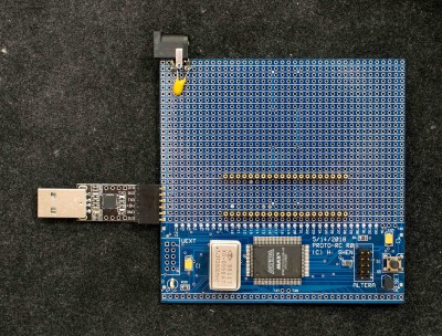

PostPosted: Sun Jul 18, 2021 1:46 am
Posts: 1064
Recent discussions about W65C816 have motivated me to look into it and see whether it can run reliably to VGA pixel clock of 25.275MHz. If so, a 65816 that accesses large graphic memory @25.275MHz may serve as a VGA graphic controller driving 640x480 color graphic. I've placed an order with Mouser for several W65C816, but I want to check out my overclock testbed before plugging in a part I have no experience with. I noticed W65C816 pin assignments are very similar to W65C02, presumably that allows W65C816 to plug into existing W65C02 hardware? So if I check out with a W65C02 first, I'm in much better position to check out the W65C816?
The test bed is a prototype board with a 128-macrocell CPLD, EPM7128S, similar to ATF1508 and an oscillator. https://www.retrobrewcomputers.org/doku ... mo:protorc I plan to wire in a 40-pin socket in the prototype area for 6502/65816. The test bed will consist of 65xx, CPLD, and socketed oscillator where CPLD will serve as a small but fast ROM plus a serial port to talk to the console.
Once I managed to get it to boot, I'm sure I'll have questions about how best to check out 65816 with 64-128 bytes of ROM-only code.

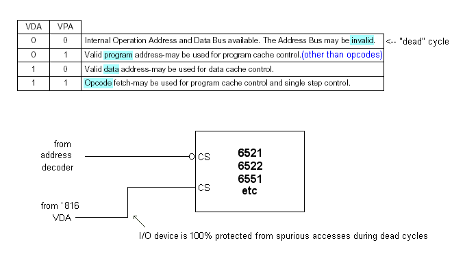

But! As for protecting memory from dummy cycles, one has to ask:
    Will a fully formed but unexpected read or write as described above cause trouble with the memory I'm using?
If you trust yourself enough to answer no then you'll be comfortable ignoring WDC's inexplicable inclusion of the word memory in that sentence.

Exactly. That's why it usually makes sense to only protect I/O. As a starting point, at least, one looks for the scheme that's simplest. And if the simplest solution also happens to be fastest then it's unlikely (although not impossible) that other priorities will sway your decision.
Referring to the diagram and Truth Table below, it's easy to see that the I/O device is enabled during data accesses but disabled during dead cycles, and that's all we require. Dunno what sort of I/O you're planning -- maybe it's not a 6522, for example. But if you have or can contrive an extra active-high Enable input then you're home and dry! Notice there's no need to inject VPA anywhere, neither in the glue for memory nor the glue for I/O.

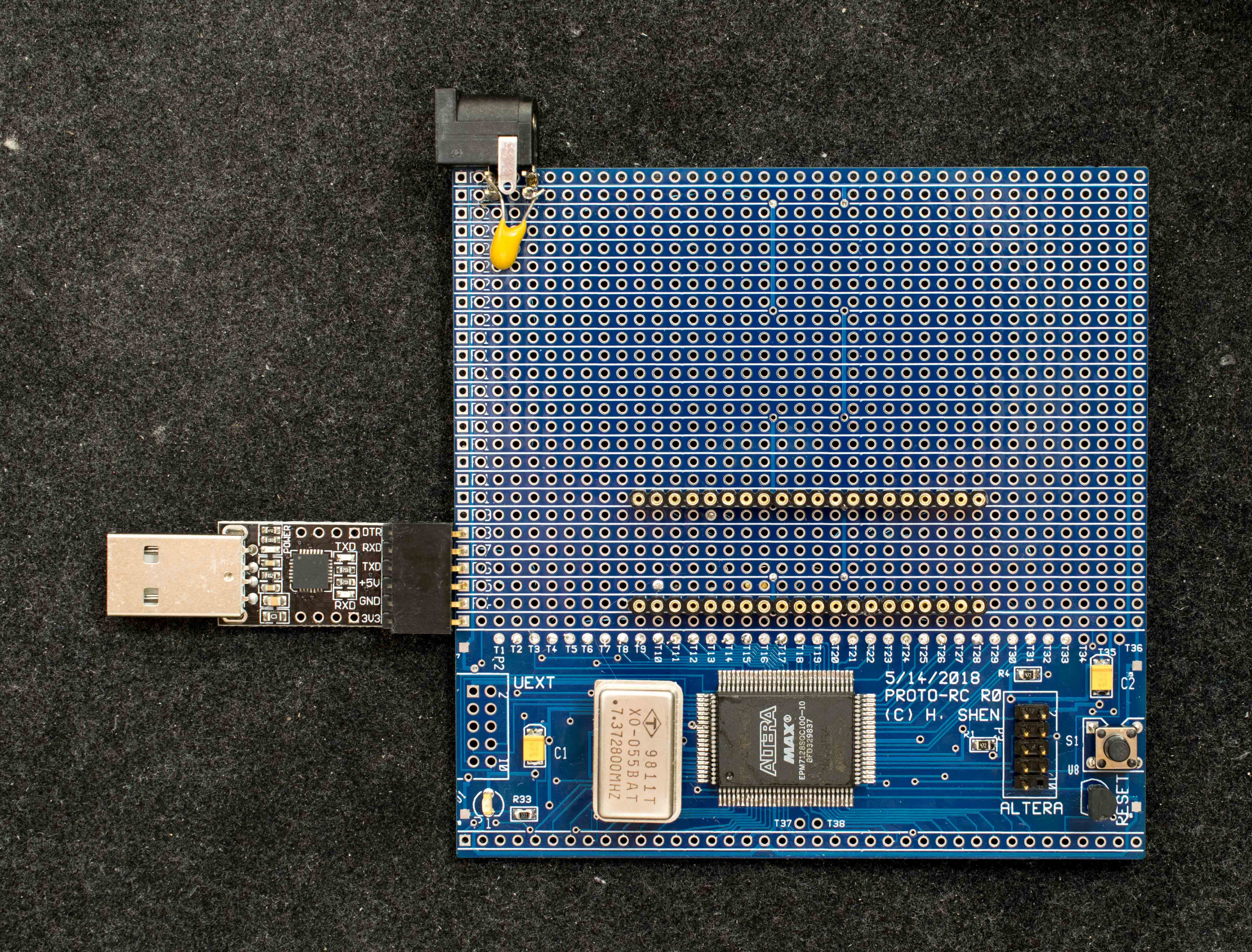

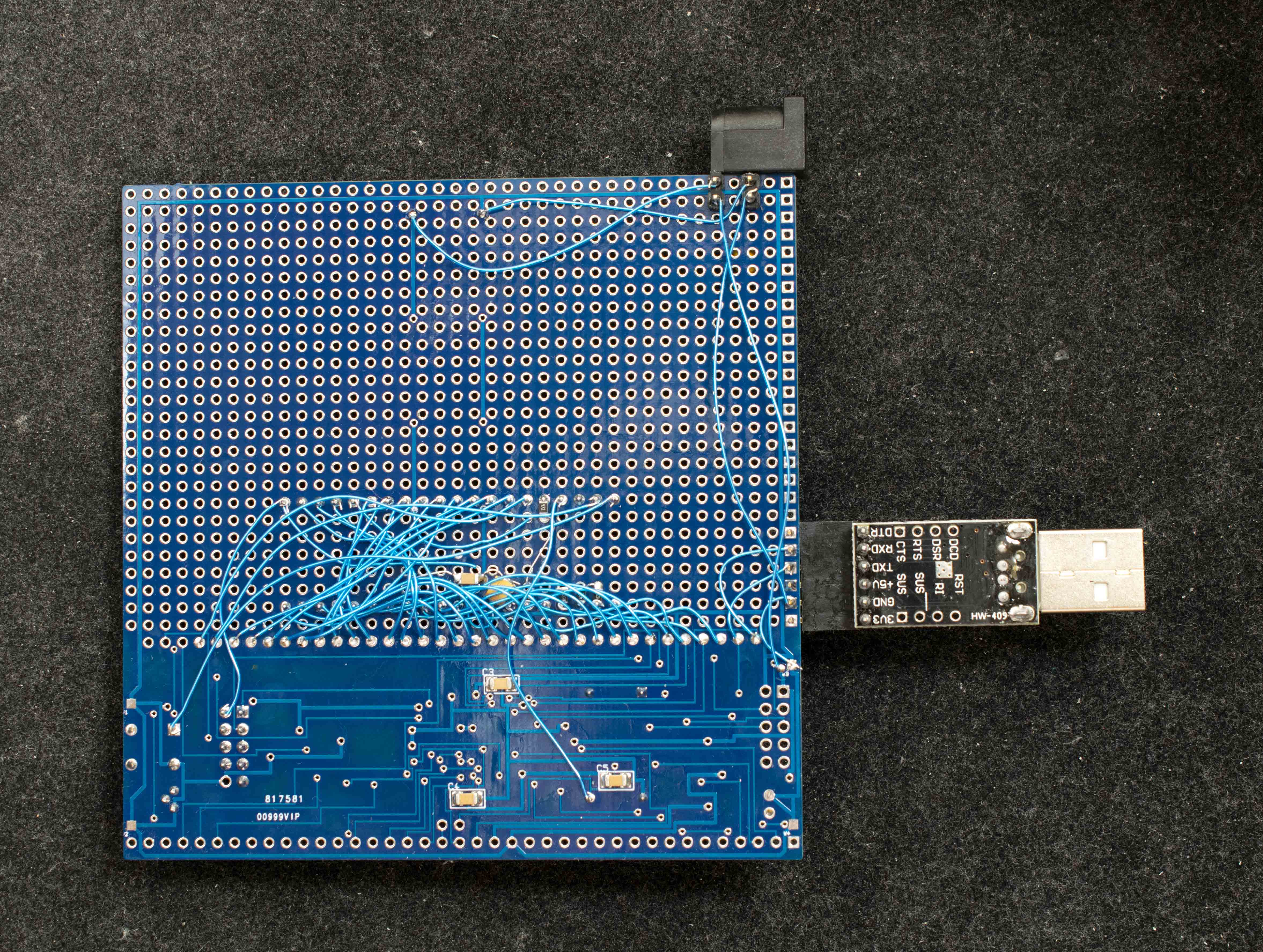

I'm done for the night. This is where I am tonight. The wiring is finished. I have powered it up without the 6502 and able to program the CPLD. I had a working serial port design that I successfully ported to this CPLD. I'm able to get the serial transmitter to spit out data continuously by periodically jamming a byte into the serial transmit buffer. Tomorrow I'll write a 6502 ROM program for the CPLD and try to boot up a real 6502.
